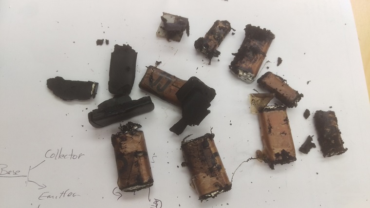

My plan is to start working through the bakelite caps now.  I plan to do them one at a time and test function (worried about making a mistake that will be hard to trace...).
Is there a logical sequence to replace the bakelite caps?
I have (edited with values found)
#7  3615-AJ  .05  .05  (Will use two .047uf 600V orange drops)
#27 8035-B  .00011 .00011 (Will use two 100pf 500V Silver Mica)
#30 3903-AP .01 (Will use .010uf 600V orange drop)
#33 8035-D .00011 .015 (will use 100pf 500V silver mica and .015uf 600V orange drop)
#49 3793-W .015 (will use .015uf 600V orange drop)
From Philcorepairbench I have found the parts list for all except 8035-B and 3793-W.  Is there a better list to discover whats inside these?
Also, are there other capacitors besides the bakelites that I should replace?

I just finished up replacing all of the capacitors in the bake lite housings.  3903-AP did not make sense, it's replacement part is 3903-OSU which is a .01 uf between pins 1&3.  My 3903-AP clearly had the capacitor between pins 1&2 so that is how I wired the replacement.
I must have done something wrong.  The radio powers up, all tubes glow and there is a soft hum coming from the speaker.  The volume and the tuner dial effect nothing, hum remains constant.
While working on condensor 7 (3615-AJ) I must have broken the solder joint to the resistor leading to condensor 30, easy fix and every other connection appears good.
Any suggestions on areas to start troubleshooting?  I'm good with a multimeter, decent with schematics and fair/poor with radio theory...
Thanks for any help,
Matt
Check pm box.
Terry (radioroslyn) is not only exceptional at troubleshooting these radios, but a very patient man for putting up with me!
He rather quickly led me to a problem in the #33 bake lite condensor that was sending 160v to the control grid.  Turns out that I shorted the legs of the two capacitors inside the bake lite  Icon_sick
