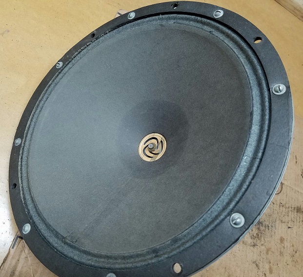

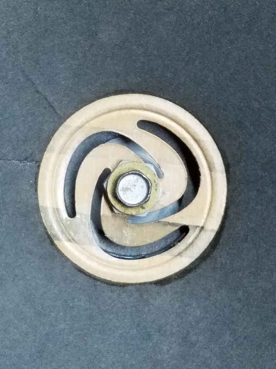

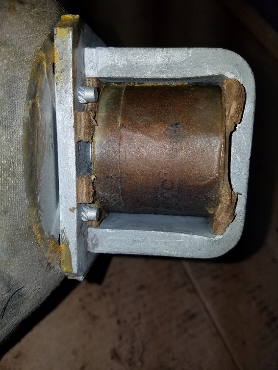

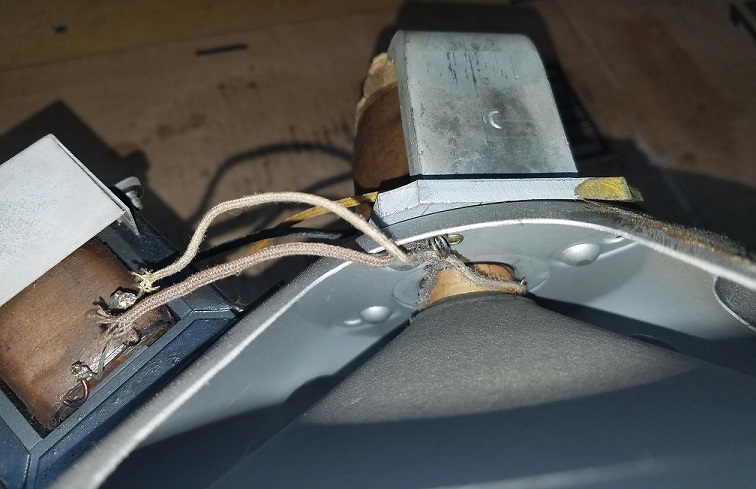

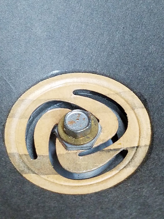

Speaking of speakers... the speaker on my model 16 has a bad rattle anything over a 1/4 volume.  It plays fine at low volume but once you get past 1/4 turn on the volume control, it rattles and distorts the sound.
I don't see any visible damage that could be causing it. The web in the center looks intact without cracks and is pliable.
Can anyone tell me what could be the cause of this and walk me through what I need to do to fix it?
