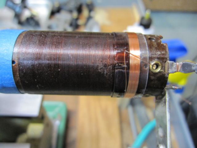

I have the primary winding and insulation strip removed from the antenna coil. What is the best way to clean off the residue/glue/wax off the coil in preparation for the new without damaging the enamel of the secondary?

(11-11-2016, 07:13 PM)Mike L Wrote:  I have the primary winding and insulation strip removed from the antenna coil. What is the best way to clean off the residue/glue/wax off the coil in preparation for the new without damaging the enamel of the secondary?
Don't believe there's any glue there pretty much just wax. I just use a heat gun to gently warm it up and wipe off the excess wax with a dry rag.

Well...I have the first coil wound. Measures out at 2.5 ohms. There were 21 turns on the old primary, so that's what I put on this one. The biggest problem was getting the insulating strip to stay in place and not open up on the ends. Not the prettiest job, but the first. Another coat of lacquer and on to the oscillator coil.
#35
Looks good and sure it will work fine.
#36
Nice job mike
#37
Thanks. One thing that I did that may be helpful to others. My eyes are not what they were when I was 20 or even 40 (closer to 60 now) for that matter. in determining the number of turns needed, I tried the pin trick but sometimes it would skip over and not feel a "bump". So, by accident in taking the as found photos I realized I could zoom in the photo on my computer and clearly count each coil. I did this too on the coil after winding as well to make sure I didn't miss count. I picked the same spot in both before and after, right where the coil starts and square to the area of interest. Not sure if a cell phone camera would work as my digital camera has a macro setting which I really like for things like this.
