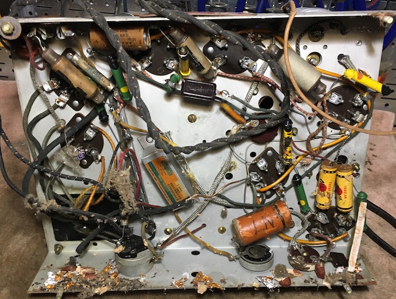

Was that just dust or mold also?
Both, Lots of buildup but it began to grow on it's own, Icon_lol
