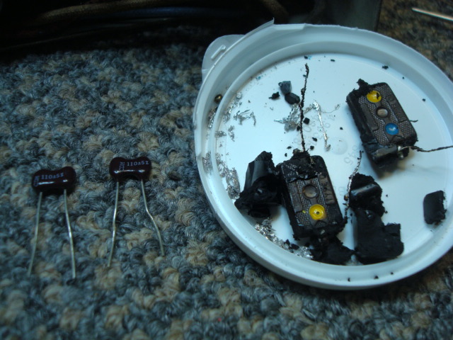

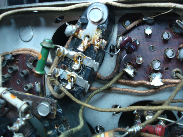

It is very difficult to pick up a project like this after a couple of years.  I had to spend some time studying and looking at my notes,, pictures and such. Thank goodness for my notes and digital camera! I am still working on the bakelite blocks. I got the #32 with the 110pf caps rebuilt. I was told earlier that these were paper caps and should be replaced. I also replaced #43, which is also a 110pf cap, and looked just like the ones I dug out of the block. Interruptions have been very bad lately it has been hard to sit for more than 10-15 minutes without someone calling or coming in.

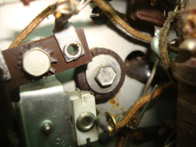

I need to find some washer/spacers that are bad on this tuner. I could search and spend a bunch of time looking, but I bet someone here can point me to where I can get some of these. Hardware stores don't have much. Help appreciated please.
Tim

Look here Tim. There down a ways on the list
http://www.renovatedradios.com/parts.html
Or you might find something at a hardware store. I like the ones I bought from here.
Look like regular mica caps. Wonder if in other blocks 110pF caps are indeed paper.

I had one that was paper but it was so long ago I don't remember what Philco radio it was in.
