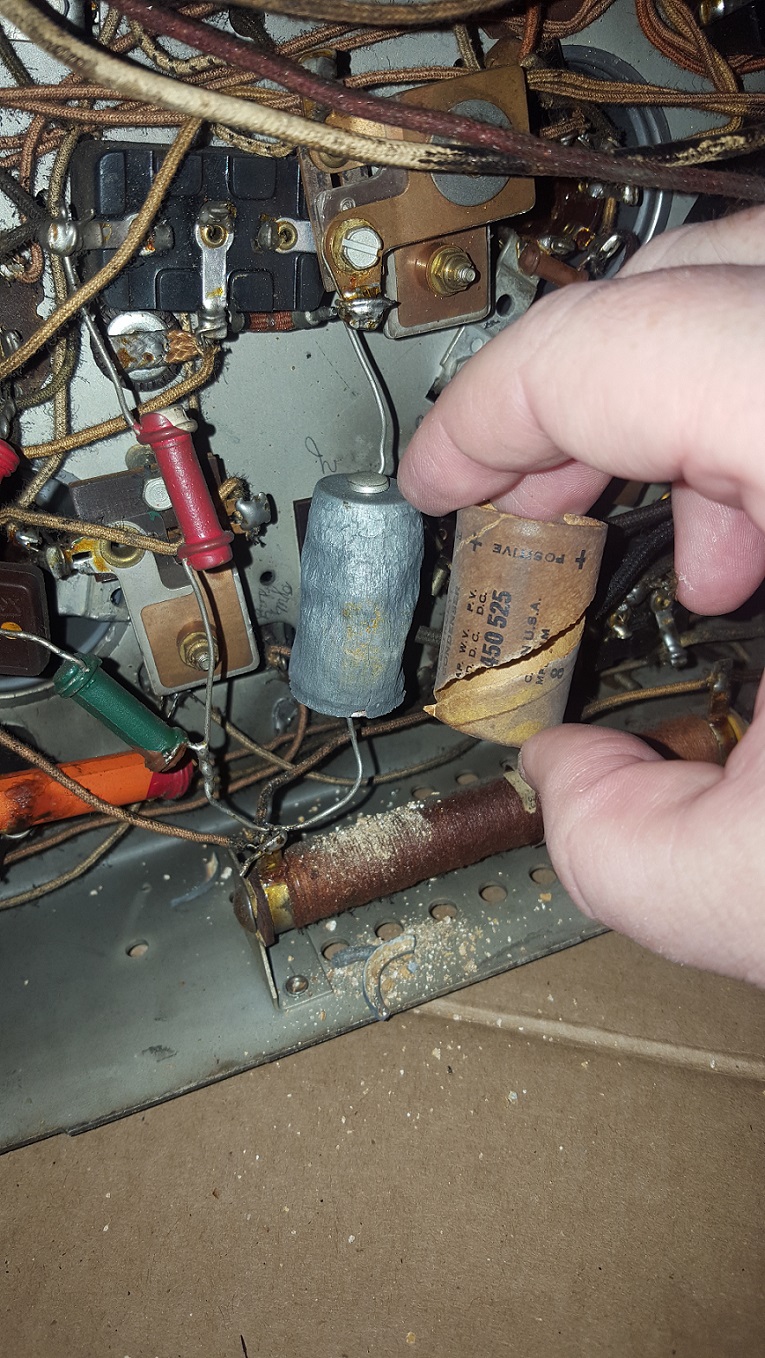

Lastly I stated before there may have been repairs at some time in the past. I located an 8uF 450V electrolytic capacitor that is not on the schematic.(Photo below) I don't know what the purpose was, but it's connected to the compensating condenser and the large wire-wound resistor. As the Cap is pretty ancient, is this something I should replace? Omit?
