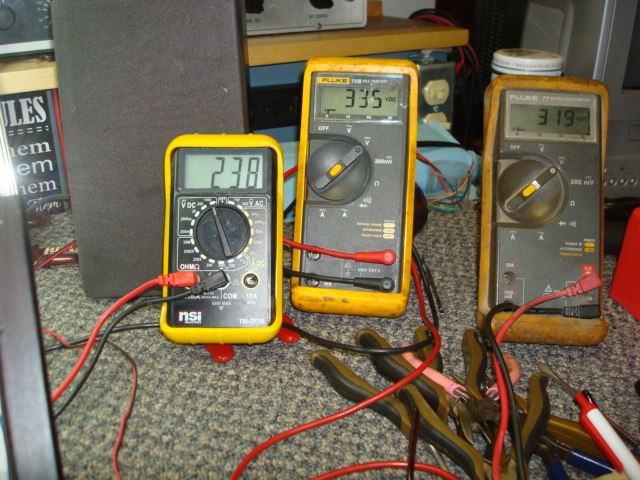

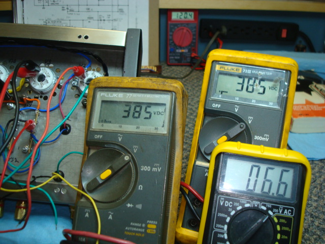

I did an initial power up to make sure I had the power transformer connected properly, and to be sure it was labeled correctly. I didn't want to get everything together to find the 600v was across a filament or something like that. Also to make sure voltage was passing through the choke and output transformers. I did an AC test with all the tubes out, brought up on the variac slowly. I checked the B+, and all of the filament voltages and connections. Next, I plugged in the 5Z4 to check for raw B+. Finally, I plugged in all of the tubes. I have one meter on the B+ coming from the choke, one on the plate of a 6L6, and one on the filament of a 6SN7.
So far, things look good Icon_biggrin
Tim
Well it shows no load Icon_smile
Well, no smoke anyway Icon_biggrin
Tim
No load - no smoke. Maybe we should keep it that way! Icon_lol

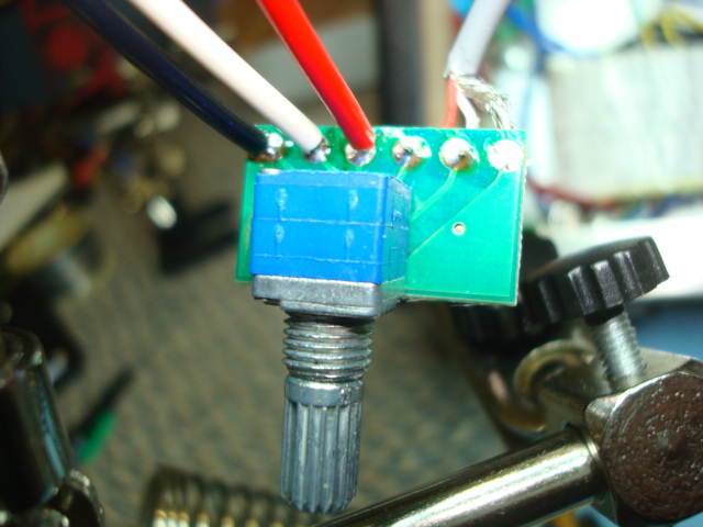

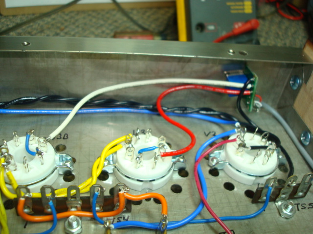

With all the lousy weather, and some sleep, I found some time to advance on the kit. I worked on the "signal wiring" part. I had a PC board to mount the level control on, then had to figure out the combination. I thought I had it documented fairly well, but still had to make some corrections. Took a couple try's to get all the wires pointed in the correct direction, and make everything line up. I think I finally succeeded. This resembled a Chinese jigsaw puzzle Icon_e_wink
Here is the rest of the signal wiring. This part was very straightforward and went smoothly. Looks like this circuit uses several different feedback loops. I didn't have enough shielded cable to go from the level control board to the tube terminal. But, according to the pic I have, they just ran a single wire to each tube, so that's what I did.

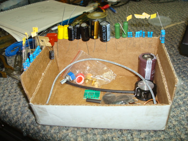

I found an idea in an old Heath assembly manual to help organize and layout parts for installation. So, I utilized the idea.

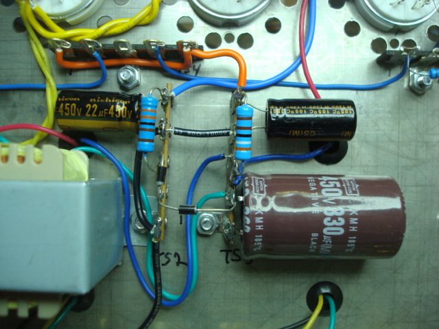

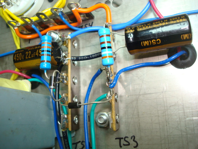

I started in building the power supply. I found that separating the sections - that is, caps in one section, then resistors, etc - well, that didn't prove out, so I had to revamp. I made a lot of notes and changed the order of the steps to aid in assembly.

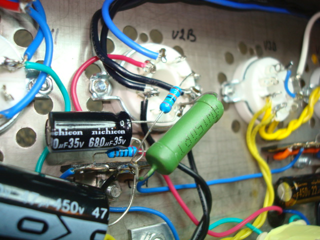

One thing I did was replace their supplied 47mfd 450v cap with a big burly 47mfd axial cap that fit better. This was is the input filter cap, so I figure the bigger the better. I think the rest on down will be ok. I tried to lay things out in such a way that it will be fairly easy to replace when the time comes.

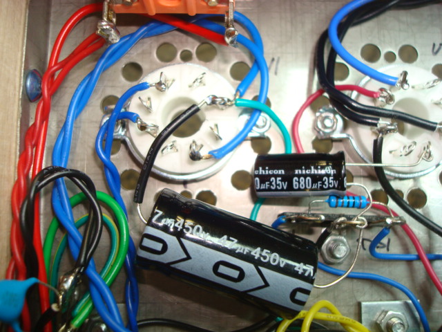

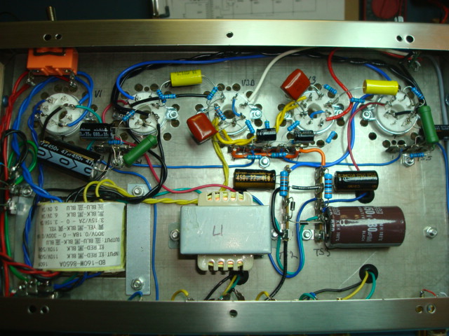

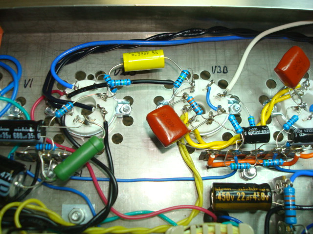

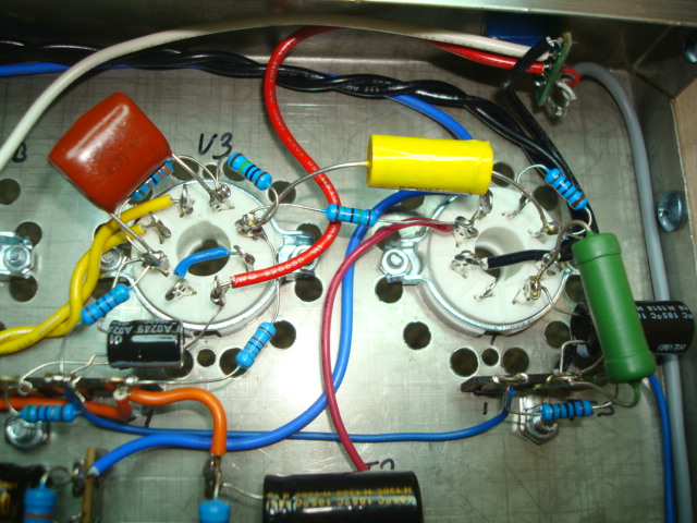

Well I advanced a little more. I got the components put in the left channel. I had to "re-order" almost all of my steps in this section. Here are a few pics of how things turned out:
I started on the right channel. This one was a little more interesting due to a few minor parts routing issues. It took some thinking and trial and error, but I think it is turning out. It's kind of funny to be writing my "instructions" while I build the kit, but I bet that's what Heath and Knight did when setting up their kits. It has been challenging. Icon_razz
Tim
Looking good so far, Tim. Good assembly.
Great work. May want to consider using some RTV to bond the large electrolytics in the power supply to the chassis. If the were axial like the old days then they would be hung between two terminal strips for support.
A lot of weight to bounce and vibration around I would think.

Thanks guys! I did stick the big cap with some hot glue, but probably should stick the other bigger ones before I close it up. I took some time and did some resistance checks from each tube to chassis ground and documented my readings. I didn't see anything unusual. I double checked all my component and wiring hook up. Checked ok.

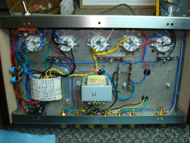

Below is a picture of the completed chassis at this point.

Naturally, I  wanted to flip the switch and see what happened. Icon_twisted Ok, maybe 30 years ago, but I followed my instincts, and brought it up slowly on the variac. I had meters plugged into that thing about everywhere. When I got her up to 120v, all the voltages looked right. They had some key voltages on the schematic taken at line voltage of 110v. They checked dead on. No signs of overheating, no funny smells. No fireworks.
I took the time to document all the voltages for each tube. Thought that may help for future troubleshooting.
