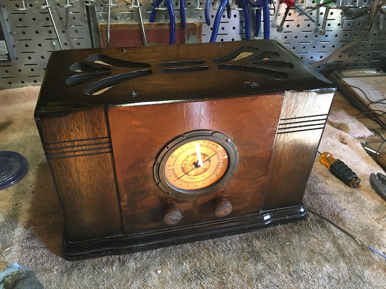

The Detrola 140 is DONE!
The hack job with the ballast tube has been undone and thanks to someone, It is fully restored electronically now!
It plays real well and I even got China on the Foreign band... Or at least they were talking in Chinese, Icon_lol
Cabinet will be a project and will have to wait till spring...

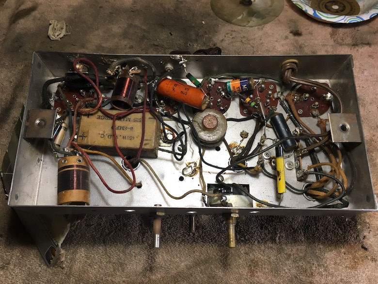

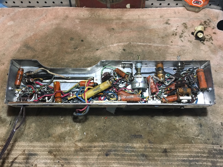

Are you too scared to show us how the underchassis looks? Icon_lol
#34
Haha,
 I only have one before putting in the diode and resistor....
#35
Not too bad.
Oh, I see your electrocution counter has been incremented Icon_smile
careful there!

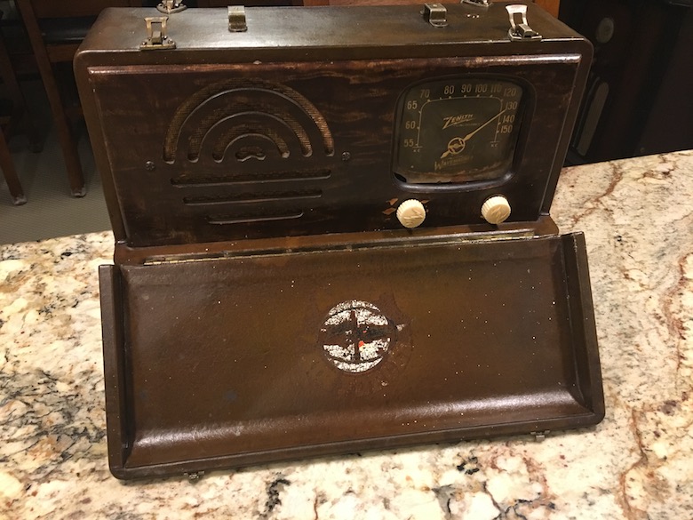

I jumped into that Zenith 5G500 that was supposedly dead. within 20 seconds I found the problem. The butthead who tried putting the new line cord on, soldered the 2 wires so poorly that they didn't stick to the terminals. They much have touched because it blew out the 117Z6. I recapped it but there was a lot of rubber wiring so I did that too.
She is playing real nice now... I just need the handle to arrive from oldtymeradio.com...

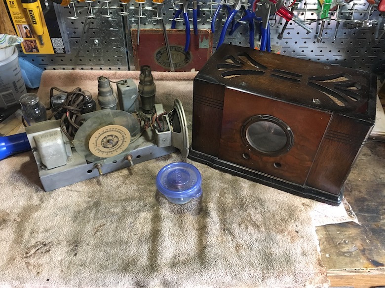

Continuing on from the above post...
 I had extra energy this morning and pulled out my Tiffany-Tone mantle set.
IT was a pretty easy recap but speaker removal and putting it back in was a true PITB!
She will be displayed on the main floor...

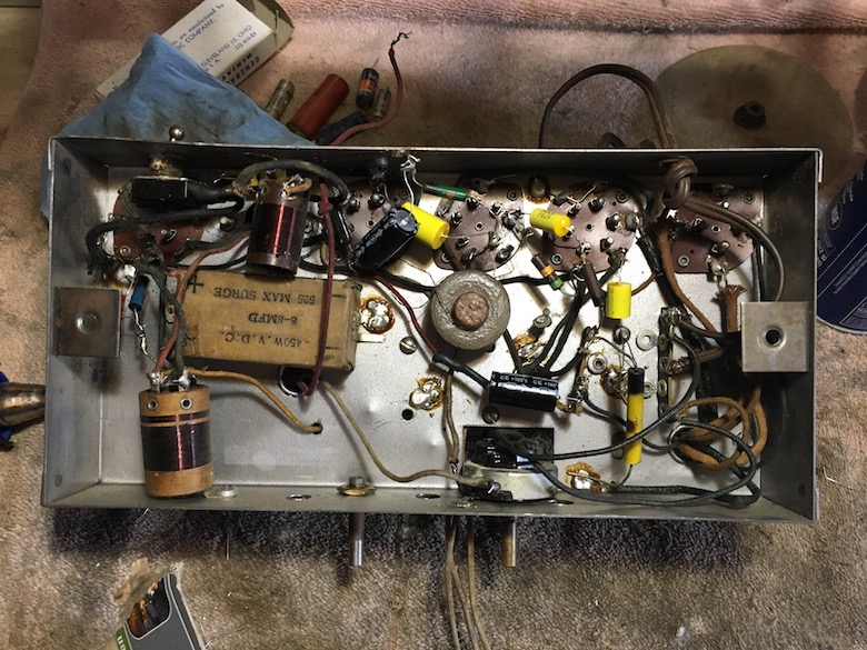

looking good kirk Icon_clap Icon_clap
but why the extra cap in the tiffany ?
#39
What extra cap?
#40
the one behind switch
#41
Oh, Thats the other Electrolytic.
The Ecap box was 8 and 8. I just moved them to tighter locations since I did not re-stuff the box.
Icon_smile
