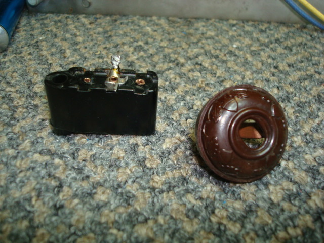

I have been using an ultrasonic cleaner for several years to clean up the tuning capacitors, tube shields, and other metal parts. I use Simple Green diluted with warm water. My Harbor Freight cleaner has a heating element which I use. I was able to get the large tuning cap from my Philco 95 into the cleaner with several shots to clean the entire tuner. I just leave it in as many cycles as required to get them clean. You do have to watch the heating element to prevent it from getting too hot, though.
I, just recently, started using it to clean up the Bakelite blocks. After removing most of the potting wax/tar with a screw driver, I place them in the cleaner with the same solution of Simple Green and water and run till clean. It will remove all the left over potting from the terminals and rivets for making a clean solder connection. Works great!
