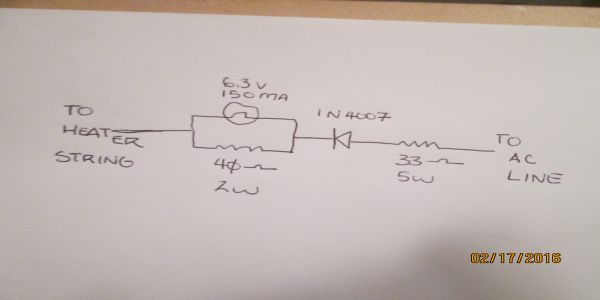

So R-14= 133 ohms @ 25w  & a 40 ohm resistor in parallel with the lamp so it will equal 300ma. R-14 will get very hot and is pretty big too.
Or this:
If it were me, I would probably go with the capacitive dropper, higher value non polarized capacitors are smaller, cheaper, and easier to find then they used to be. However you will still need a resistor to parallel with the pilot lamp.
Arran, Ok What would that circuit look like?
Skip...
Same as mine but remove the diode and 33 ohm resistor. In it's place add a 8.5 uf non polarized cap at 250wv.
Terry, OK thanks.. in your opinion what would be the best one to use.
Skip...
Doesn't matter much. Both do the same thing. My thinking is that you may have the two resistors and can wire it up pretty quickly. The capaciitive dropper you got to order and wait for the part to come in. Resistive dropper will generate a little heat (a lot less than a flaming hot BL42 tube) vs the cap won't. The 33ohm resistor you can play w/the value a bit something like 25-40 ohms will work. Either one you can wire up into an old octal socket to make in plug in like the original.
