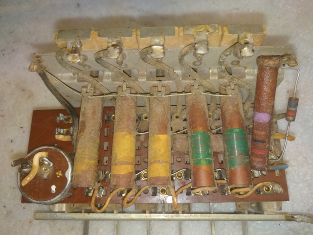

So here's my first question...yesterday I removed the pushbutton assembly and it's filthy.  What's the best way to clean this up?

I would use cotton swab, dip it in 91% or stronger (no water) isopropanol, clean the board and the switches, and then try one coil to see if it does not dissolve what it souldn't, and then if it is OK, proceed with it. No soaking, just wiping with alcohol-wetted swabs.
Also, be careful around the phono switch and push rod on the left. That switchconnection will be very delicate and if it was used a lot, may be worn and bend easily.
I think morzh is right, I cleaned mine with alcohol, it didn't seem to hurt anything but be careful those wires are very small.

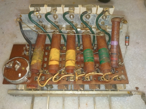

Thanks for the input morzh, shaler78, and Warren.  I took morzh's advice and tried with some alcohol.  I don't have any 91%...I used 70%.  You can see a huge improvement already:

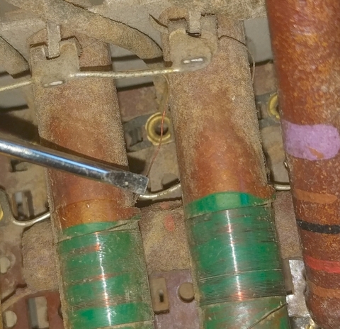

I know what you mean Warren...some of those wires are VERY thin.  At first I thought this one was some lint or something...glad I didn't try too hard to remove it!  Old eyes suck!
I intend to clean everything once, then take it out to the garage and gently blow it out with some compressed air, then do everything again.
Can I spray contact cleaner on the switch contacts as long as I'm careful where I'm spraying?
Rich
I think I'm going to call the pushbutton assembly good for now.  It's not as clean as I'd like it to be but it's far better than it was.  I figure the more I mess with it the more likely it is that I'll cause some sort of damage that would be difficult or impossible to correct.

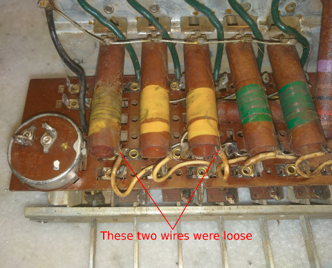

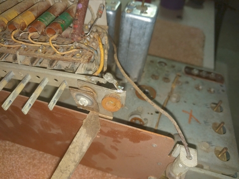

Actually, there's already some damage.  I don't think I caused it but it's possible.  The two wires marked in the following image were loose on the ends of the inductors.  I touched them with a little solder and they now seem attached, but still don't look right.

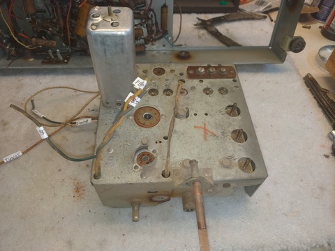

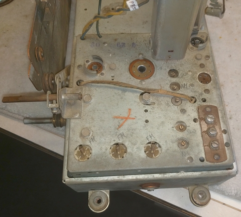

Ok...today I marked all the wires connecting the tuner sub-chassis to the main chassis and removed it, along with the dial backing plate and dial cord.

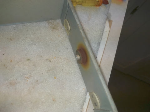

Warren - Did you replace the rubber grommets mounting the tuner sub-chassis to the main chassis as well as the ones for mounting the pushbutton assembly?  If so, where did you get them?  I've seen some that may be close enough here   http://www.renovatedradios.com/parts.html#rubber  but haven't seen anything that's exact.
Thanks!
Rich
Hi Rich, No, I did not replace mine they were in decent condition so left them alone. If they are not falling apart and still semi pliable I would not replace them myself. I you can compress them and they go back in shape they are probably good. If you want to replace I have heard you can find "O" rings sometimes at home depot that are close enough. Also, if you cant find any you think is close enough I might have some on the donor chassis I have but of course those would be older used ones too. But if yours are falling apart these are probably in better condition.
(03-23-2017, 01:54 PM)Warren Wrote:  Hi Rich, No, I did not replace mine they were in decent condition so left them alone. If they are not falling apart and still semi pliable I would not replace them myself. I you can compress them and they go back in shape they are probably good. If you want to replace I have heard you can find "O" rings sometimes at home depot that are close enough. Also, if you cant find any you think is close enough I might have some on the donor chassis I have but of course those would be older used ones too. But if yours are falling apart these are probably in better condition.
Thanks Warren - my tuner chassis grommets aren't too bad and I might re-use them.  A couple of the ones for the pushbutton assembly aren't too good but I think there is one at renovatedradios.com that's real close so might try that.

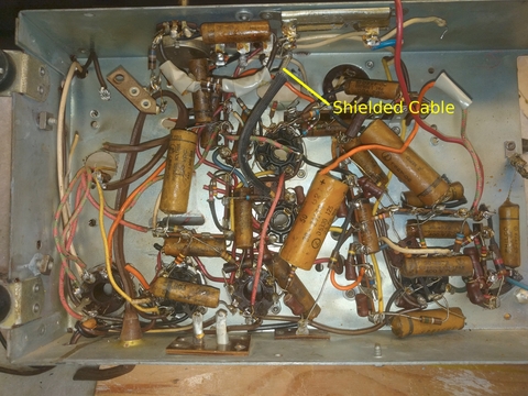

I'm also considering replacing the shielded cable that runs from pin 3 of the 7X7 tube to the .006uF cap attached to the wiper on the volume control.  I suspect this is just plain old shielded cable, right?  Or does it need to be some specific impedance?

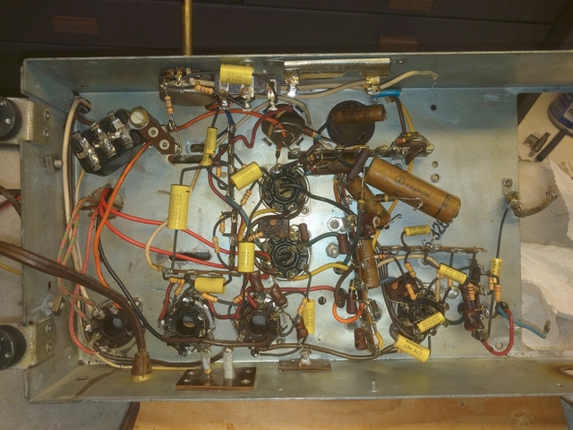

I'm making good progress with the cap replacement.
Actually, I should call it cap/resistor replacement.  It looks like I will end up replacing all but one resistor on the main chassis.  There is one attached to the volume control that would be a little tricky to get to and it measures in tolerance so I'll probably leave it.  On the tuner sub-chassis I'll probably leave them alone unless I come across one that's out of tolerance and relatively easy to get to.

Shielded cables in this particular case do not have to be of particular impedance.
Impedance only matters when your transmission length becomes comparable or especially when it exceeds the wavelength at which point it is considered a resistor equal to the characteristic impedance as seen by the source; otherwise your cable acts as lumped capacitance/inductance as seen by the source, and your shield is there exactly for that - to provide shielding.

Thanks morzh!  I decided this was probably the case and bought some of this from Digi-Key:  https://www.digikey.com/product-detail/e...ND/5270188
