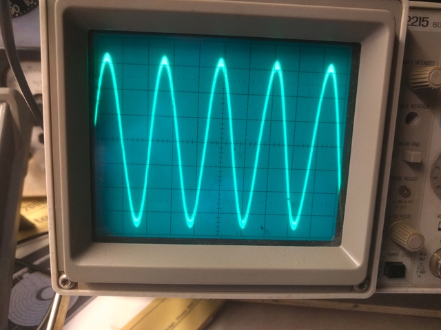

I'm still in need of some guidance on this.  Here is some more info in case someone can help me out.  This all pertains to the AM band, but I get nothing on short wave or FM either.
The AM oscillator is running.  Here is a scope image (10v/div):

Have you checked the frequency of the oscillator? You can figure it it out by the settings of your scope time base     (uSec/ div), or by placing a portable radio close by and tuning it 455 kHz above the Philco dial setting.
If you set the Philco to 1000 kHz, you should hear the osc signal at 1455 kHz on the portable.

There was one more thing I forgot in my previous post.  In the troubleshooting tests in the info Chuck sent me there is an oscillator test.  In it, they say to connect a voltmeter between pins 1 and 4 of the 7F8 (refer to the schematic posted above) with the positive lead on pin 4.  It says you should read about -3v.  When I do that I get +4v.  When I measure from pin 4 to the chassis, I get 0v.  When I measure from pin 1 to the chassis, I get -4v.
What do my results mean? The attached instructions are for the FM tests, but the AM oscillator test is identical.
