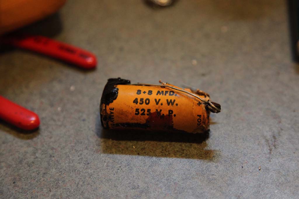

Upon having opened an electrolytic can this is what I found:
So they essentially took the same axial cardboard shell caps and encased them in aluminum shell.
Hmmmmmmmm.....
The internal cap also says "8+8" (and it does have two sections) but the aluminum cap itself says "8uF" and was a single 8uF cap.

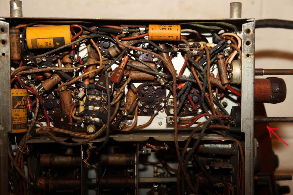

I overlooked a boxed capacitor assembly that is bolted with two screws through the main chassis with the nuts underneath; it is in front and directly to the left of the dial assembly when looking at it directly.
I just remembered now, same thing was in 37-116. But I cannot recall how and where I found the description of the contents, as it is not enumerated on the drawing, though is shown.
I tried looking into 37-116 docs- nothing, tried to look into my resto thread of it from 2013 (wow, has it been 4 years?) - nothing there either.
Anyone knows anything?

Found the answer about the rectangular bix cap assy. I found the 37-116 thread from 2013, found the place where I taljed about it, cap #89, and by analogy (I figured it should be in the same place as the sch is similar ) found it: cap #108, 0.1-0.1-0.7uF.
Will try to tackle this weekend.

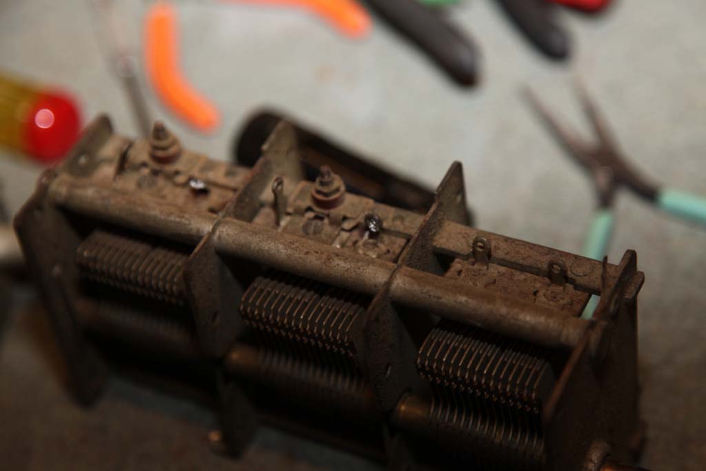

Oh yeah... the tuning cap is of, did I mention?

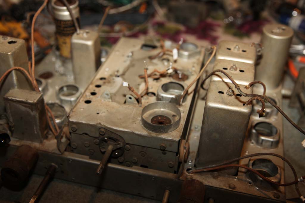

Someone tried to fit in a metal tube and did not find anything better to do than to cut the shield base off. Dumb!
Now I am confined to metal version.
There is another base that was simply mangled to make the metal base fit.
Some people!

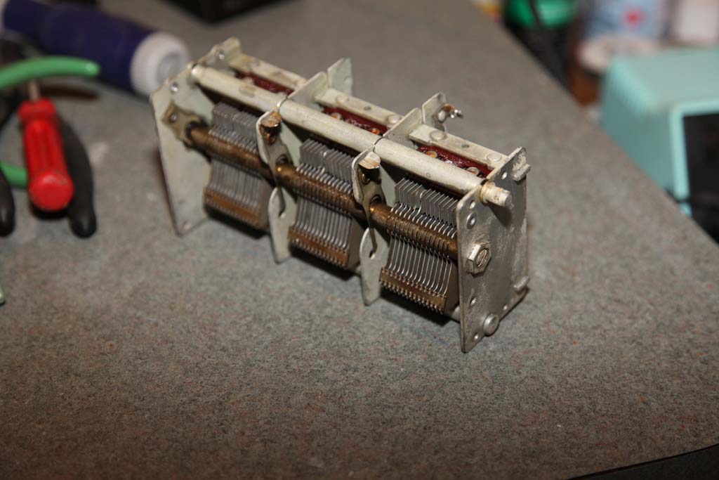

Cap cleaned up.

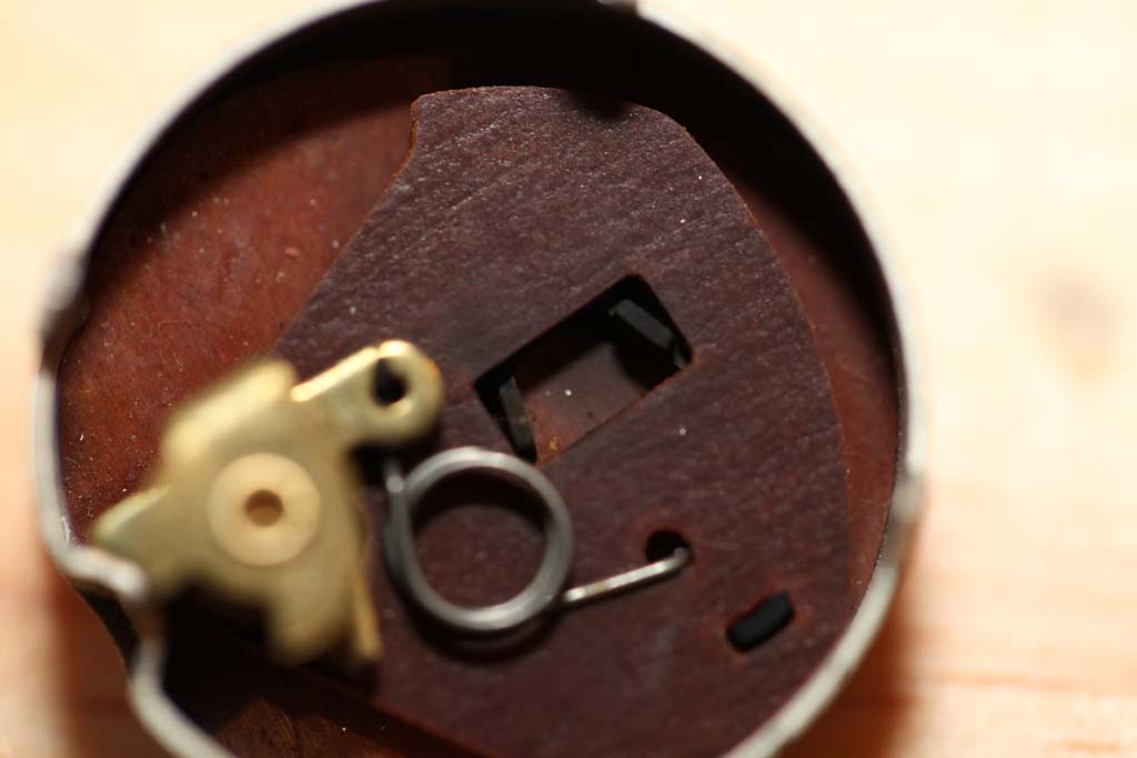

Oh, there is also the second switch, the one that lights up the scale / turns off automated frequeny control.
The switch has two parts, obviously, and the light part was frozen. Not sure why, though after looking at the innyrds I am not fond of that particular design. It was not exactly frozen but ....to long to explain, suffices it to say, it is working now.
The switch is riveted, I was barely able to pull it apart after drilling the flared part. And, assembled back, it was so snug that I only tapped a little with a setter just to make myself feel better, I am sure there was no serious effect from that.
That switch:

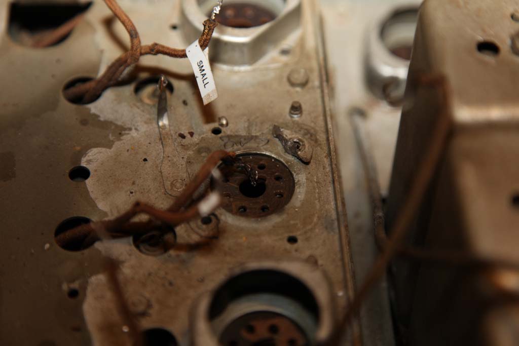

Well.
Decided to look at that panel. It is for 6A8 tube. The guy used one metal which would not fit through the base.
So he cut it off, having left small pieces riveted. I looked if he provided the grounding for the pin1.....sure'nuff, he didn't.
I worked aroubd it - I soldered a piece of multistrand wire to the piece of the base that was left, scraping it well and using the plumbers flux for copper pipes. The other end went in the hole for pin1. This is a good reliable GND.

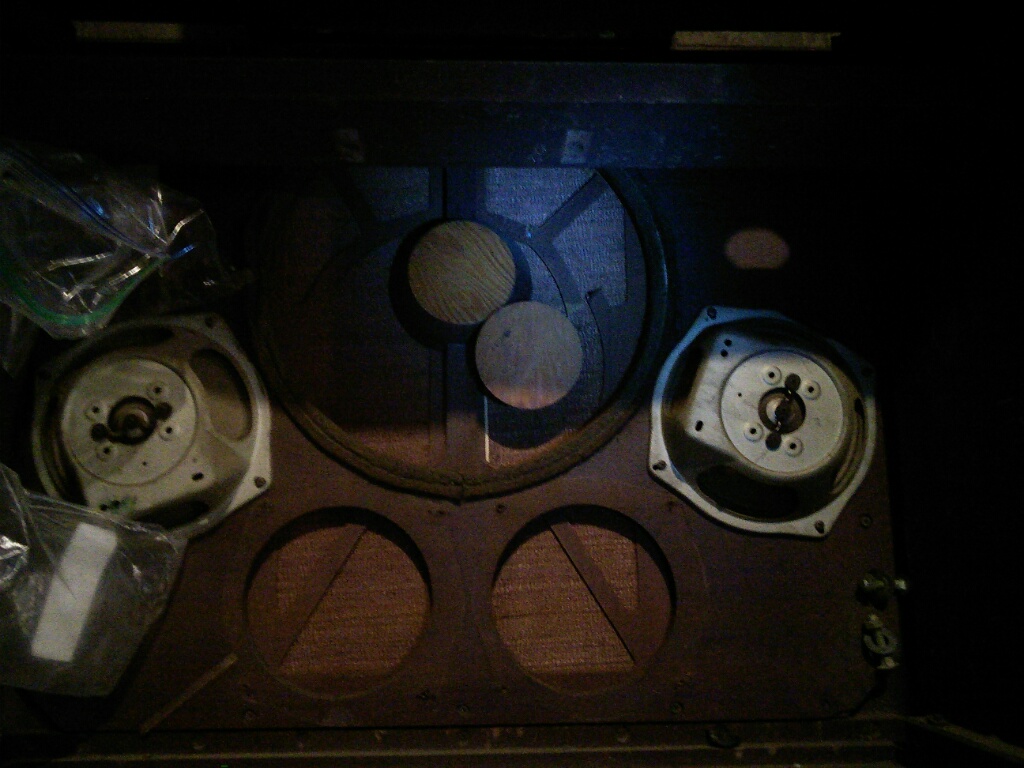

Tonight I thought to try to power up with rectifiers which requires the speakers connected.

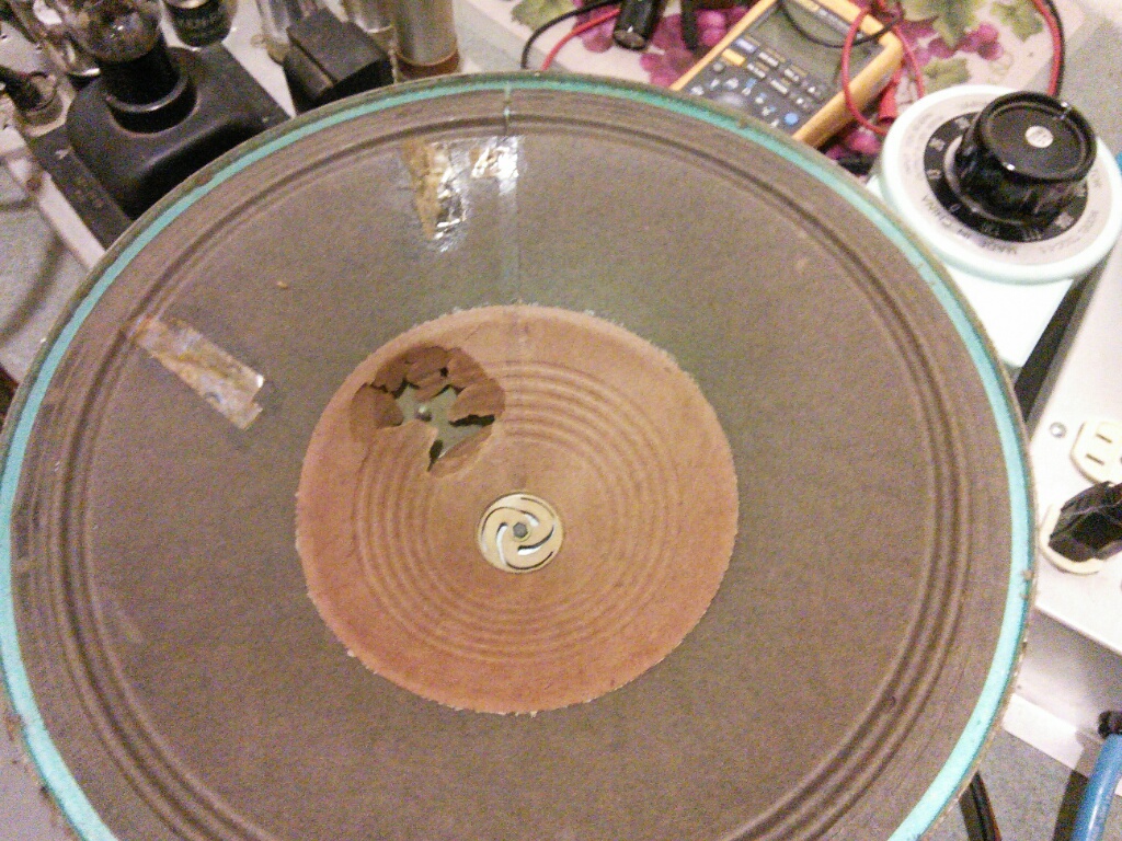

So I unbolted the large speaker (had to remove two clarifiers first) and saw this
Which caused that:
So.....I think, considering the value of the radio, warrants reconing. If they do recone this type.
But, I thought, why not try it anyway to see the functionality?
So first I went straight to check the output transformer. Sure enough. Opened primary all three wires. Then I saw the fuse. It was good but oxydized. I wiggled it, and one half of the primary conducted. The other did not.
But even that is weird: the half shows 1.4 kOhm while the sch says 200 Ohms each. The transformer is original.
So. Need to recone the speaker and the new output pushpull xfmr.
Will need to find out the speaker impedance to pick one.
Good news: the field coil is good.
This will delay me a month.
Sigh.....

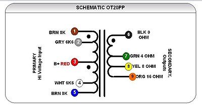

Just renembered. I have an OT20PP transformer.
It is almost ideal match.
Here's Ron's post from 2014.
32-7905
Primary impedance: 6000 ohms, center-tapped
Secondary impedance: 3.9 ohms
20 watts
This is 6600 ohms PP to 4 Ohms, 20W.
Bought ita couple of years ago on eBay. These are goid, I used one from the same fols for my Zenith 5 years ago.
