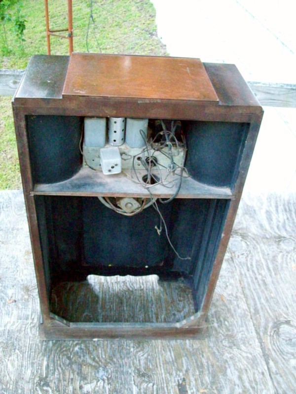

After over a week of trying to get schedules together, I finally picked up this rather small Zenith console this evening. The guy even met me halfway, saving me some miles and I actually got to try a Steak and Shake for the first time ever during the trip.  Overall, the radio seems to be in very good condition with a couple issues that need ironed out. The additional IF can someone added to the back of the chassis seems only linked into antenna wire, with no hacking visible to the chassis. I guess he was selling the radio for his parents who lived in Brunswick, OH and he lives up in Cleveland, which added another issue getting things to jive with his parents to pick up the console. Since this was built the same year as Zenith's Stratosphere and the Baby Strats, I am going to call it the Micro Strat!
I don't think the volume control shaft is supposed to pull out like this!  Ouch!

Now, getting back to the radio, is there a possibility that control can be repaired? I haven't pulled the chassis for inspection yet.

(06-04-2017, 12:42 PM)Jayce Wrote: .......Now, getting back to the radio, is there a possibility that control can be repaired? I haven't pulled the chassis for inspection yet.
Maybe, but you'll need to pull the chassis and take a closer look at the pot.

I pulled the chassis and, other than being very gummed up, the pot seemed fine. It basically uses a pressed in shaft to work the control pot, which is odd. After several doses of control cleaner to loosen it up, I was able to press the shaft back in tight enough to work for off-on and volume functions with no issues as long as I don't go wild with it. Radio passed the transformer test and actually pulled in a few stations at low power on the bulbs. All good signs!  There are quite a few capacitors crammed under that little chassis though! Almost an un-Zenith like amount!
