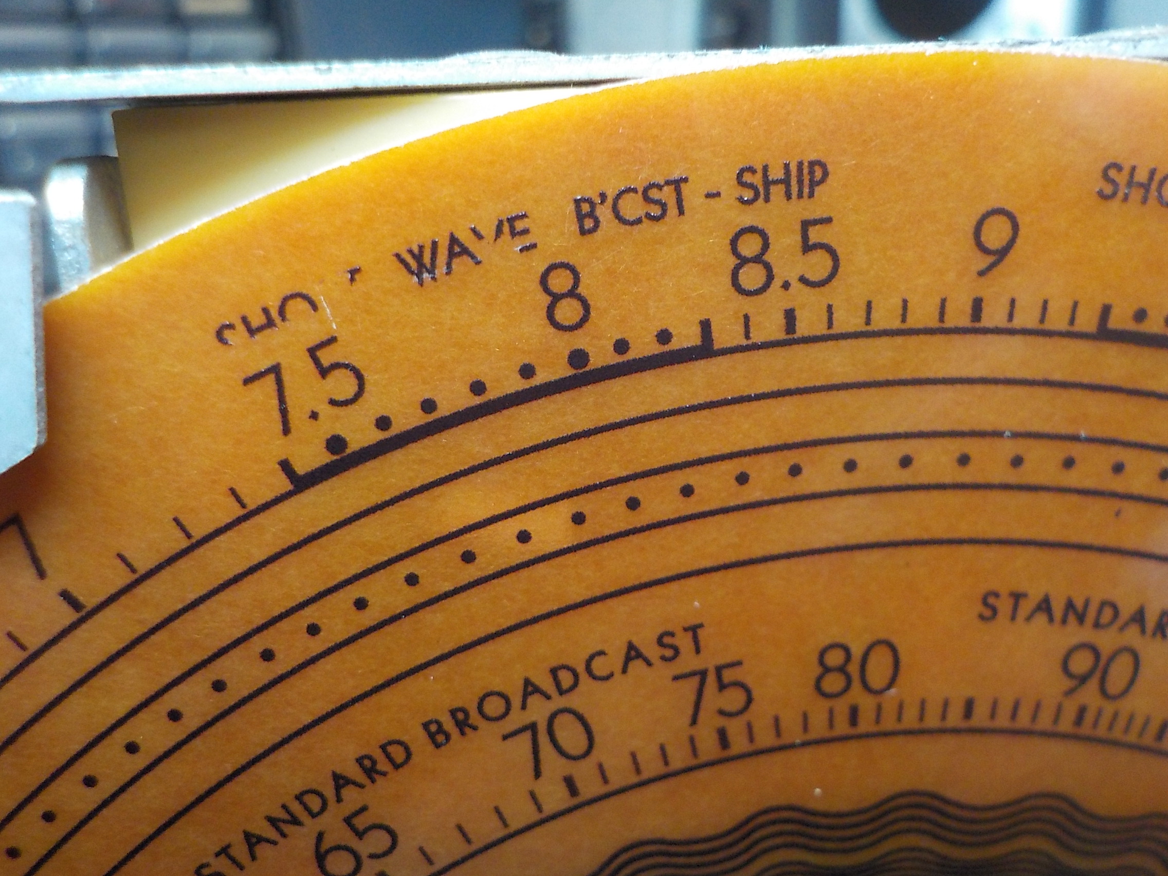

I decided the original dial needed replaced and found a very nice repro from Radio Daze. I had to slightly enlarge the locating holes with a 5/32 drill bit. It was slightly thicker, but went on fine.
One thing I noted: The two guides at the top of the dial were each bent down, and I discovered that this scratched off some of the lettering before I realized what was happening. They are suppose to be straight out, where they guide the dial on the unprinted edge. Learn from my mistake.
I found the band switch to be dirty so I hit it with deoxit, seemed to help. It works pretty good on the BC band, but not so much on either SW band. I do get some stations, but not very sensitive. It may be my antenna. In the center band I get some bleed through from the BC band, but I dont know if there are really any stations there anyway. The AM is pretty sensitive and picks up a lot of stations. It may need the alignment touched up, but it does work now after how many decades of silence? ![Icon_thumbup Icon_thumbup](https://philcoradio.com/phorum/images/smilies/icon_thumbup.gif) More to come ...

Hmmm...maybe we should start gluing some felt to the inside of those metal guides to protect those expensive dial scales?

One thing is for sure, those dials are NOT cheap, so some felt may not be a bad idea. Thanks for the suggestion Ron! I think it is easy to bend those tabs while working on a chassis without even knowing it. I am sure this happened in a previous repair. It's something to watch for at least.
