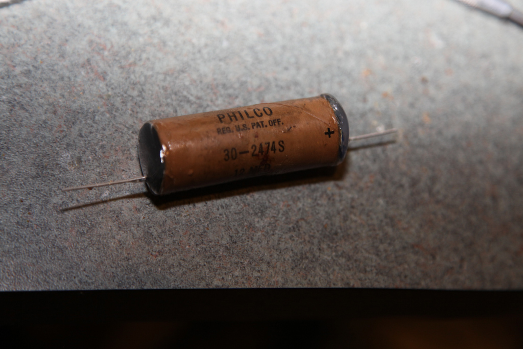

Same exact type of the electrolytic capacitors as before in Hippo is used here. Axial with the paper shell.
The ends are potted with very hard and brittle compound. In Hippo's cap it was crumbling a bit easier, but is not really re-usable as it mostly creates powder and rarely falls out in chunks.
The first cap (12uF) took me little time to gut, the second, however, proved intransigent and it took me good 20 minutes to pick out the deeply potted end (one end is always potted deep, and another - shallow). The other end was very shallowly potted and I cleaned it in 3-4 minutes.
I use small chisel.
You have to pick all the way to the end of the cartridge.
Then the cartridge comes out without much effort and with no heat applied.
Note that I tried use heat on that type cap in the Hippo - no. Did not work. Could it? Possibly. I got too frustrated to find out.

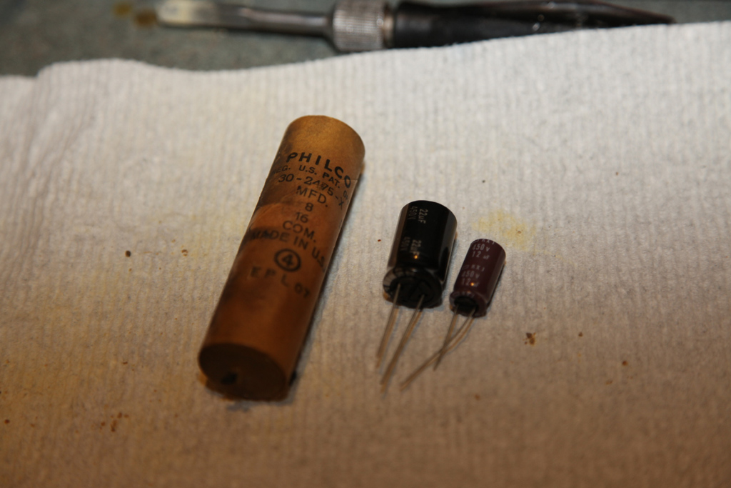

I used two 22uF caps in series. Again, these are Panasonic 450mA rated caps, the highest I found at this capacitance. I need 12uF and so two will give me 11uF which is acceptable, rated at 450mA ripple which is, again, acceptable.
These caps, back to back, are exactly the size of the shell so I had to improvise to pot the cap while creating some cover for the caps' end from some thick paper.
I still have not bought the brown hot glue, and there is no place to melt some tar on top of it, so this will have to do.
The next cap is 16uF and 8uF; I decided to use the same 22uF high ripple cap simply because this value is next one up I have and is acceptable as it is after the field coil and so higher capacitance is allowed, plus it will help with filtering. 12uF, in the place where it is (filtering a resistive divider) and even higher value is also fine.
