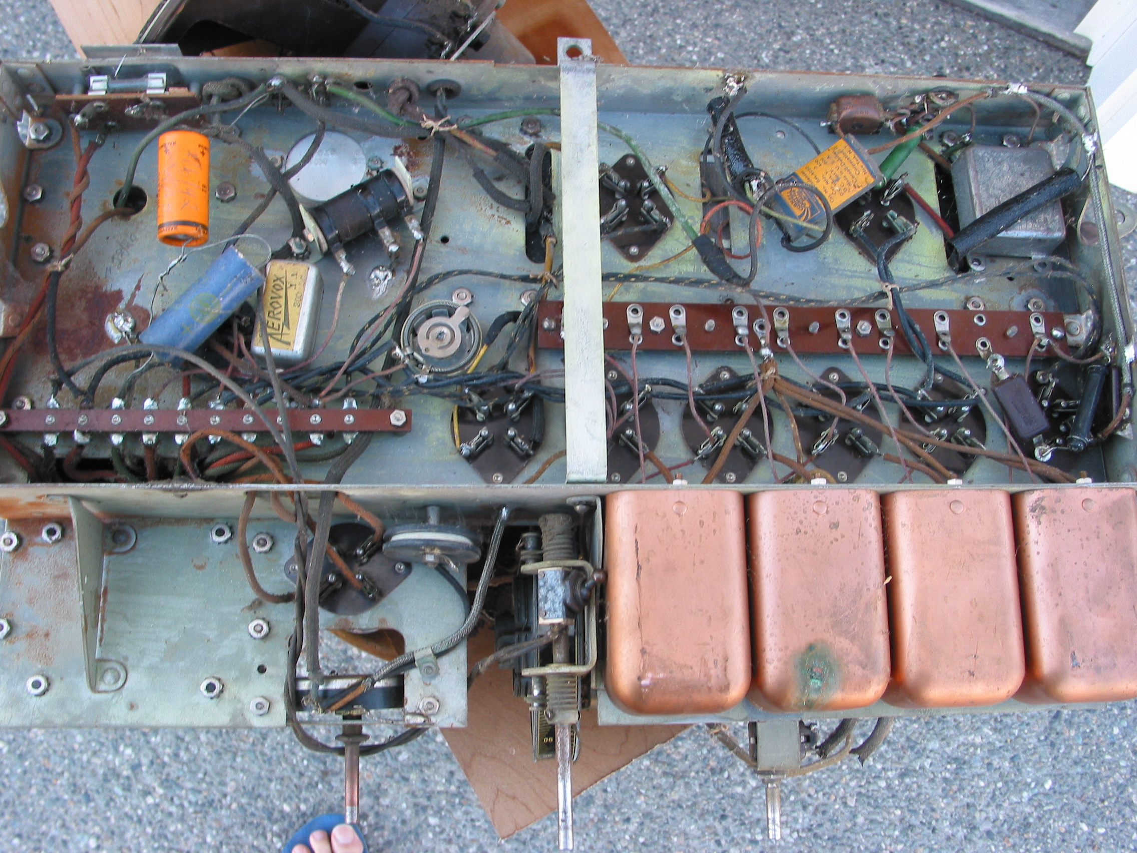

It probably wouldn't be a bad idea to post a few pictures of the chassis once you pull it from the cabinet, that may help narrow down who manufactured it if only from the locations of the tube sockets. A lot of private label sets were manufactured by companies like Ozarka, Wells Gardner, Belmont, and a few others, but I would take a guess that the circuit was probably similar to an RCA Radiola 18, at least in the front end.

Well here's some photos. It does look a lot like Radiola. The tubes are largely Radiotron. Any ideas whose chassis this is? The eight tube lineup is 26 26 26 26 26 45 45 80.
Alan
Here's what I'm going to go with. The Jesse French Piano Company in Indiana manufactured radios for a few years beginning in November 1928. They had a model 5-093 that has some real similarities to my radio and after cleaning and looking closer at the ID tag mine reads Model 5096. I'm going to guess that Peck & Hills Furniture in Chicago bought their radio chassis from Jesse French.
French's 5-093 tube lineup is nine tubes the same as my eight plus a #27 detector. I'm hoping that the 5-093 schematic will help guide me.
Odd to me, I have 5 #26 amplifier tubes and no #27 like most have.
Amputee or not, it's a cool chassis and the cabinet is really nice. I think I'm going for it. Any comments or advice before I do?
