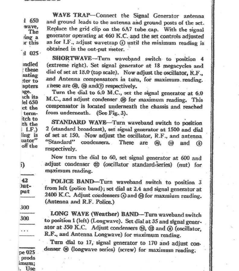

The band selections, from left to right looking at the front of the set, are: LW, AM (BC), "Police", SW.

Gee Ron, you always have the answers in your back pocket. Could this be your first slip. Turns out (if the book is correct) that Philco put a long-wave weather band extreme counterclockwise on the 650. The standard broadcast is second from left, followed by two SW bands. Who da thunk it?
