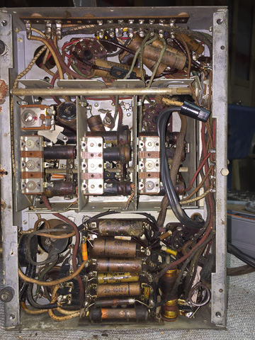

I did some basic work (cleaning, visual check, short circuit check and replacing the power supply caps) and I can confirm that the radio is functional. Reception looks quite good. I now working an overall check starting with the power supply section. This is the reason of my questions here.
  1. There is a 2ohm resistor that shunt the 25 ohm part of the resistor in location 68 (may be a previous repair). This lower the bias voltage from -3.3V to -0.25 Volt. The change adds a lot of sensitivity to the receiver.  If I disconnect it, reception is quite bad.
    Have you seen this change before?
  2. On capacitor in location 66A, I read -22 Volts referred to ground/casing.
    Is it the correct voltage polarity?  In that case, the schematic shows the wrong polarity for the condenser and I need to swap my condenser.
Thanks in advance for your help.

And a few more pictures of the receiver.
Cabinet plates
Receiver

In this situation the + side is connected to the chassis and the - goes to the center tap of the HV winding on the power transformer.
I'll mention if you have an electrolytic capacitor that has been connected backwards do not reuse it, chuck it it's shorted.
I am closing this projet for now. Below is what I did, for reference. Hoping can that help someone - also valid for a 37-640 I guess.
I did minimal restore and checks 1) was my first introduction in radio restauration 2) I don't want to risk breaking something as fragile as the dial disk 4) the design and assembly of this radio is quite complex 3) replacing all caps and resistors would let's me feel that is no more the same old radio...
Finally, the radio works and perform quite good as is. Not a lot of humm, and I get a lot more radio stations than before. Will see in the future. I have a RCA M46 and M46A to practice - simplet in their design and assembly.
Will rather improve the antenna for now.
You may want to consider replacing #61,44,52,60,64,20, and 14. These are in the HV path and if leaky can cause excessive HV current. 41 and 43 are a good idea they can effect the tonal quality or cause noise.
Thanks a lot for your suggestions. Most seem quite easy to replace. I will certainly work this when I will do another restoration pass.
