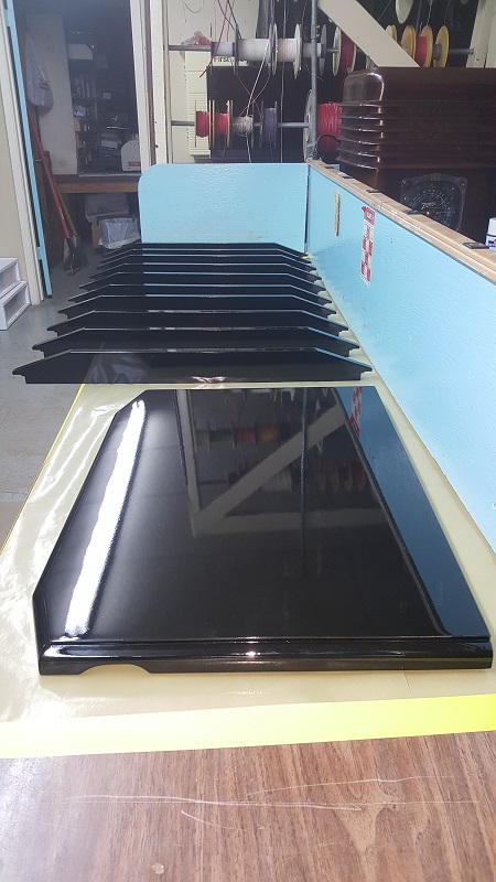

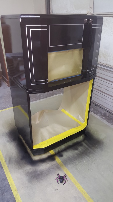

Another radio cabinet that I was chosen to refinish, this very rare McMurdo silver masterpiece radio is under going an extensive cabinet paint job. This had been special ordered in black which not many are around any more . The owner of Zenith Stratosphere I had refinished also is having do this radio. This was quite an under taking , the cabinet needed much work and doing it in a black piano finish it had to be done right. Many hours were spent preparing the cabinet for the black lacquer finish which will be wet sanded and machine polished after the clear lacquer has cured in a few weeks or so. I will post pictures of the polishing stage and the end result of a mirror finish that you only see on high end furniture and automobiles.
Here are some steps of the primer filler applied and the block sanding done to ensure a flat surface. Also grain filler using a two part polyester plastic for grain filler which also is block sanded by hand using a black power guide  coat to insure finding any surface imperfections.
Primed and painted with painted silver painted  stripes, the old stripes looked gold because of the age and smoke what have you. (Pitina) This lacquer must cure several weeks before polishing.
Few more pictures

Finished the cabinet by wet sanding , started with 800, 1500 and with final 3000 grit,  then machine polish with automotive rubbing compound, then a micro finishing glaze. Then I will wax by hand using a good auto wax . Tured out fabulous , Owner will be very happy.
