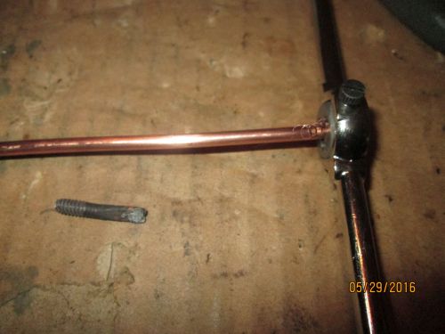

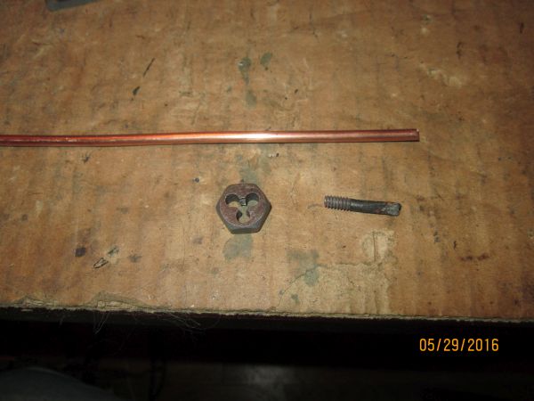

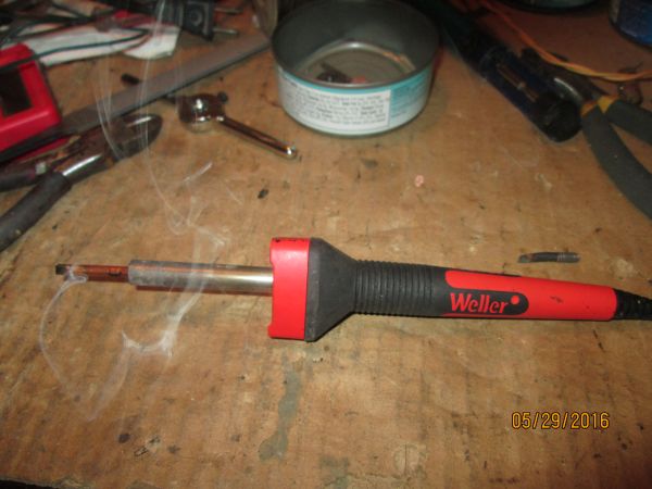

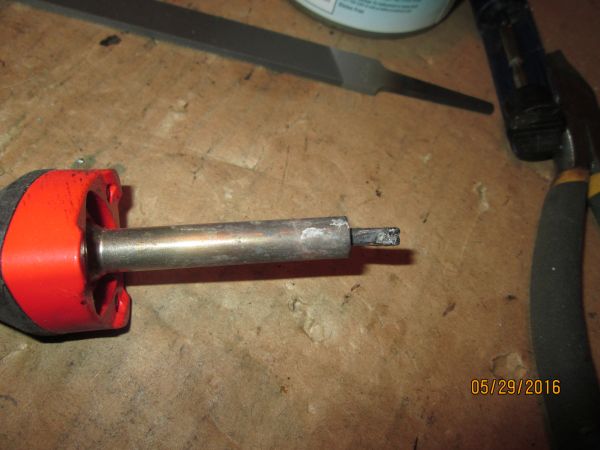

I picked up this little Weller iron a couple of yrs ago and I really like it as it has three led lamps on it. The light makes it very handy to use. But as time marches on the tip was getting shorter and shorter. Couldn't find a model # for the iron and didn't want to pay 4 or 5 bucks for a tip that doesn't fit.
So did a little measuring and found that the tip threaded to fit a 10-24 hole. Had the proper die but had to catch a ride to  the hardware to get some solid copper wire.The fellow manning the wire section at the HD is a ham that use to be a member of the ham club I was going to back it the lat 80's. We had a few yucks abt the club and such. Found some copper that looked good for the size and off we went. Got home threaded it, used a dremel the shape and it's back in service. Now I can get started on the 116X.

Didn't have any trouble getting out it unscrewed easily. But flux in the solder was eating up the copper(after 3 or4yrs). I had read that cheap folks would not reshape the tip by filing or grinding but would beat it w/a hammer thus saving the copper. But you can only beat it so much.
I tried a 10-24 steel and brass machine screws but too much heat lost. Don't conduct heat as well as copper.
There's a reason for the copper to be the material for the tips. Certainly not steel.

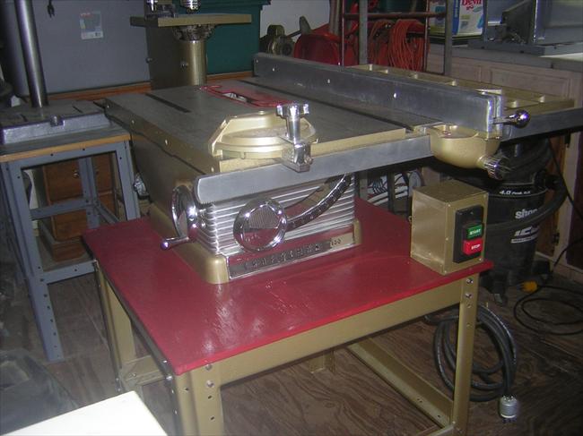

I like old tools as long as they work well. I trash pick a '57 Craftsman table saw from a neighbors house many years ago. It broken and thought I might have to fab some parts ( two banana shaped pieces that allow the blade to pivot). Much to my surprise these pot metal parts were still available some 45yrs later. So for abt $40 worth of parts I was up and running. Here's a pic of one like it that I found on the net. Mine is in a shed and can't get to it. [Image: http://philcoradio.com/phorum/images/smi...on_sad.gif]
Used it a lot to make shelves for all of these darn radios!
