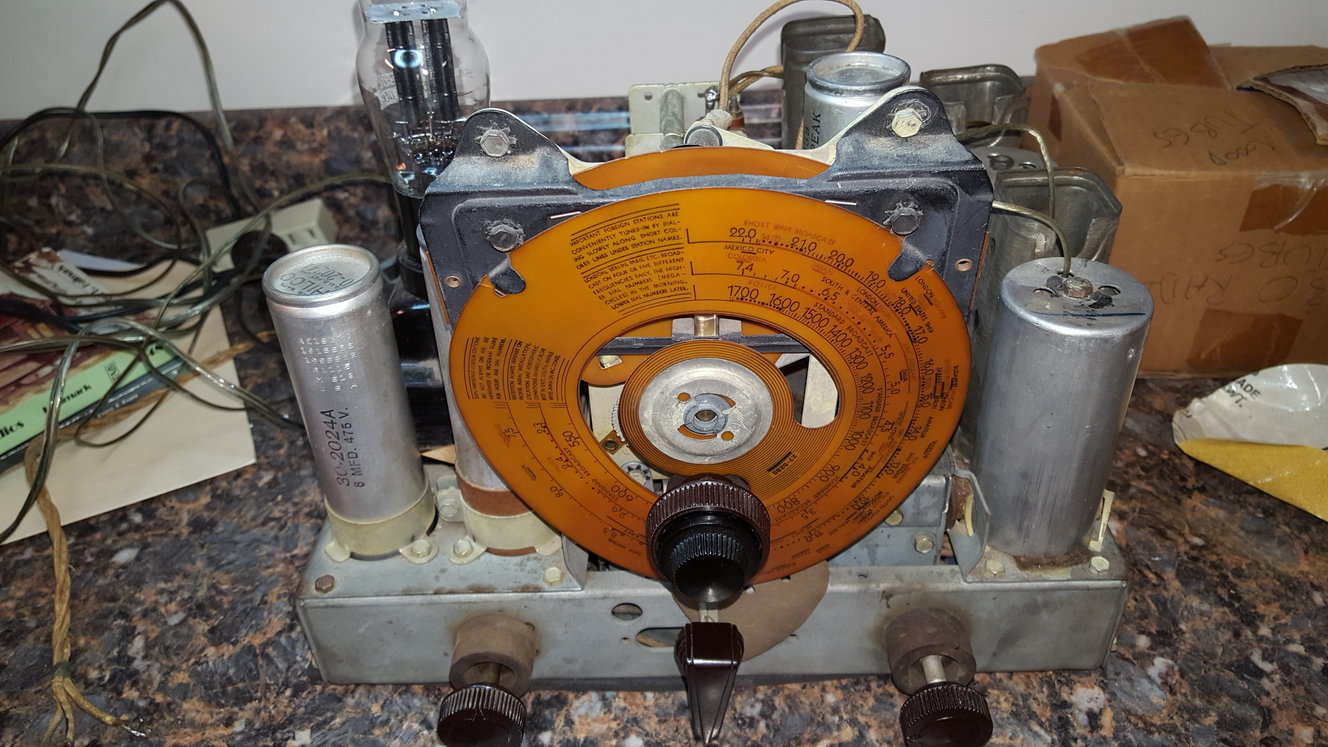

Hello everyone. I'm new here.  I hope you all have a great New Year!!  I've been reading some of the posts and was looking for some advice.  About 20 years ago I bought a Philco 37-620 in good condition. Just needed some cosmetics. I ran a couple of "tandum" wires where I saw questionable wiring on top (and replaced the power cord) the year I bought it.  You can see them in the picture (but left original wires in place). It has worked great for years. Here is the advice I need.  If it works fine...should I change out any components like capacitors for potential fire hazard?
I have it out of the cabinet to repair the speaker cone (mover put a finger through it)  Thank you for your help!

Yes! The blue one on the under side is a replacement from the 50's the others are originals from '37.

Wow!  Thank you for all the great information!  Especially the Schematics!  So replace all the paper Capacitors?  Also being new to restorations....I take it the green, red, pink and yellow ones are resistors?  Should I also replace the resistors?  I read at www.justradios.com that it is not advised to replace mica capacitors.  Do you agree? Can you see them in the picture?

If it works fine....and you don't feel like full recap.....do change electrolytics and all the paper caps directly connected to B+. The rest might not work great but they won't go on fire.
Caps 20 and 57 and all lytics should be replaced.
This said, the paper caps cause other issues so replacing them is highly recommended.
Actually here's one that's a bit cleaner. http://www.audiophool.com/Philco.html
Scroll down the 1937 then click 37-620.
Mica caps are usually ok and don't require replacement unless there are issues.
Resistors can be easily check w/an ohm meter, most the time in circuit.
Tolerance is 20% of the value. You use the pictorial in the service info to
determine what parts are what.

#1 It would 1 meg or 1 million ohms. The colors would brown body black end and green dot. It's power rating is 1/2 watt.
#2 can be replaced w/400 ohm 1/2w resistor
#3 Yes it's right above the 5Y4 tube.
#4 It's a wire wound resistor. Most of the time they are ok it's smaller carbon comp resistor that tend to drift in value.

Thank you again!  Now I believe I have identified everything but am not sure about the 2 bakelite parts as shown.  Are these both .015-.015 mfd bakelite capacitors? OR are one or both of them some kind of bus?

The upper bakelite block appears to be #67 in the diagram (a 3793DG double .015uF capacitor block).  The lower one looks to me like a modification to what is in the schematic and is a bakelite block capacitor that is likely replacing capacitor #57 (a 0.03uF cap).  The bakelite block also has on it a terminal strip that is included in the schematic.  I think you will need to trace out all the connections and components to see how the bakelite block cap is wired up and confirm my speculation.  (I don't have a 37-620 to look at so this is just based on the photos and diagram).  I believe I see the 0.015uF #48 paper cap so the bakelite block doesn't include that one.  Use the schematic to see where the items in the diagram actually are connected (but understand that the schematic shows electrical connections, not necessarily physical locations of the connections)
There is bakelite block cap wiring diagram information in the Phorum tech section.
If you pull the lower block cap out, it will have a number on the side and you can also look up the internal wiring of it, though I also always trace it.  Once in awhile there is a block that is wired up differently than the diagrams.
