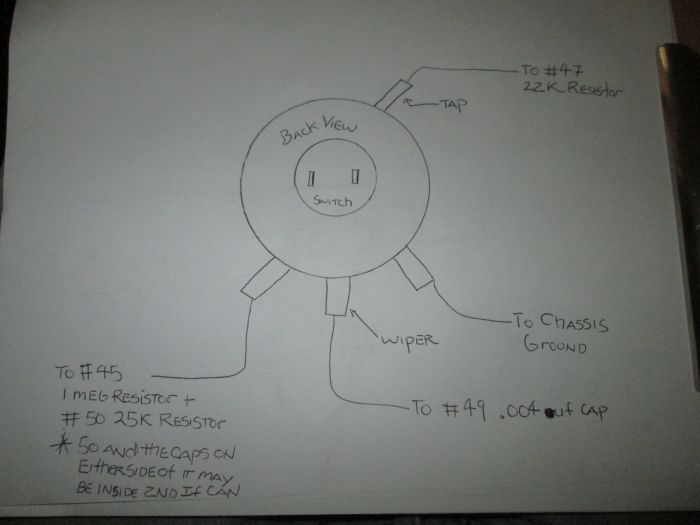

So Mark did have the exact replacement control I needed, I have the control and have now installed it, but now I have absolutely no sound at all. Not even a crackel from the speaker. Any tests I can perform to figure out whats wrong now?
Well have a look to see if you have it wired correctly.
I had to turn my phone upside down to make the drawing match the switch and it's hooked up exactly the way you have it drawn. 22k resistor in line with a .01 capacitor to ground. The wipe meets with the .004 capacitor. The final connection meets with the 1 meg resistor. Just scratching my head as it was kind of working before I replaced the control.
