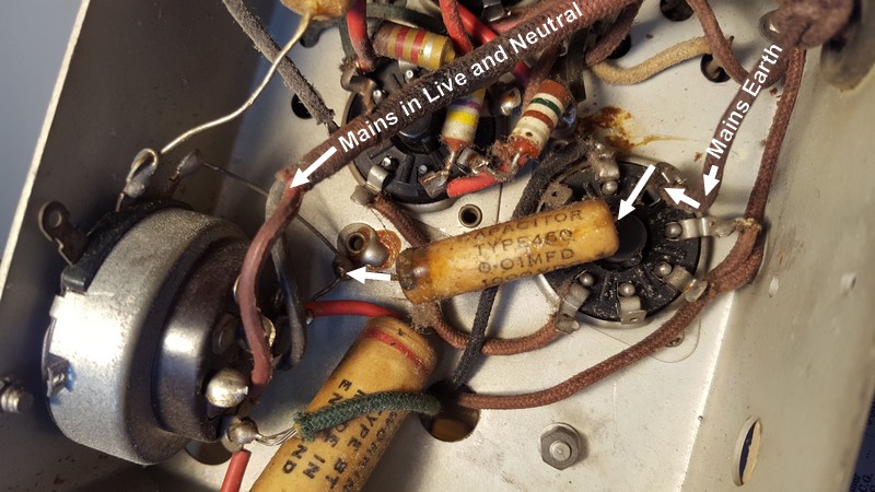

I am in the uk and restoring a Philco , the attached images show the circuit diagram and part of the under chassis around the 35Z4GT.
In addition to the Live and Neutral there is a separate mains Earth all emanating from a modern 13 Amp plug.
The Earth wire is soldered to what looks like pin 6 which I think is not used and then via a capacitor to the chassis.
This is not shown in the circuit diagram.

I am not sure the Earth ever got used like this, after all the outlets simply did not have it back in those times, but using unused pins on the tubes, specifically in rectifiers (and in others sometimes too) as solder posts is usual practice with Philco, and I believe, with others also.
many times unused pins on sockets are used as a means to continue a component to wire transition or to chassis.
the prints never show this level of detail, you have to just know that its the same path electrically no matter if a terminal is used or not.
generally terminal strips are not shown either.
looking at the pic and the diagram, not sure why you have the N & hot AC power leg across the on/off switch. the breaker you power from should be tripping.
~gets me thinking maybe someone retrofitted in a safer plug design sometime in the past.
normally the ac power leg will come in to the on/off sw then power continues out of the on off sw then out to the radio components.
"I" personaly would bend pin 7 inboard a tad, too close to the chassis.

Typically the US sets wouldn't have B- connected directly to the chassis it would be floating and have a cap between the chassis to B-. Your set is the other way around.
I would remove the earth wire as it does make for the possibility of a shock hazard from ac leakage thru the capacitor depending on which way the plug is connected to the mains. With that being said using the neutral as the rf ground is a bit noisier than using a separate earth ground (separate from the mains). Now days the mains are full up with all kinds of rf trash from switcher power supplies and microprocessor controlled devises. The further you can get the rf ground away from the mains the better/quieter it will play.
