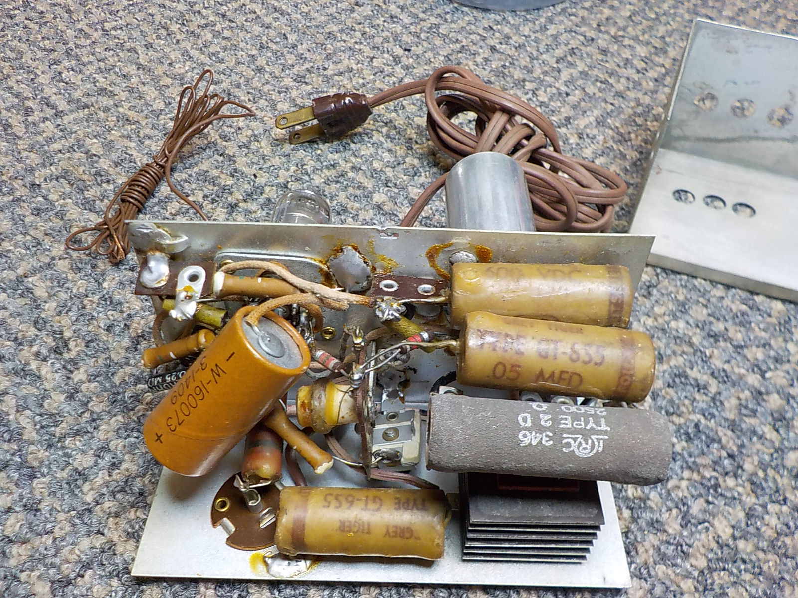

I started the recap by getting a lot of stuff out of the way and checking the fittament if a couple of terminal strips. The can was bad and had some fluid that had bubbled out. I am sure that the previous owner had 'tested' it.
Here I set the new capacitors in place, trying to follow the original layout. I found one 8.2 k resistor up to over 9k, so I replaced it.
Soldered everything in place. That big resistor is in the filament string coming of the raw B+.

Here are a couple shots of the finished recap. I added a 1a fuse in case the diode shorts. After a couple of tries with different dropping resistors, I settled on a 100 ohm 10w. Runs barely warm. This put my B+ at 95v and the voltage across both tubes filament at 2.8v at 120v line. The tube filaments are connected in series.
Test 1: I found it set right around 1600 kc. The input was too sensitive for a line input and was over modulating. I put a 100 ohm resistor to cut down the signal. I may have to adjust some. Sound is clear, but very tinny. I am going to play around some with the input coupling cap and see if a different value will up the quality. As far as range, it doesn't go much past the radio room. Need to clean some dirty tube socket contacts and tighten up the input jack.
