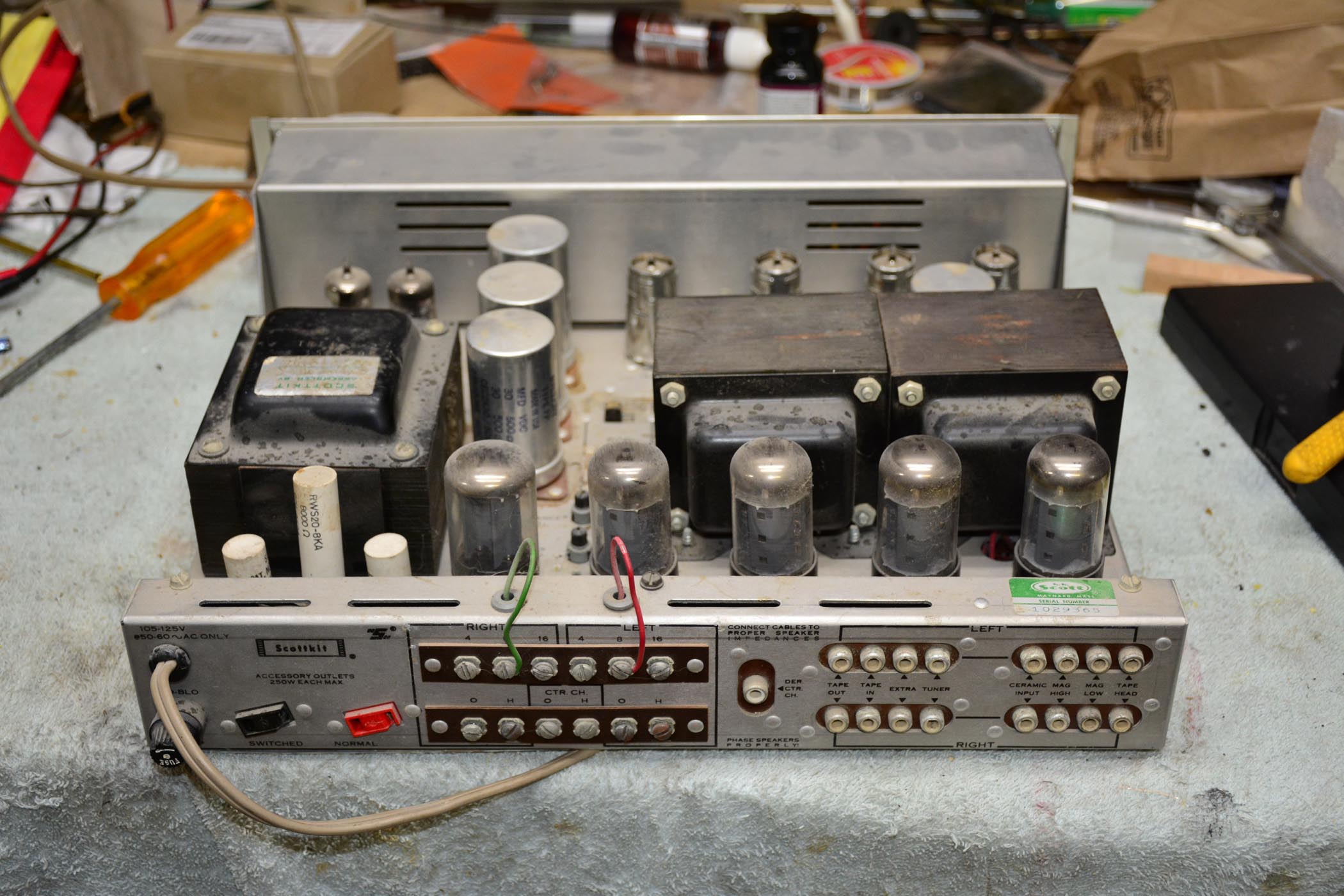

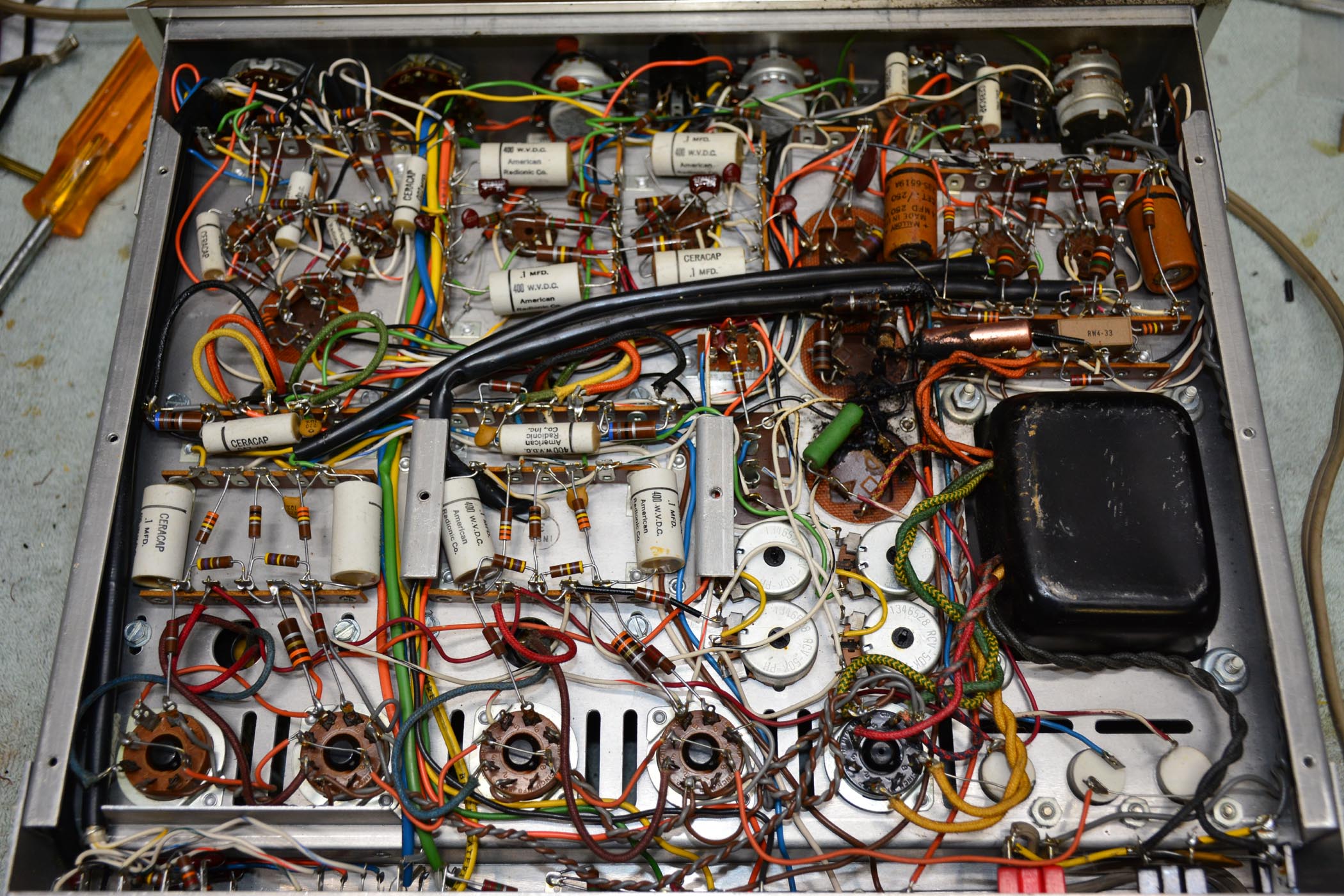

Before I opened the bottom of the amp, I had a bit of apprehension about my work as a teenager. But, after close examination, I was fairly pleased with my layout and solder connections way back then! I read a review of this amp a couple of hours ago and they reported as being very warm but not very bright. It rolls off the highs a bit and works best with speakers that accentuate the the high end. We'll see. I tested all of the tubes and the 12AX7's, the 5AR4 and the 6U8's test ok, if not very good. The output tubes, 7591s, are all very weak. All tubes are original. The 12AX7's are Telefunken and the 7591's are branded as Scott. Not sure of the others as the identification markings are gone. Unfortunately, my sister lost the original assembly manual with the balancing instructions. I found the schematic on line and hopefully will find the rest of the info I should have. When I get to this project, I'll re-stuff all of the capacitors, check all of the resistors, and replace the outputs with matched 7591's. When this is finished, I'll tackle the tuner.

Well, it didn't sit on the shelf. It went to the bench. Replaced all the tubular and lytic caps, several resistors that were actually within spec, but did it for grins and giggles cuz they were in bias and balanced circuits, one open power resistor, 4 matched output tubes, and one bias supply selenium rectifier. I had to add a bit of resistance to the the bias supply to compensate for the silicone rectifiers. I didn't re-stuff the old caps as the new caps were actually larger than the originals (physically), but they didn't look all that different anyway. I got a kit of lytics from Hayseed Hamfest. They had a twist-lock kit for this amp. They look different but I'm looking for performance, not original appearance for this amp. I set bias and balance for the the 7591A's ( boy do those things generate heat!) and ran a sine wave signal through the amp. I noticed that the sine wave was slightly miss-shaped on one channel. Turns out I didn't do quite as good a job building as I originally thought. Found a slight wiring error in the preamp section that accounted for the slightly distorted waveform. I didn't have a scope or signal generator in my grade-school days! Once that was fixed, I started doing some power/distortion tests when I started seeing some very strange wave-forms on one channel on the scope. A 6u8 died. Now I have to wait for a matched pair of 6u8's. Original 12ax7's and 6u8's were Telefunken's. Don't know what I'll be getting for replacements of the 6u8's. I replaced the 7591A's with new, Russian made TungSol's. Review's seem ok, but we'll see. At least they are the same physical size as the original tubes. I'll hook this amp up to my DAW in my sound studio to see how it compares to more modern stuff. I suspect I will be disappointed, but we'll see!

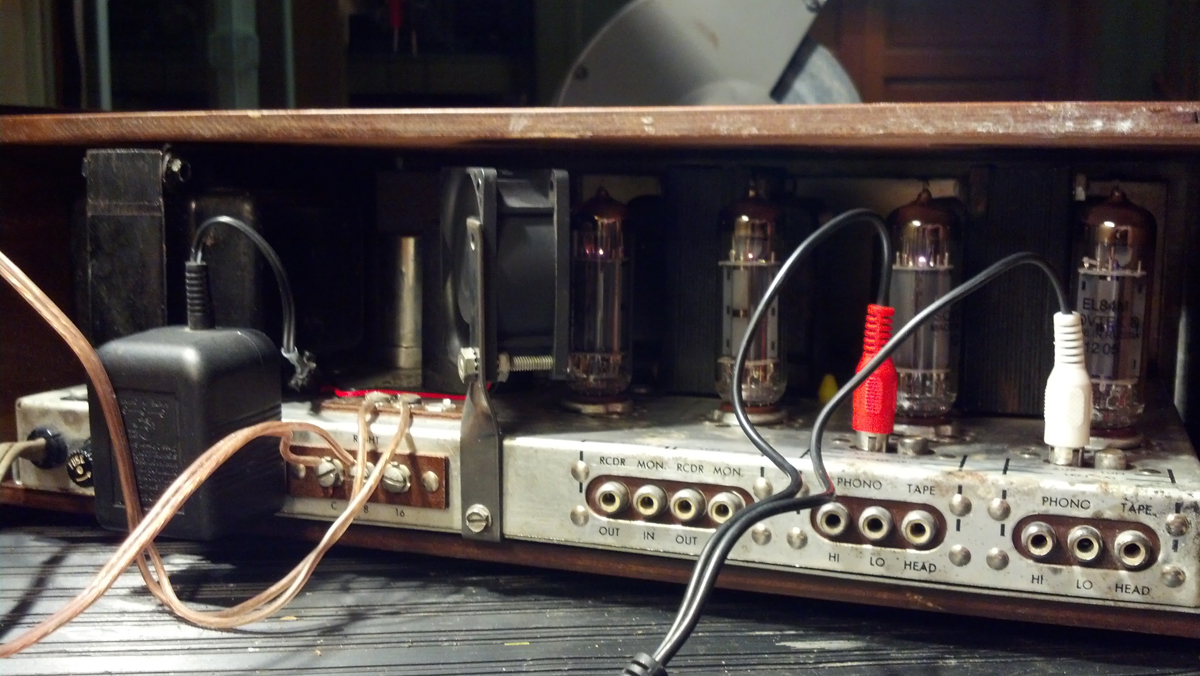

I put a small 12V fan on the back of my tube receivers/amps and run it at 6 - 9V. It keeps the whole thing cooler and at reduced speed (6 - 9V) does not make much noise. The room will still get warm.
Sort of hard to make out here. The wall wart is plugged into the switched outlet so the fan turns on and off with the amp. This is a fisher X-100.

I had put a small 110 volt fan in the cabinet that this was in when my sister had it. The tuner was above the amp and I wanted to get rid of the heat. That fan needs to be taken apart, cleaned and re-lubed.
