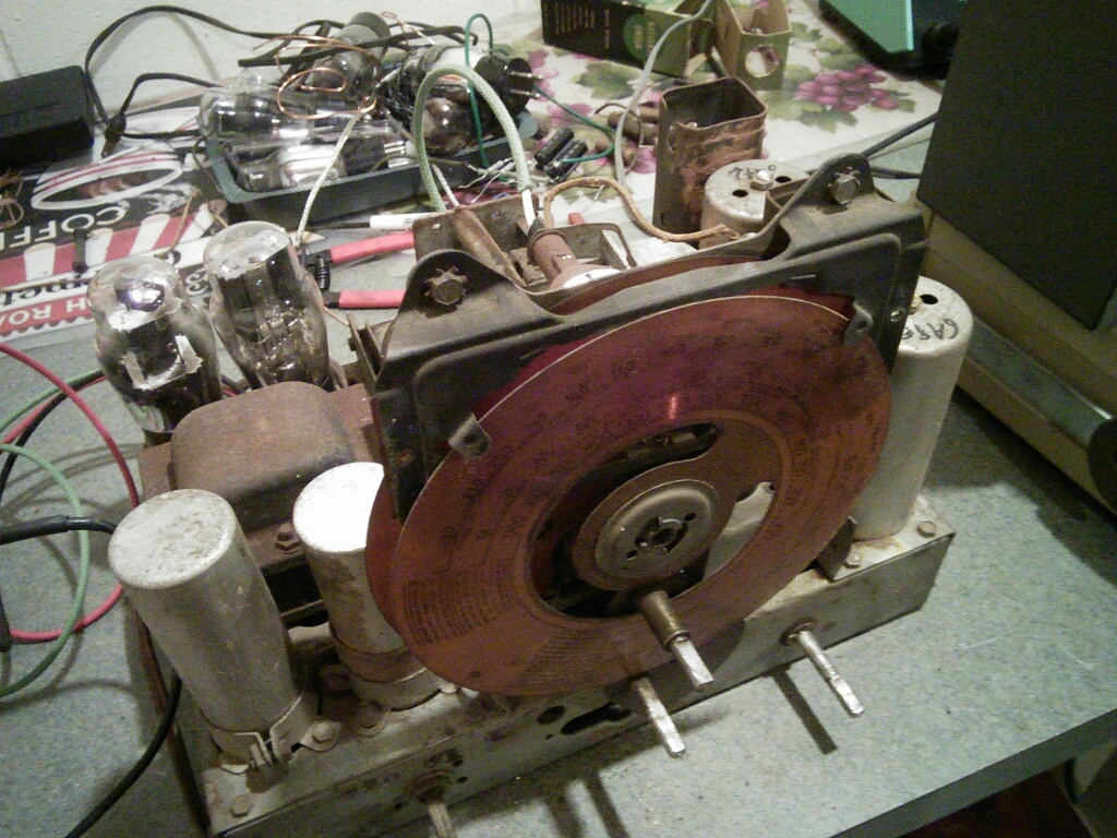

Its really dirty and the transformer is rusty.
Kirk mentioned smoke.
I did a superficial cleanbgc and took out the tubes.
The rectifier's bad.
Then before I went to recap I checked the transformer. I only checked the rectifier filament voltage, seems good.
Did the recap. One cap in the RF chassis took a bit of work, the backelite cap was easy - put Y2 caps n it. Kirk did the electrolytics.
The resistors seem ok, even the wirewound, except the divider 22, 23 and 57 - all seem to be twice the value.
Need the speaker. The speaker wires are really frayed and twisted together. I wonder if this made it smoke.
So far this is it.

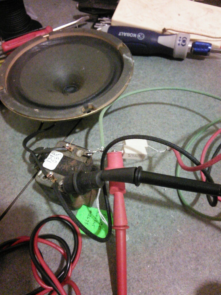

So....I found two 2.2K 5W resistors which in parallel give exactly the resistance of the field coil, and with an output xfmr from Philco 90 for the 47 tube which is the same 7K as for 6F6,which is still wrong as my PM speaker is 8 ohm and philco 37-610 is probably 0.7 ohm or so.....I plugged it in and after swiching to the BC band pulled in the local station and a couple of others when holding antenna input with my hand.
Needs alignment but otherwise is ok.
This is the chassis that smoked according to Kirk. Well, the speaker wires were bare and twisted together. I wonder if this possibly could be the reason?

This is how I connected it.
I have aligned the IF and then BC padders and trimmers.
The sensitivity increased greatly, especially after BC algnment.
The Jersey Shore station is exactly at 1160AM.
I this will be it. If Kirk has the speaker after all
