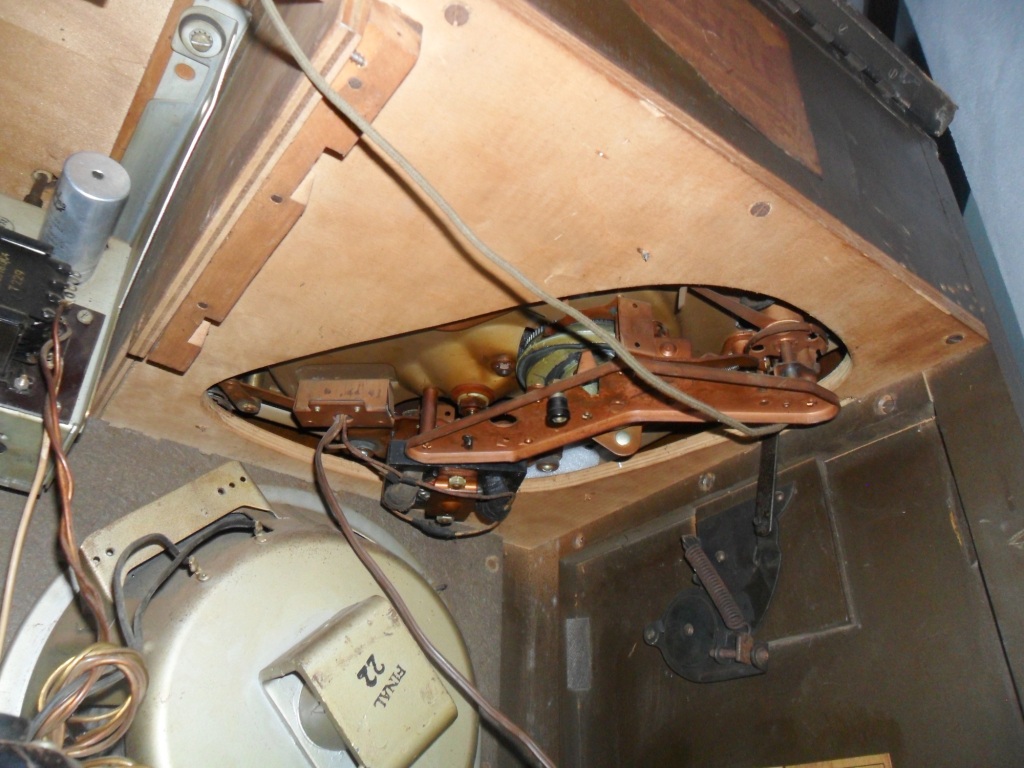

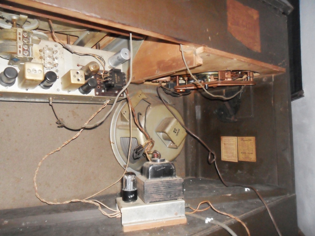

Here comes my device ... I will share my impressions and information about it. To my surprise, there was even an old passport and a maintenance manual. From him I learned a lot of useful information. This unit has a universal power supply for networks from 105 volts to 250 volts AC voltage. Also there are modifications for power supply from the networks at 50 and 60 Hz. It is unequivocal that the company made them for export all over the world.

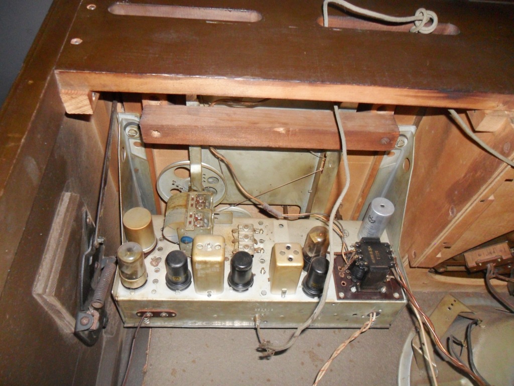

Still in a few words ..
1) Model 39 model year, but released in the 38th. There were similar console models and desktop models, with and without a player.
2) 5 ranges. Broadcasting and 4 shortwave ones with overlap from 3MHz to 23MHz, that is, from 13 to 100 meters. KV-1 is 3mHz ... 8MHz (34 ... 100 meters), KV-2 8 ... 11 MHz (27. .33 meters), KV-3 - 11MGts..13MHz (22..27 meters), KV-4 - 13MHz-23 MHz (13-22 meters).
3) Six lamps, all octal. 6SA7, 6J5, 6SK7, 6SQ7, 6V6-GT, 6X5. . Such a high frequency of confident reception on HF (23 MHz) became possible thanks to a converter on two lamps with a separate heterodyne at 6J5. The optical fine adjustment indicator is absent.

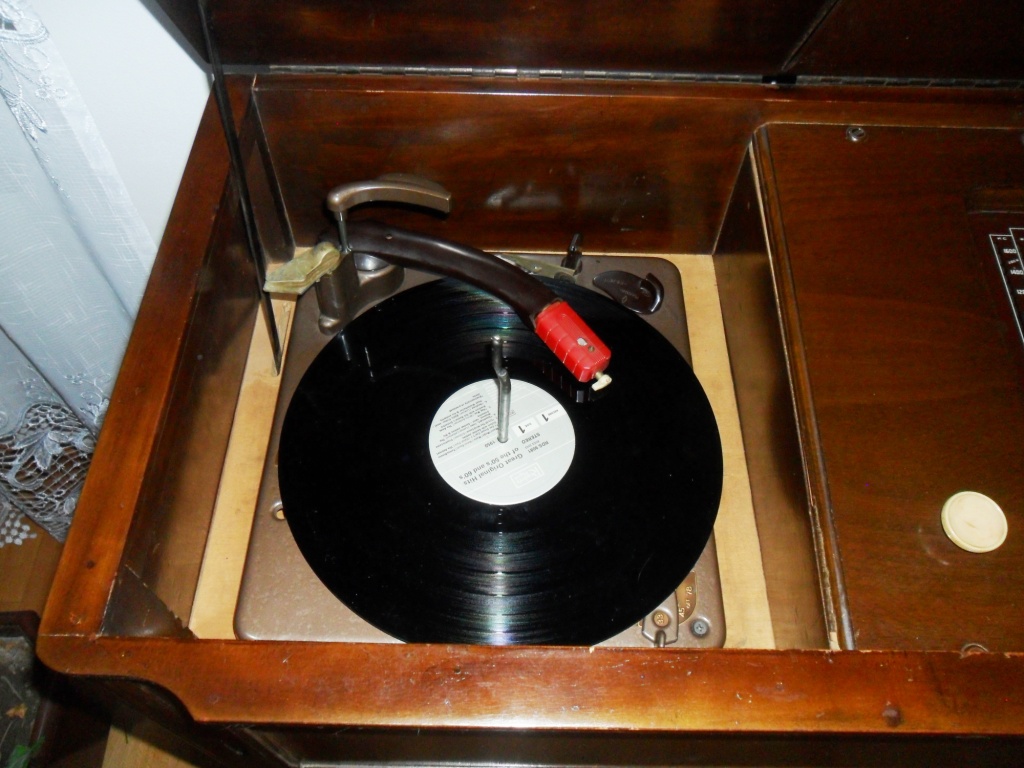

4) To my great surprise in the record compartment I found a passport (with a diagram), a description and warranty cards for the console and a turntable with a gramophone changer. Today, I carefully read and understood that the gramophone is no longer a one-speed one by 78 turns, but a later one, three-speed one. A cartridge with a corrunda rather than a metal needle is rather a plus than a minus, you can listen to your old records without much worry. I think that for this purpose it was changed somewhere in the early 50's. She also has a passport and instructions.
5) The speaker is no longer with magnetization, but with a permanent magnet, but of a decent size - 30 centimeters. A very large bass, even from such a low-power amplifier - everything in the radio and even the room resonated, I had to secure everything and tighten it.

I finished the repair of the radio chassis and the adjustment of the mechanism of the gramophone record player.
I took a short video with a demonstration of the work of the programmer with a gramophone changer.
