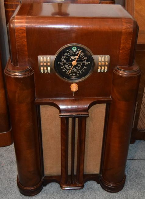

Bought a Zenith 7S363 from a guy and he included a nice Dewald 632 Cathedral.

Also post a pic of the Zenith, in nice condition those are very nice looking cabinets.

The Zenith looks great Murf
