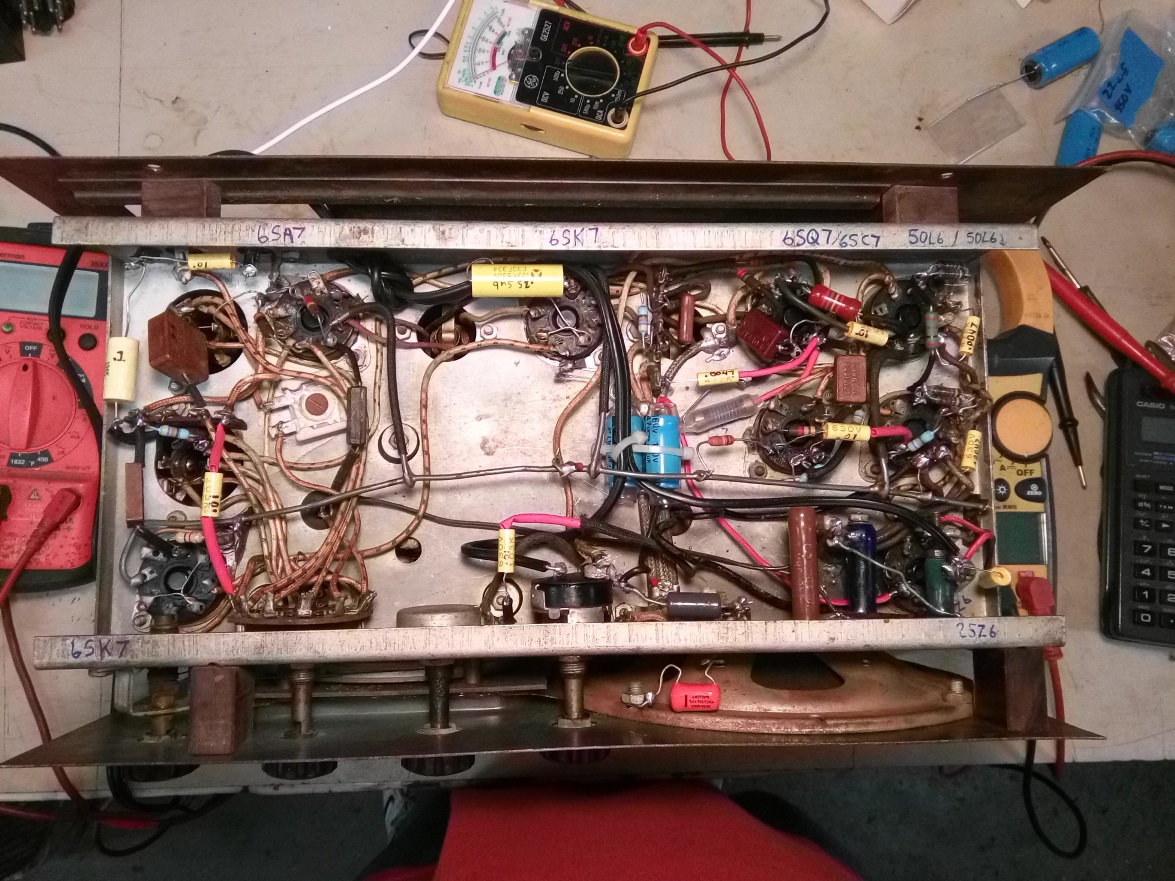

i cleaned up all the temp wiring & jumpers and such ,, latest pic of bottom

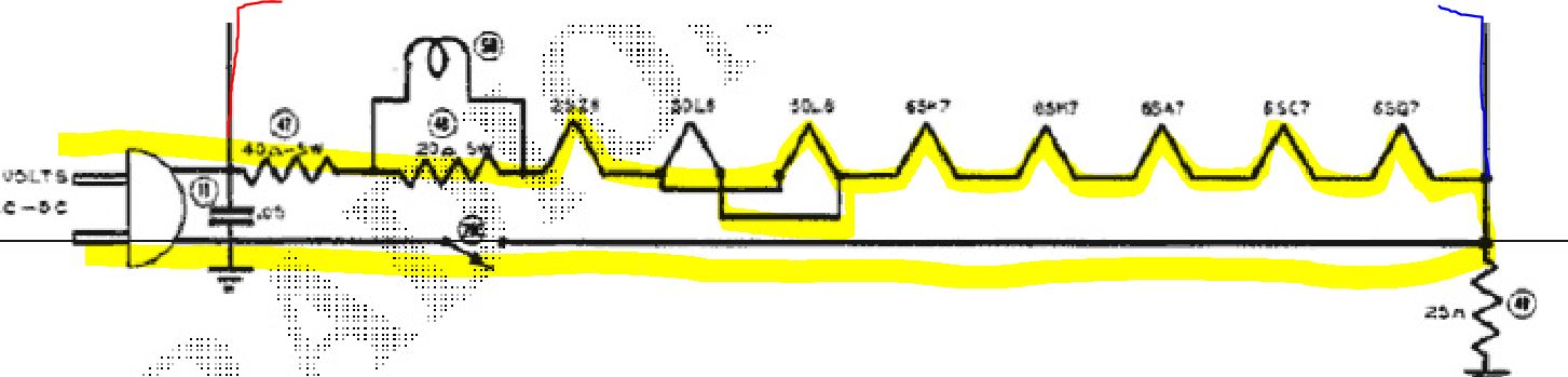

This partial schematic shows how heaters should be wired, this is totally independent of any other circuitry in radio. Has no idea there is a pin 6 on 6SQ7. With this circuit can't be more than 300ma through heaters. The Red feed should be connected to pins 3 & 5 of 25Z6 while Blue is return(negative side of filter caps). That circuit should be drawing roughly 70-80 ma.
Yes it'd make more sense if switch was before Red feed in upper leg of circuit, but it'll work same either way. The safety minded often rewire the switch in that position and install a polarized cord.
BTW I forgot about 20 ohm dilal lamp shunt resistor, along with the 40 ohm, values are fine.
Tom

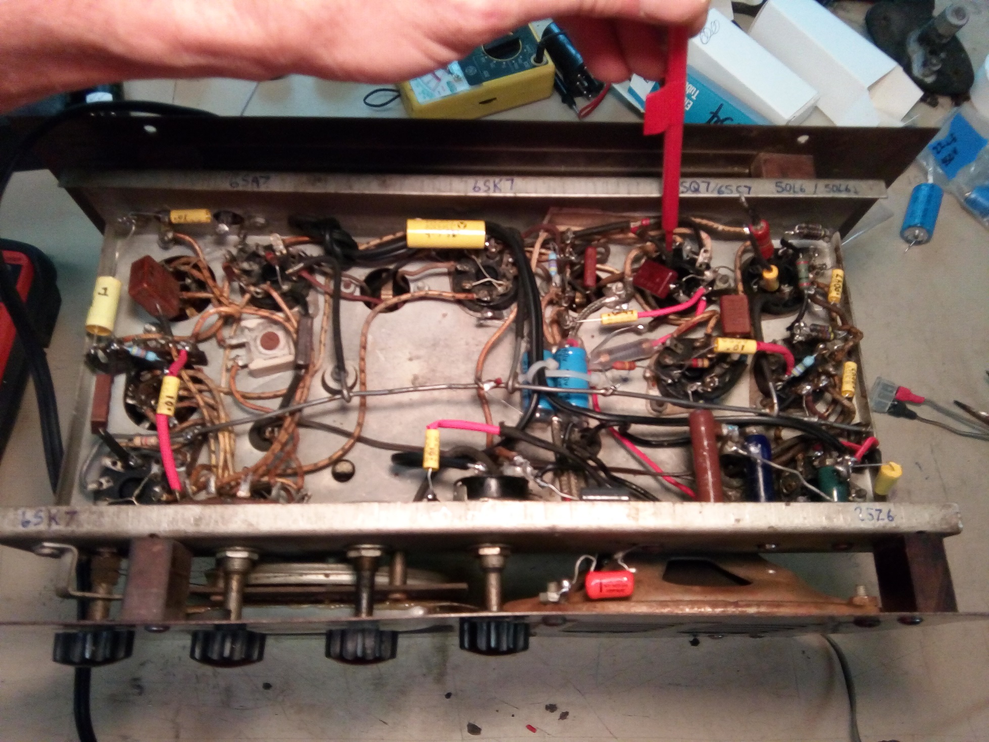

****************I THINK I HAVE FOUND THE ISSUE
with no tube installed on the 6sq7, yet the filament pins 7 & 8 safely jumped,  PIN 6 of the 220k ohm resistor has about 20v which will degrade if i let it warm up. so the voltage will continue to decrease.
up to this point i have been lifting the side of the 220k ohm resistor at the 50L6 side which makes the noise / problem go away.
i kept the 220k ohm resistor terminated over at the 50L6 this time and lifted a cap and the 220k ohm resistor off the socket of the 6sq7 pin 6.
with no tube installed and filament pins 7 & 8 safely jumpered,  and with the 220k ohm resistor lifted off pin 6 of the 6sq7, my voltage readings are:
-the end of the 220k R tied to the 50L6 is 108vdc
-the free end up in the air that normally lives on pin 6  as i have pictured now reads 84vdc ***THIS IS THE VOLTAGE I need with the resistor terminated.
so as soon as i terminate the resistor back on pin 6, without a tube installed, the voltage will crash and drop.
sounding like a bad socket?????????
or bad solder joint(s)?? ~which i can easily reheat up and recheck.
see picture..
see the resistor and cap i lifted off pin 6
see the jumper wire setup (fused) to the right of the set on the bench to jump the 6sq7 socket filament pins 7 & 8.

Bad solder joints can break/make connection but probably 99.999% will clear up at any movement, prodding, etc. You've juggled this thing around far to much to have a bad joint issue.
With only the 220K connected to pin 6, voltage drop will be within socket.
Tom
