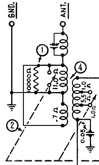

I got a 60B a while back that had a jumper from the bottom side of the 10k (part #1) to ground someone had put there.  I removed it and the BC band went about 50% down, but was still there, however it brought the SW band back.  I just got a 60L and both bands work fine, however there was no jumper, so I just decided to try it and the same thing.  BC band came up very good, but the SW band is virtually gone.
Is anyone else aware of this and if so, is there a way to provide the ground while the switch is in the BC band position, but remove it from the circuit when the SW band is used?  I don't really want to mess things up, but if there is an easy way to do it, I'd sure like to know.

Normally the 10K resistor is grounded through the "police" band primary of antenna coil (4). When in the "police" band position, both the 11 ohm section of coil (4) primary and the 10K resistor (1) are shorted out.
I would check the integrity of coil (4) as well as the cleanliness of the band switch.

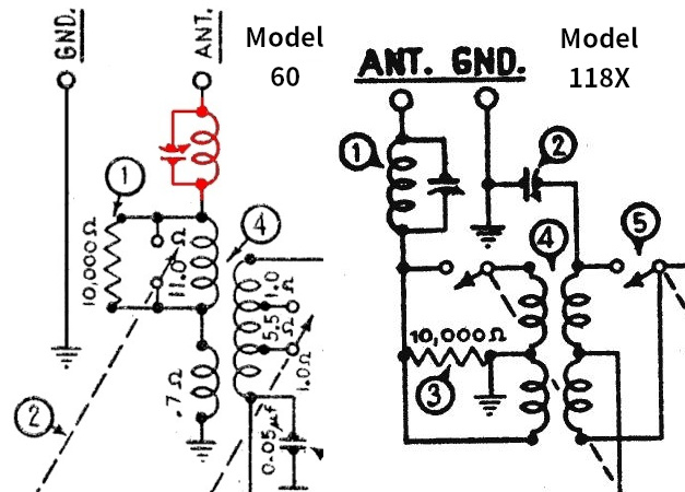

The only change Philco made in that circuit was to add a wave trap to keep any low wave beacons in the vicinity of 460 kc out of the antenna input. See the link above.
Thanks Ron.
I was speaking more about later models or variations of the circuit.  See attacthments.
Coils on both radios check out fine, and both perform very good with a the jumper to ground.  Both also receive fine on the BC band without the jumper, but not nearly as sensitive...
Apples and oranges. Models 60 and 118 are not the same.
Please look at the link I posted in post #3 above - this shows all known changes made to Model 60.
0.7 ohms should be quite sufficient to serve as a ground. If you are needing to put a jumper between the bottom of the 10K resistor (1) and ground to obtain better AM reception, then something is wrong with the 0.7 ohm winding of coil (4). And in the "police" band position (what you are calling SW, actually only 1.5 to 3 or so MC), having a jumper there will effectively tie the antenna to ground, so no wonder the jumper kills police band reception.
