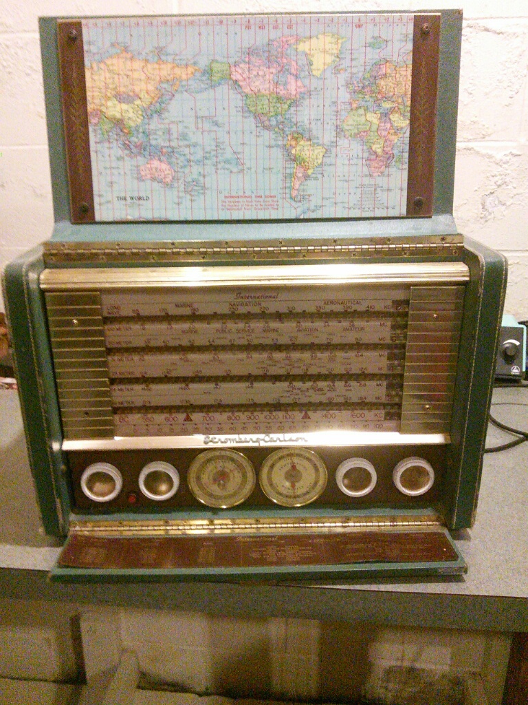

Stromberg Carlson AWP-8
Tonight starting on it.
Mike
Where did you get that one ?
I got this one about over 4 yrs ago, I even showed it here. It's just now that I'm into the Transoceanic groove, I decided to take on this one.

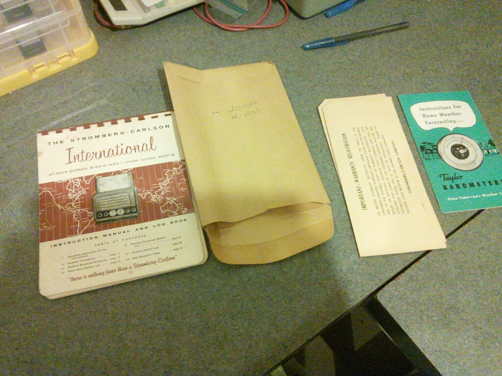

Very nice  except for green color
paper work too  Icon_clap Icon_clap

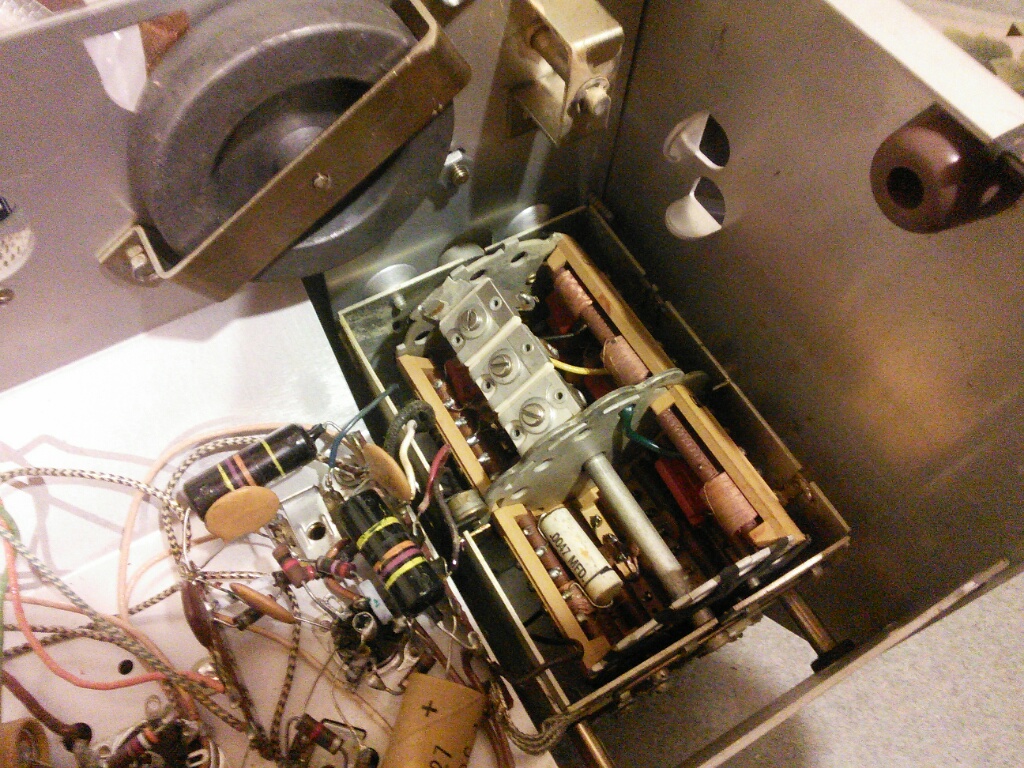

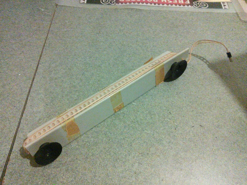

Wave Wizard antenna.

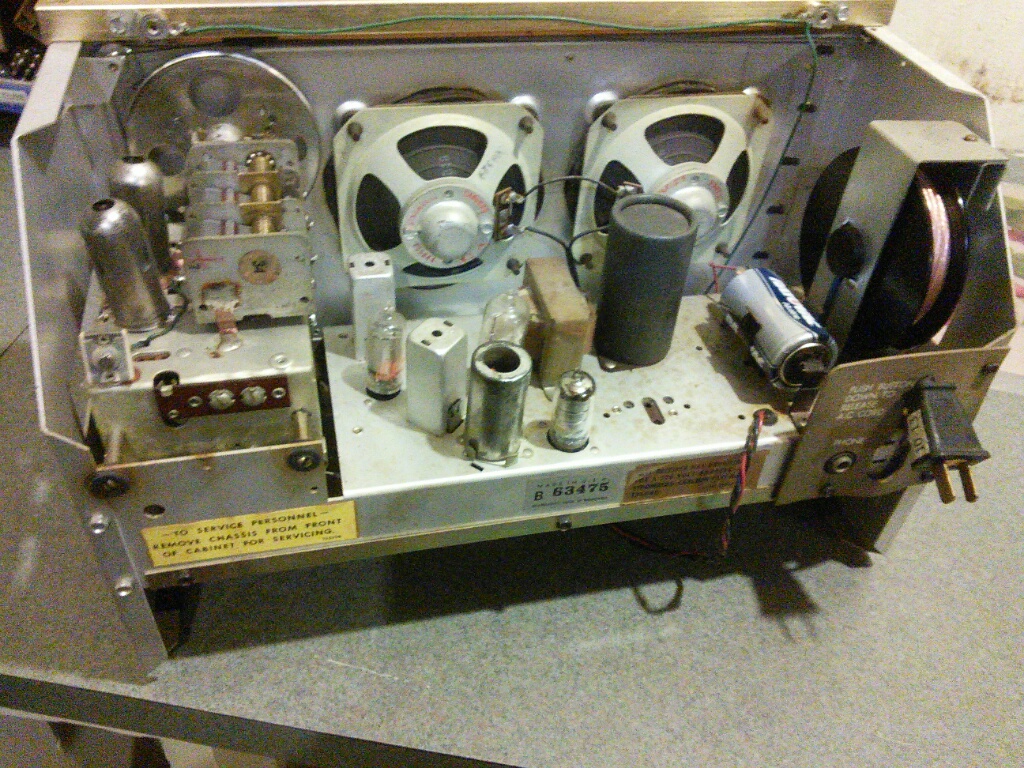

This thing is 10 years younger than the 8G005 and 14 years vs 7G605, so it has lots of new stuff....like miniature tubes and drum band switch, like in TVs.

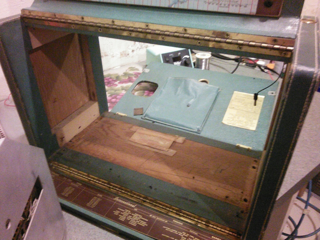

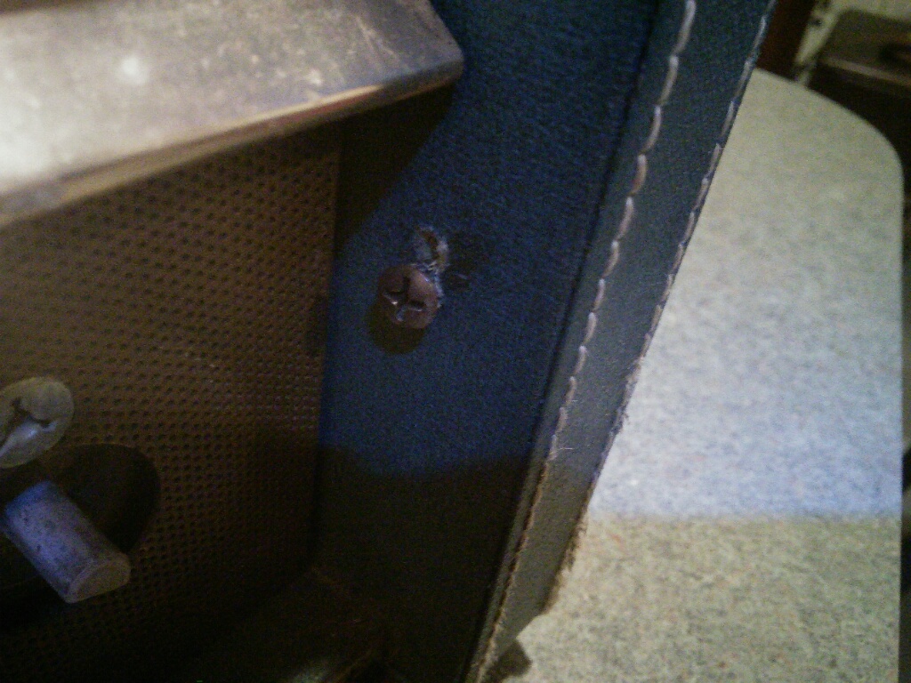

That screw (two at both sides) keeps the chassis from sliding out.
What I did not appreciate was that the chassis is taken out from the front, not from the back.

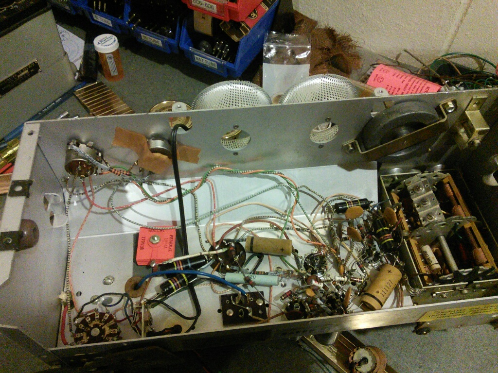

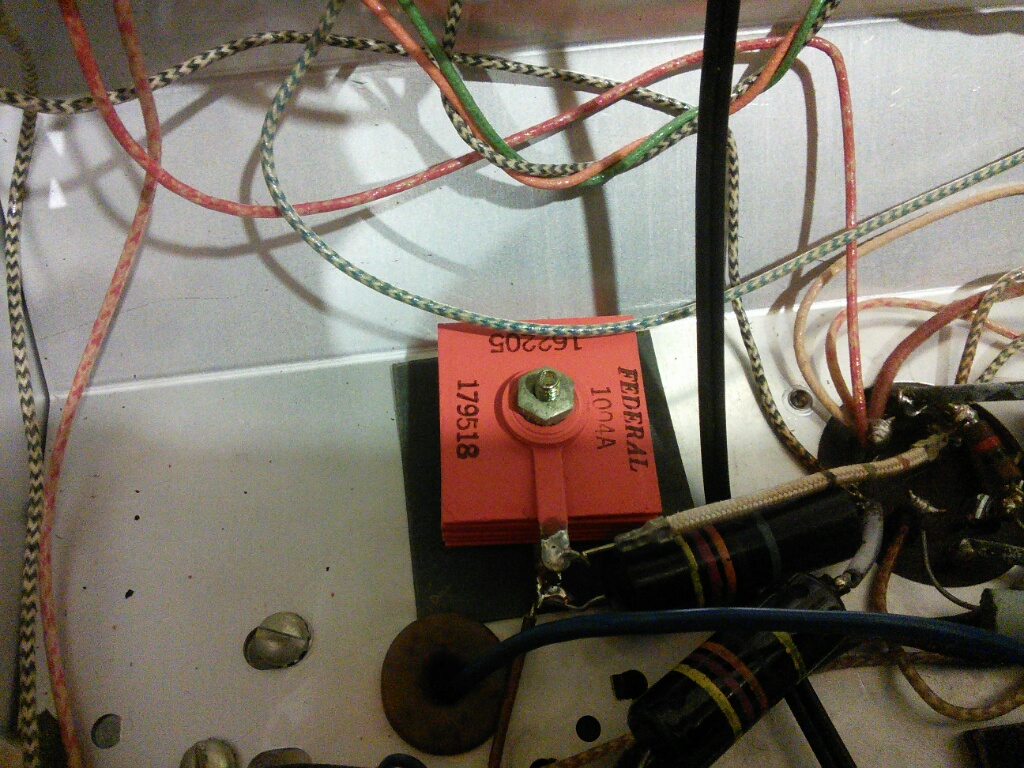

Selenium rectifier and underchassis.
The access would be easy were it not for the chassis cover to be removed requiring one of the side panels completely unbolted.

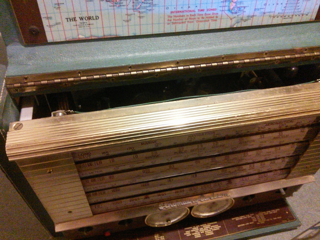

Cool looking portable. Well at least after getting the chassis out; no rubber wire and plenty of space to work on it. I think that's the first drum band switch I've seen in a radio.
It was standard on the Soviet radios like VEF.
The contacts oxidize so they need cleaning every once in a while.

All tubes including the ballast 50A1 are good.
The axial electrolytic caps from 1956 might still work and the Bumblebee caps might be ok enough to work. This said, I will replace them. Probably won't even bother restuffing: the lytics are too narrow and Bumblebees are not easily drilled out.
The selenium rectifier looks almost new. Might be good. I will check it though I know the common practice is to replace it with a diode like 1N4007 and a resistor.

Nice radio.Mike!
Flywheel tuning, really nice dial, two speakers. I imagine they were expensive new.
