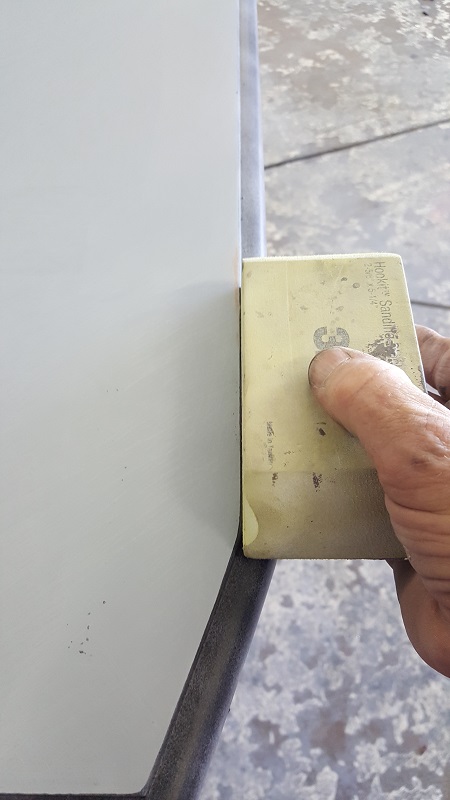

Here are some steps of the primer filler applied and the block sanding done to ensure a flat surface. Also grain filler using a two part polyester plastic for grain filler which also is block sanded by hand using a black power guide  coat to insure finding any surface imperfections.

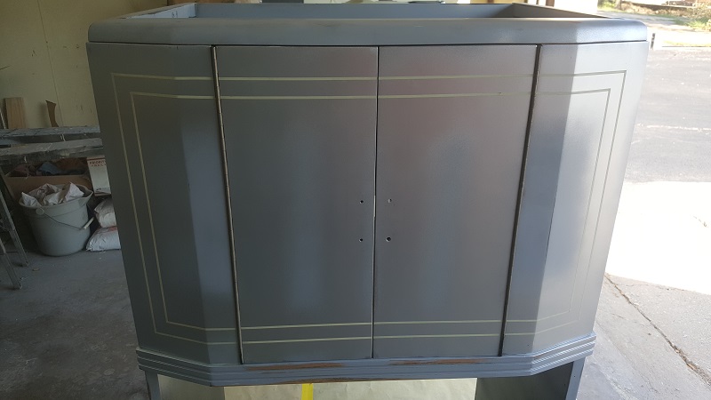

Primed and painted with painted silver painted  stripes, the old stripes looked gold because of the age and smoke what have you. (Pitina) This lacquer must cure several weeks before polishing.
