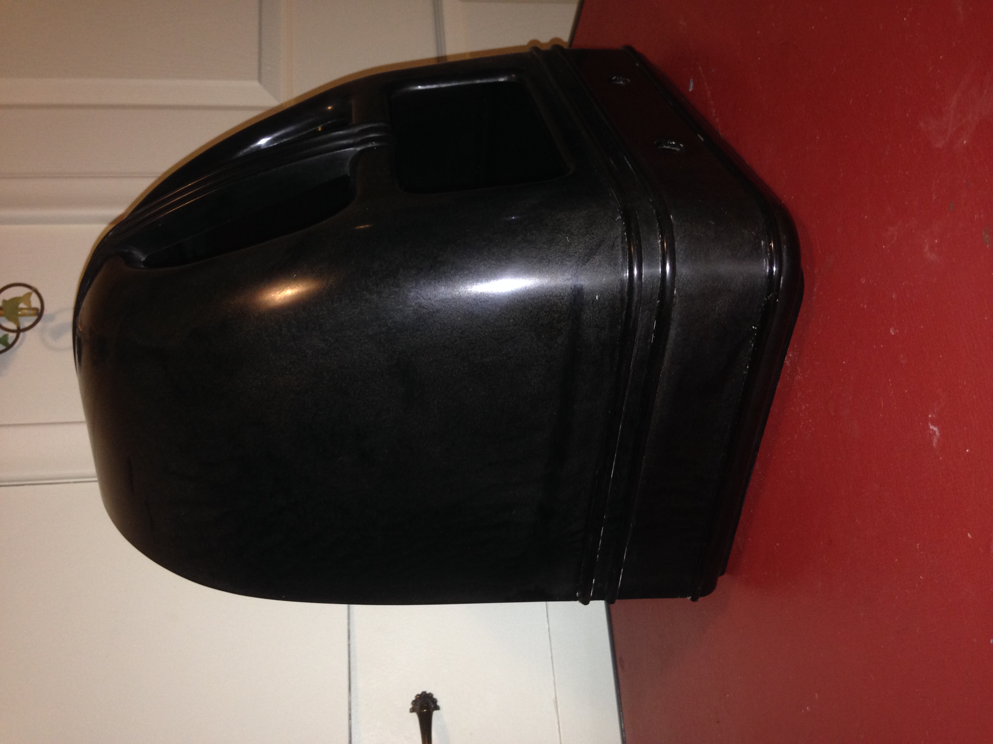

After removing the chassis, speaker, speaker/grill cloth mount a complete or somewhere close to this cleaning was performed to the empty cabinet and speaker cloth.
After much pondering, procrastination, and concern about possible finish damage I decided to use Spray Nine cleaner being concerned about what possible damage to the gloss this could result in.
I placed the cabinet in the bathtub, sprayed it down with Spray Nine and Icon_eek dark brown liquid looking like dark chocolate oozed out and continued after numerous rinses and reapplying.
The speaker grill cloth is supposed to be a light cream color, was yellow/brown barf (looking like it was under a chicken coupe) and now is a yellow amber color after much cleaning to attempt to use as a sample.
A label inside indicating various jargon about regulations etc. was dark brown instead of white and fell apart but I was able to get a scan from over the pond for reprinting.
The Ugly:
The Speaker grill cloth is (what's left of it) Silk which numerous collectors and those knowledgeable about these radios say it is, is next to impossible to find due to not being reproduced including Tygon as well. Sources have totally dried up and disappeared making exact replacement harder to locate than wooden rocking horse droppings!. Out of desperation I went to our local sewing shop, asked for satin material and came up with a light cream colored thin, glossy like the original, somewhat conservative, not to gaudy or "loud" (I hope?) that looks a bit fancier, hopefully looks politically and period correct? Correct me if I'm wrong and steer me to something more tasteful if necessary and possible?
After a number of hours of polishing using Automotive Clear Coat Finishing polish it recovered from the cleaning process looking very close to what it originally looked like when new in 1936 (I hope) and descriptions, pictures etc. indicate it is close. It has a bit of an unusual appearance but is mostly the appearance of Bakelite being pressed into a mold during manufacturer.

Quote:I placed the cabinet in the bathtub, sprayed it down with Spray Nine and dark brown liquid looking like dark chocolate oozed out and continued after numerous rinses and reapplying.
Quote:After a number of hours of polishing using Automotive Clear Coat Finishing polish it recovered from the cleaning process looking very close to what it originally looked like when new in 1936 (I hope)
Factoid: Bakelite is not an indestructible plastic. It can be dissolved using caustic chemistry, particularly strong household cleaners.
Although this is not 100% true for some Bakelite formulations, exposure to sun and household contaminates alters the surfaces. Therefore, the same radio may hold up to a strong cleaner but from another environment will be dissolved. What was actually happening is the top, gloss layer, of Bakelite was removed. The smell of phenol is most obvious and is often confused with nicotine tar..
Some Bakelite have a course filler to keep it stable from shrinking. The outer layer is caused by the filler migration away from the mold. It is not very thick, wash it off and the filler is exposed. This is very difficult if not impossible to polish.
Consider using a far gentler cleaner such as Murphy's Oil soap or the Go-Jo method. Either way the surface will be clean without dissolving the Bakelite.

And meanwhile Spray Nine is not overly powerful and is gentle compared to Fantastic etc. I ended up with excellent results as an end result and of course sun has its effect on Bakelite as well. This is why I used extreme caution at first and much cigar cigarette tar came off. The cloth is very brown and should be pale cream color again indicating how bad the tar was. This polishing compound is ultra fine for finishing clear coat to a glass like appearnance and if some revitalization is required the wax (Turtle Wax) certainly did the trick. Since I'm not able to post picture it would appear, I would have posted before and after pictures!! As for Microsoft Paint and Photo editors this means ALWAYS uploading pictures to a desktop or laptop PC (since my Crapple diePhone won't work and being proprietary pay pay pay I will be ditching it soon). I'm sure I'm not the only one with this opinion for what is required to post pictures. Ah yes opinions are like "a holes, we all have one"

I don't think that Spray Nine is too harsh on Bakelite, Bob Andersen uses that quite regularly in his restoration work. I've used laundry detergent to clean Bakelite as well with good results. Chances are that it did have nicotine, or at least lots of grease, dirt, and wax on it if the grille cloth was yellowed that much, smoking was a popular hobby over there just like here, and they probably sat right next to the radio whilst they were doing so.

Here is a picture of the cabinet after the cleanup
