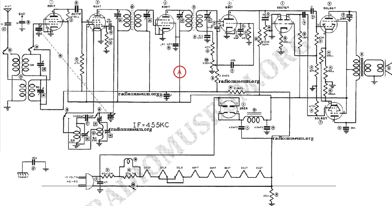

another idea was suggested and i tried it last night.
i put my cheapy 10$ analog meter in series within the area shown on the schematic.
the only odd thing is this particular conductor is a part of the solid #8awg tinned copper **HOT** buss bar system that runs bare everywhere under the set.
i cut the buss bar just ahead of the TEE in the photo and put my ammeter there.
I am not really sure about this yet but i think it will be a good option.
with my ammeter in place, i power up and all is well.
the ammeter has 10ma, 250ma , 10ua and 50ua scales only.
i tried using the 10ma scale and the needle pegs out... no matter what.
using the 250ma scale with radio on, the needle creeps up to around 35ma.
when i tune to a station and it comes in with strength, the needle reading drops proportionally to somewhere around 20ma.
when i use the speaker terminals with my millivolt meter, the needle is around 20mv with no signal and it proportinally increases with voltage.
in order to use a milliamp meter, i need a scale like 50ma i think.
what it will look like installed is this...
-radio off , needle to the left...
radio on,,, needle to around 75% to 80% to the right.
As a station comes in really good, the "GOOD" indication is when the needle moves to the left!!  kinda backwards from a man/machine visual indication but it is what it is.  all i have to do is redo a background label showing such info.

i got er done, a few pics and a couple vids.
use the needle mechanism from a cheap meter
read its resistance.
insert in series with your B+ main feeder.
power up and observe if the needle pegs out or it does not move.
determine on your own if you need to add a series or parallel resistor to your needle part.
in m case, the needle part reads 348 ohms.
in order to gain control of the needle i had to calibrate down to 4.7ohms.
radio powers up....
needle pegs out
then it starts to come down to the scale and follow the signal strength.
i used the multi meter ohms graduations on my reused clear cover to help denote signal strength.
the meter i used was 10$.
this method should work with any radio using any cheap analog multi meter.
basically all you are doing is rigging up an "ammeter" cause when your in series with the battery+,

You do realize, there is B+ exposed at that coil?
sorry late reply,,,
help me out here............
yes i know B+ is at the coil. i cut the main B+ at the output of the rectifier and put this coil in series so its actually reading the milli-amp draw like an ammeter. So, both sides of the coil are hot,,, both wires are B+ hot.
what are you seeing that i am not? as in what is the issue you see?
Schematic-wise, none. Safety-wise....an exposed hot is inherently unsafe.
oh, i see, you didn't see the video yet. the pics represent an incomplete project.
thanks , you had me wondering.
Icon_thumbup Looks like you have it covered
