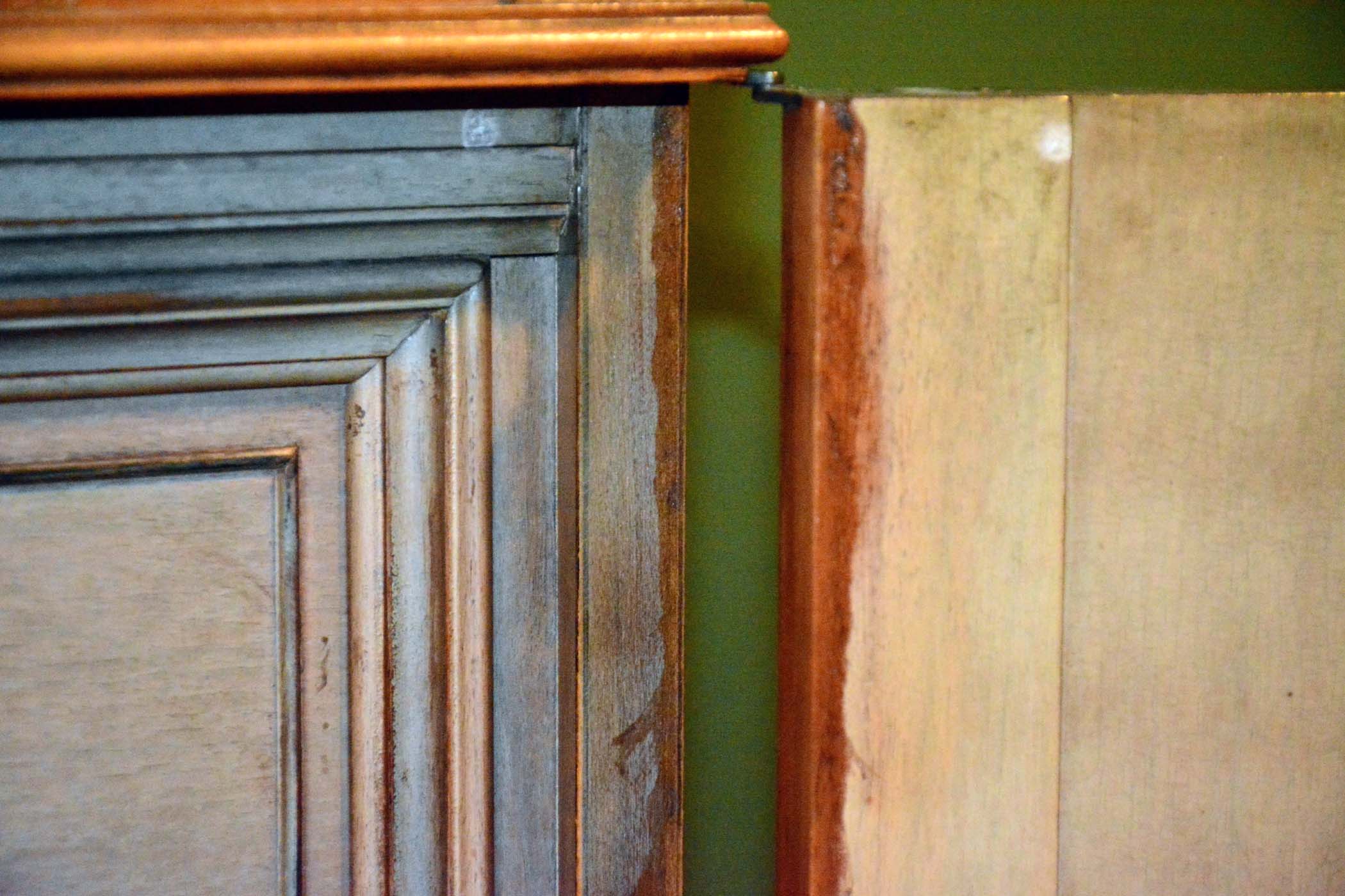

That is quite a cabinet. The finish appears to have yellowed. If it were to be refinished it would look amazing, BUT, it is also too nice to refinish. It is possible that the hand-cleaner method might help remove some of the "yellow".
Russ, at some point in it's history, someone tried to "restore" the finish.  If you look at the edge of the door, you can see where something was wiped on and slightly spread over onto the inside surface of the door.  There is evidence of this in multiple places.  Perhaps you are familiar with what might have been used??? The inside of the doors and the speaker grill have a very strange color and are probably the original, deteriorated finish.  The inside of the record player compartment is probably close to the original walnut color on the cabinet. Much more brown.  Looking at the inside of the doors and the grille, what kind of finish would have deteriorated in that way?  It looks highly oxidized and almost greenish in color.  Could they have used shellac instead of lacquer?  Does shellac age in that way?

Yes, shellac can turn black, green or white with age and moisture but so can lacquer.

Your radio could have been finished in shellac or lacquer. It looks like somebody tried to brighten up the yellowed finish. This would be justification (for me) to refinish it. It will be an awesome cabinet if done properly. You can test for shellac in a hidden area by applying alcohol on a rag to see if the old finish will dissolve and lacquer thinner to see if that "top coat" is poly which will get soft, but not wipe off. Hope it is not poly.
Be careful with the solvents.
Boy, I hope it's not poly as well!  I may test it as you suggested.
