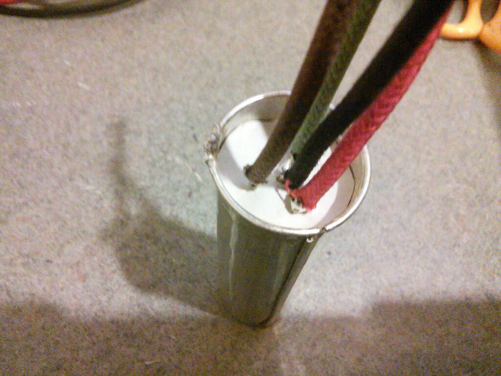

The fish paper came yesterday. Today I will re-stuff the first cap.
Good think about these caps, they do not need to be cut or untwisted, or......only gutted with heat gun.

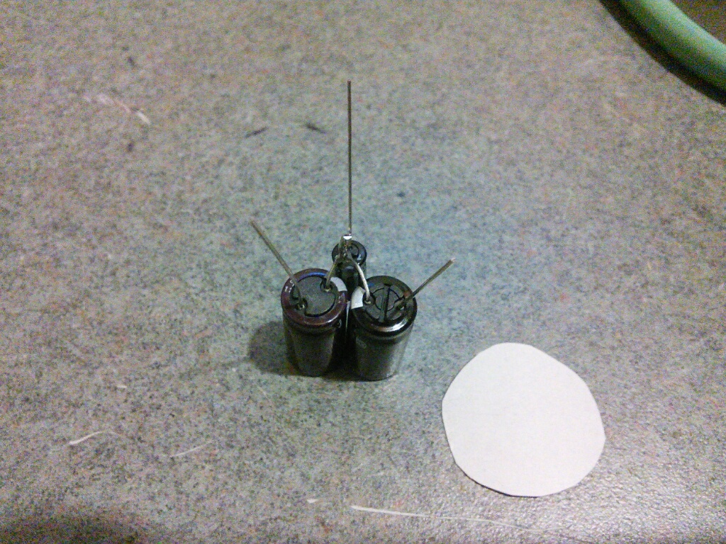

I plan to:
1. Line inside with the fish paper, leaving 1/4" at the bottom exposed (so the potting grabs to the metal wall).
2. Place the assembled and wired caps inside, not too deep, and cover them with a fish paper circular piece so only wires protrude, and then pot the space left (1/4").
Then will repeat for the second cap.
What did you use to pot the bottom end of the assembly?
Same stuff I use for tubulars: coffee-colored hot glue.
Ok. Looks good, very authentic looking.
I recently bought some brown hot glue from the auction site, a Chinese seller. It's arrived but I have not yet tried it.
