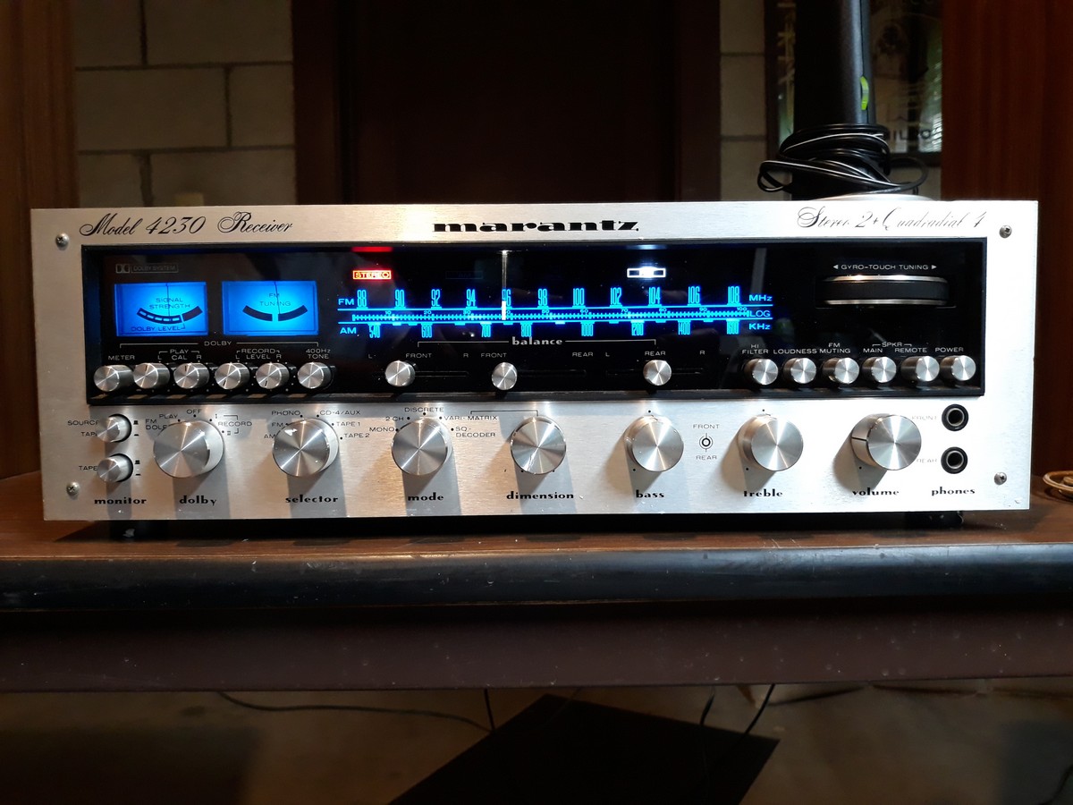

So today I finished replacing electrolytics in the original tuner board, and (using a grounded wrist strap) installed the other NTE IC I had in place of the original.
Results:
Basically the same as the first board, only there is evidence of life on AM although it is barely picking up anything on AM.
Then I had a thought...is replacing the electrolytics throwing off the alignment that much?
I'm tired and my brain is still not functioning 100% thanks to all the chemo.
At this point I would be much obliged for any help; otherwise it is going back on the shelf to be sold at a later date "as-is - for parts". I've invested way too much time on this one already over the space of a couple years and I'm really getting tired of messing with it.

Actually, a Phine Phorum Phriend has volunteered to look at it, so...if I can come up with a suitable box, this Marantz is going on a little trip.
I really appreciate the offer of help (you know who you are).  I am really tired of looking at this thing.
Good news:
My Phorum Phriend has informed me that the 4230 is up and running again. The culprit: a bad transistor in the FM IF section of the tuner board.
I want to express my sincere appreciation for his taking over the job. After you mess with something so long, too often your brain becomes fatigued and you start second guessing yourself..and your progress comes to a complete halt. This is where a second pair of eyes always helps.

It's back home and now set up next to the workbench in the basement:
That dial certainly looks good with all LED lamps.

I should mention that it's been more than a month now...and the 4230 continues to work well by my workbench.
Thanks again Ed L. You did a great job on this tough dog Marantz.
