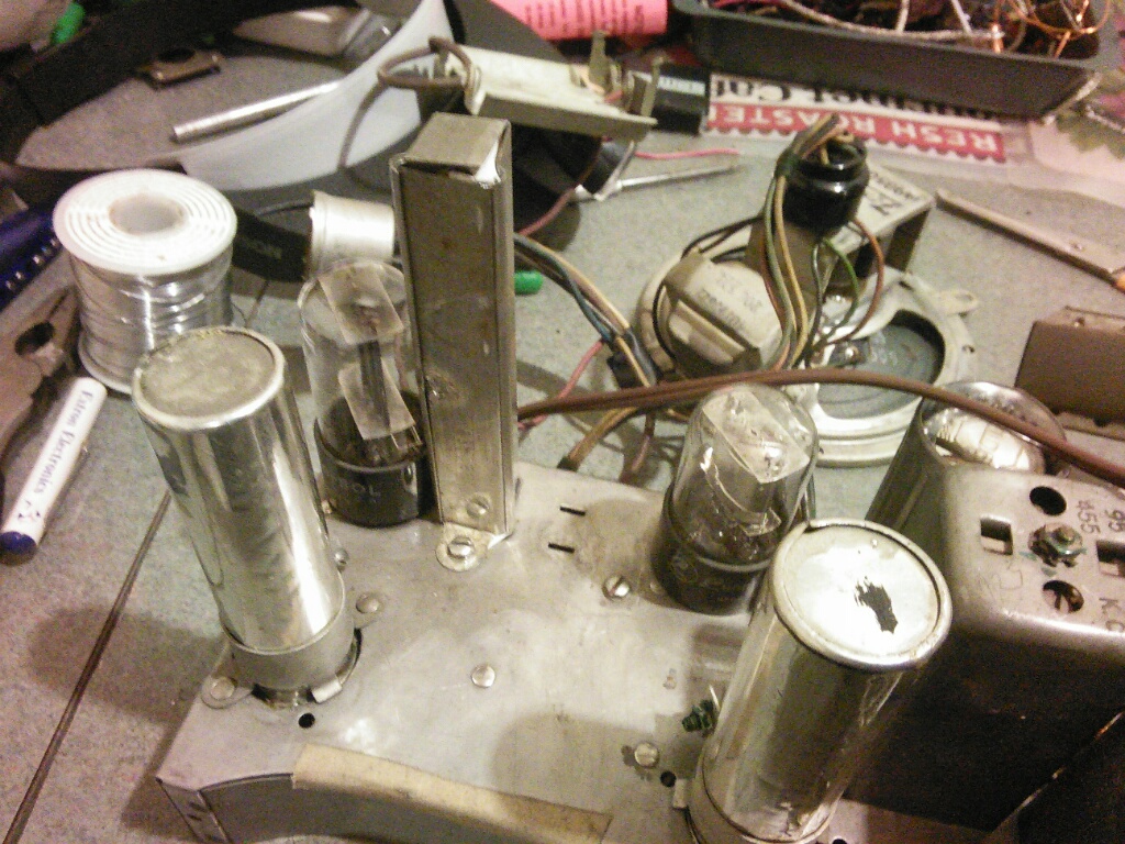

So I restuffed the Candohm. Two 10W 1K resistors.
Like so:
So far so good: no hum, no pops....
The 86 ohm resistor that dissipates mere 1/2W went under the chassis. It isn't hot as it is 5W resistor so isn't dangerous for surrounding wires.
