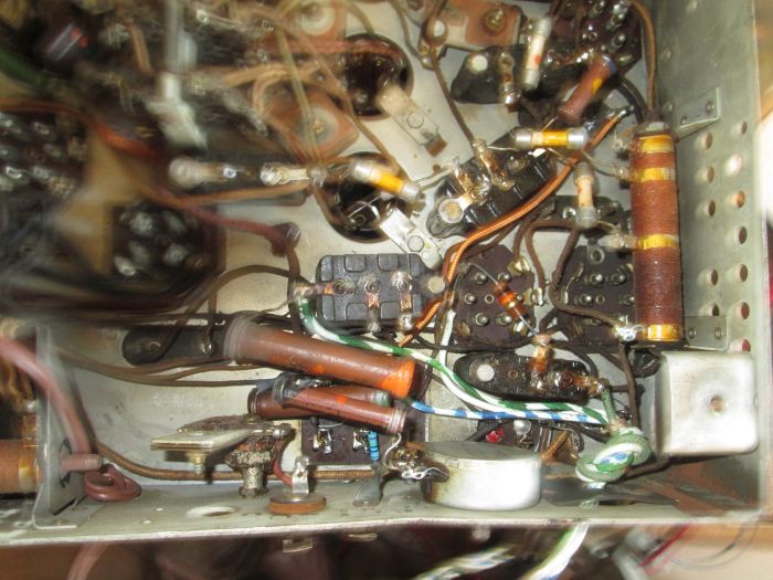

Well I succumbed to the calling of the 16B chassis and it's a head scratcher. It looks like in the library the schematic matches pretty much but the under chassis pictorial is for a later version w/the tone control update. Riders has the later schematic with the later pictorial so think it all matches but doesn't match the early chassis. To make it even more confusing the parts list doesn't give any cap values just the Philco part#. Then you have to enlist the Libary's Bakelite block list to find the proper value. A lot of triangulation to get it sorted.
Have gotten abt 70% of the blocks done and measured some of the resistor and it's not looking good most seem to be more than 20% out. I'll be busy replacing those.

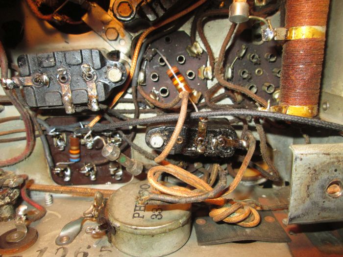

Working on this set makes me really like the 116B and 116X. The 16 is a bit of a job to get at the bank of bypass caps (in the big metal can) and the filter caps. Lot of wires and parts in the way to get to them. Have to take copious notes to get it all back together. It's no Predicta but...
Waiting parts, cloth covered wired, and such before I can continue.
Nutz! the parts came in today so I guess I got to get busy again. Next is the filter caps. It's pretty cramped back there and gotta get the qavc pot and spkr wiring out of the way. Pics later...

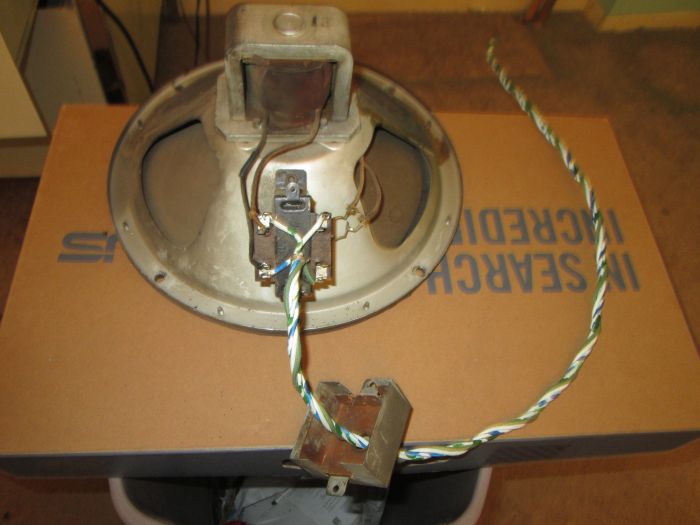

Haven't gotten that far yet. Got the can out and back in but need to get at the filters before I put the big resistors back. Wish Philco had put a spkr plug on this set It's a bit of a nuisance having the spkr tethered to the chassis. I must be getting old all I want to do is complain!
I was wondering myself about the plug.
Cheaper sets have it.
16 is a high end set.

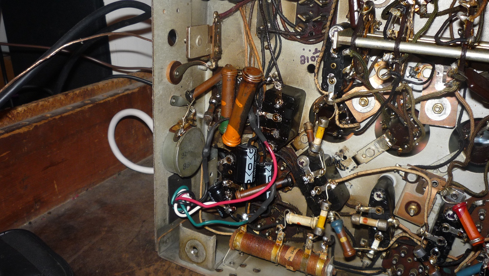

I didnt remove the big can when i changed those inside.  I loosened the bolts, snipped the wires to separate the big can from base, unsoldered a lead or 2 from the resistors to get the base to lift up an inch or more and began to work both sides of the pins with a pencil iron and a LONG pair of needlenose pliers to manipulate the old wires out, then to add the new caps in.. Since my speaker wires were frayed, i clipped em out since the speaker was on a trip to soundremedy anyways. I later went with a 4 wire cable and tucked the caps in as seen in the pic i posted.. But yeah, that surgery was quite a pain in that corner..
Cant wait to see that corner after your upgrade... Icon_thumbup

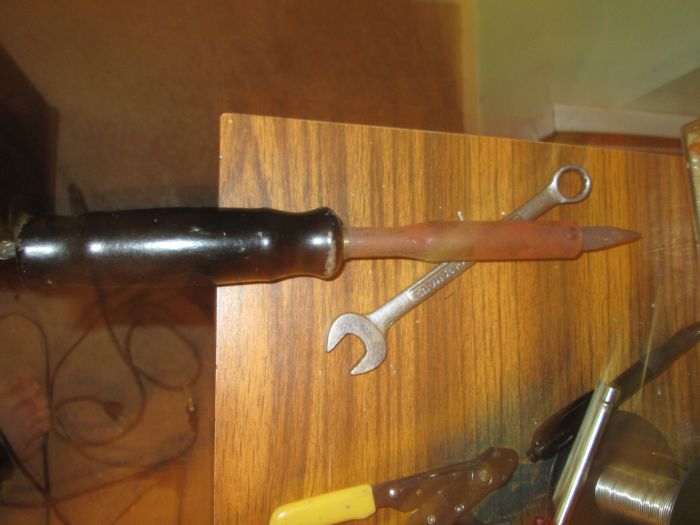

That back corner is a bit tight especiailly when you use a manly soldering iron. It's a little like a flamethrower as it tends to burns up everything in it's path. [Image: https://philcoradio.com/phorum/images/sm...on_eek.gif]
Made up a color correct cable for the spkr and tacked it to the spkr. Gripe #54 don't know why Philco couldn't use the standard RMA color code for these wires. In my mind it makes it simple to follow. The spkr will be taking a trip across the bridge the NJ later but want to get the chassis working before I send it.
Did pull the can apart but used some low capacitance eletrolytics instead of the paper style (mylars to replace) used in the original (ecaps are less expensive). The values aren't particularly critical as they are used for decoupling. The resistor in the power supply were within abt 10% so they are going back in even though modern ones are abt 1/3 the size. If my lower back allows I may give it a try tonight. Can only work on it for abt a hour 1 1/2 at a time before my back gotta sit in the recliner for a while.
I got the spkr wiring sorted and the big resistors so I thought I give her a go. Hook the voltmeter across the hv to detect a short and click it on. Makes abt 300v B+ from the 80 filament to the chassis. Oh and it plays. Still a bunch of things to repair but it does work.
