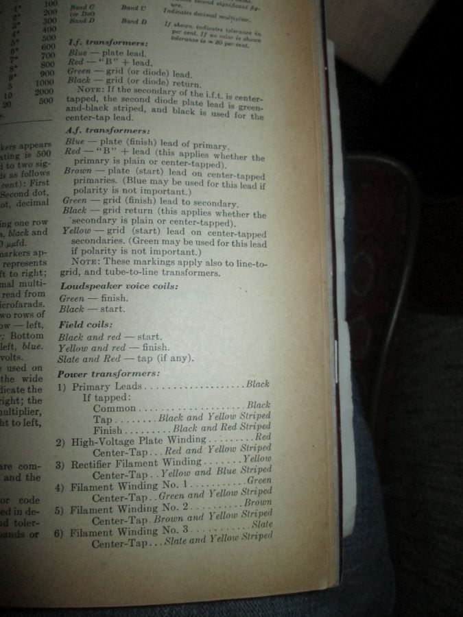

I’m just curious if it matters what color wire you use to rewire? The more that I look at the wiring on my radio, the more bare spots I see and while I could go the easiest route and use shrink tubing over the bare spots or even electrical tape, I don’t want it to look it’s just bandaged up because I didn’t care enough to do it properly when I’m done. So I’ll probably bite the bullet and do a complete rewire or at least partly
The chassis doesn't care but there is the R radio M manufactures A association. They have a standardize color color for most of the wiring. I don't know that Philco abides by it though.
