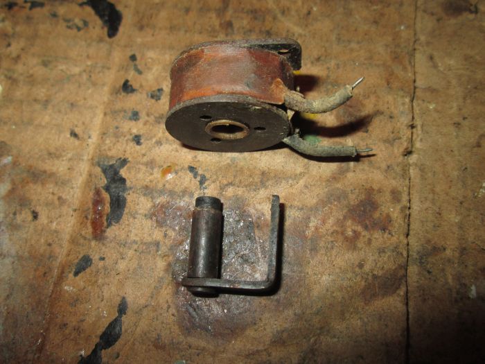

Got busy and rewound the sm coil. Here's a couple of pics. Ohms out @ 1051. 40ga wire = 1 ohm per ft so there's 1,051 ft of wire on that dinky bobbin!
Uh oh! he's done already. Better get those IF cans wrapped up...
Nice Job on the shadow coil Terry!
