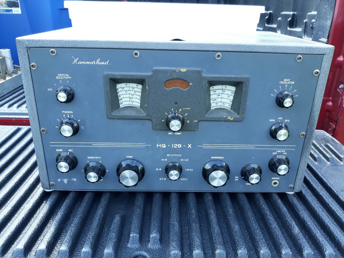

I had an HQ-180 as my goal, but when the opportunity presented itself to purchase an HQ-129-X at Radiofest 2019 (Addison, Illinois) for what I thought was a very reasonable price, I did not hesitate. I brought the HQ-129-X home with me from Radiofest, although it took a side trip to Galena, Illinois and ultimately Clear Lake, Iowa before we headed home.
So...the radio as it looked when I bought it at Radiofest:

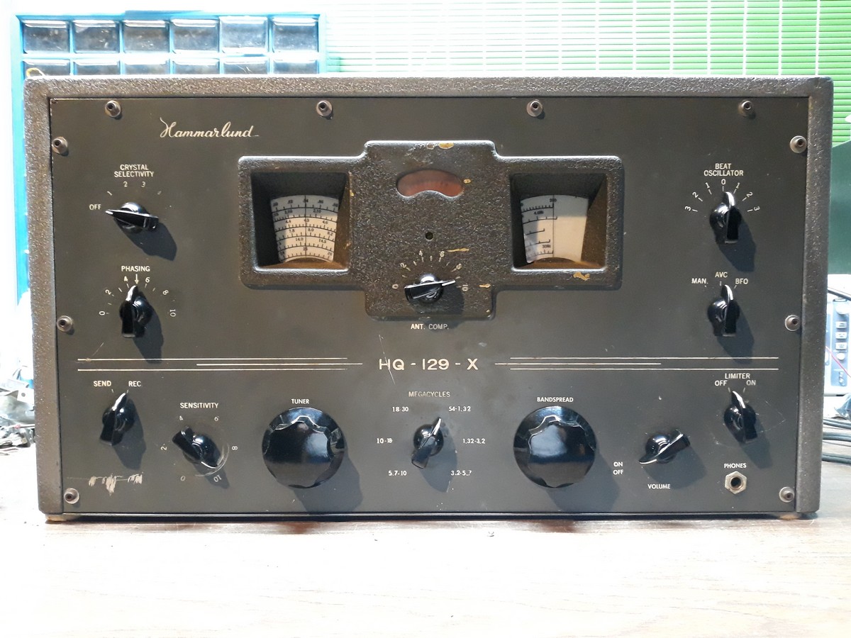

I did not care much for the non-original Dakaware knobs, and soon replaced them with knobs that looked more like the originals - not exactly the same, but closer:
These chicken head knobs have slightly rounded ends, sort of like the original knobs. The tuning and band spread knobs are like those used on the HQ-180 and similar Hammarlund sets, but still better looking than the Dakaware knobs.

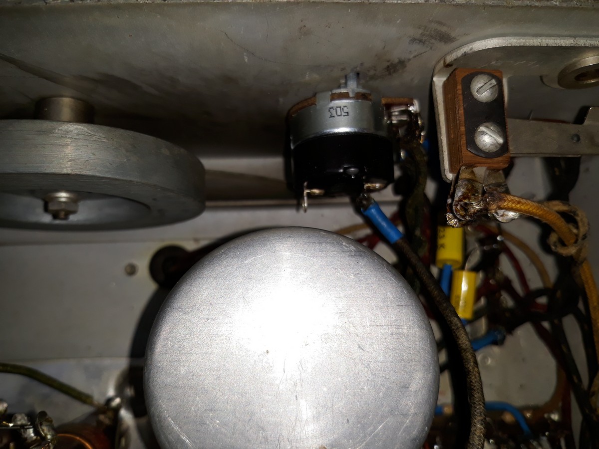

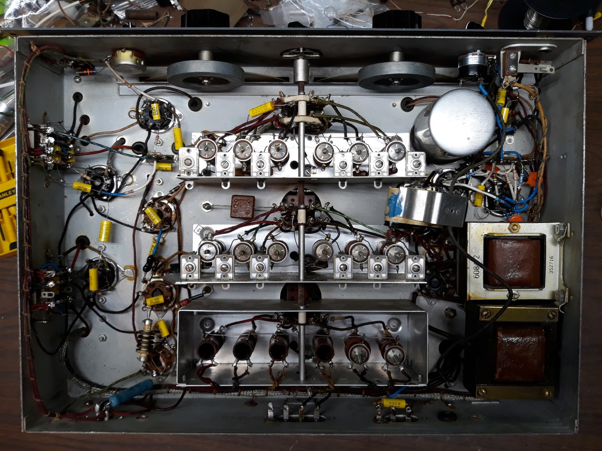

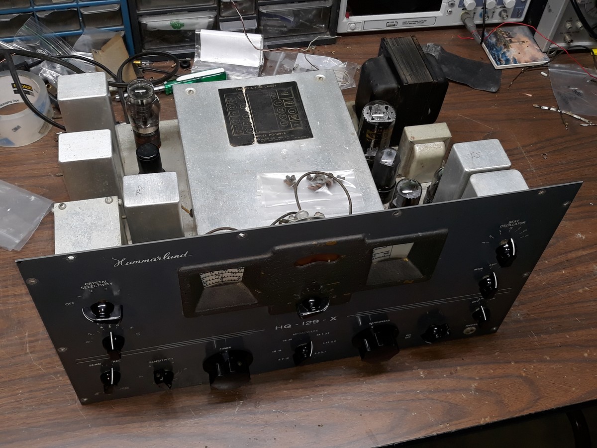

Yesterday, I pulled the chassis out of the cabinet.
Turning it upside down, I wasn't sure what I would find...

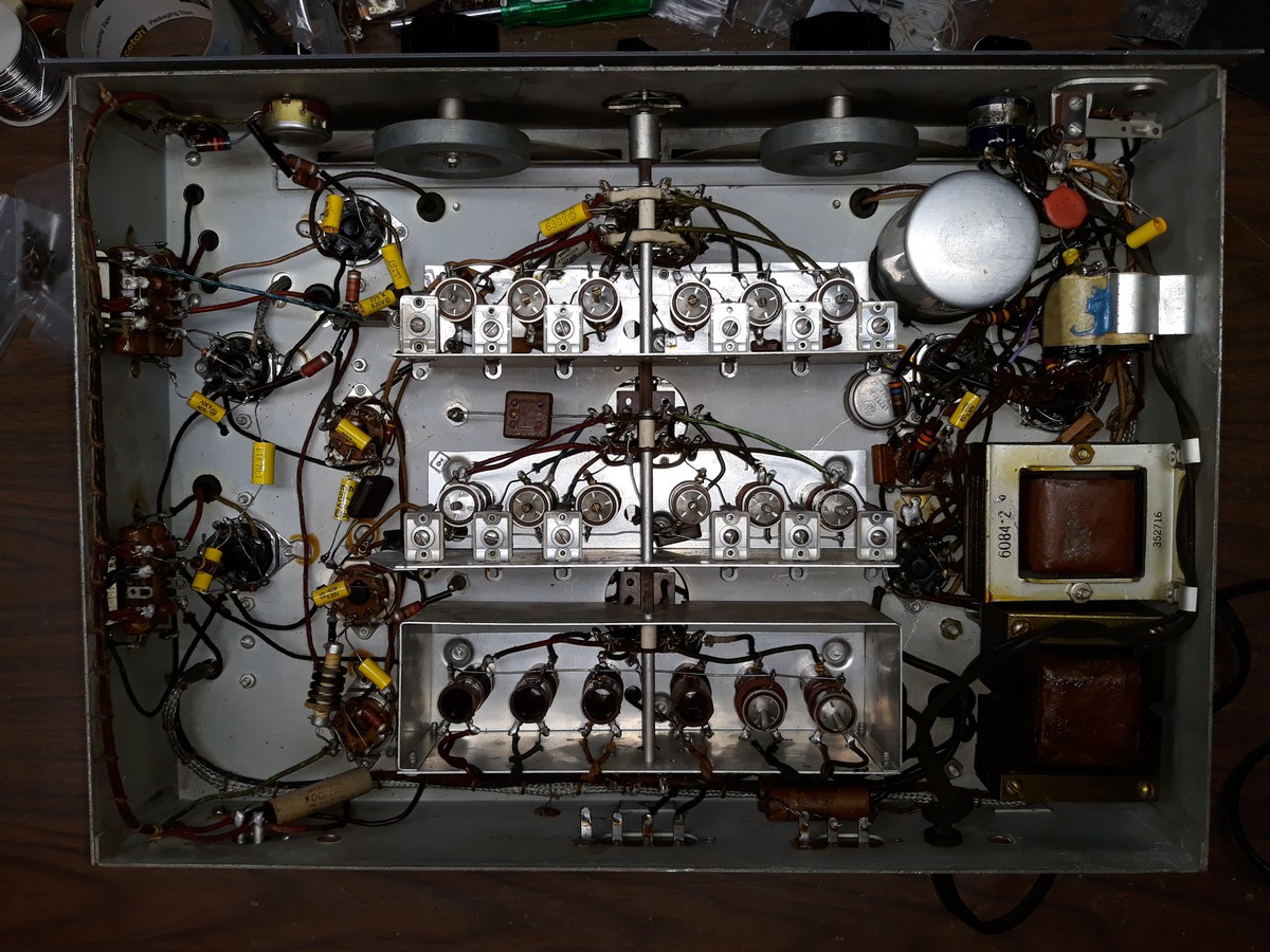

As you can see, most - not all, but most - of the original paper capacitors have been replaced with new yellow film caps. The quality of the cap replacements is not quite to my liking, but I may leave most if not all of them alone.
There are some issues I will need to address, though:

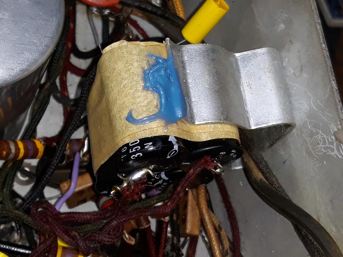

I don't care for how the original twist-lock electrolytic was replaced by individual electrolytics with some masking tape wrapped around them. These will be replaced with another twist-lock unit. I considered buying a new twist-lock from AES, but have since decided to open up a twist-lock from the junkpile and restuff it with new Nichicon electrolytics.

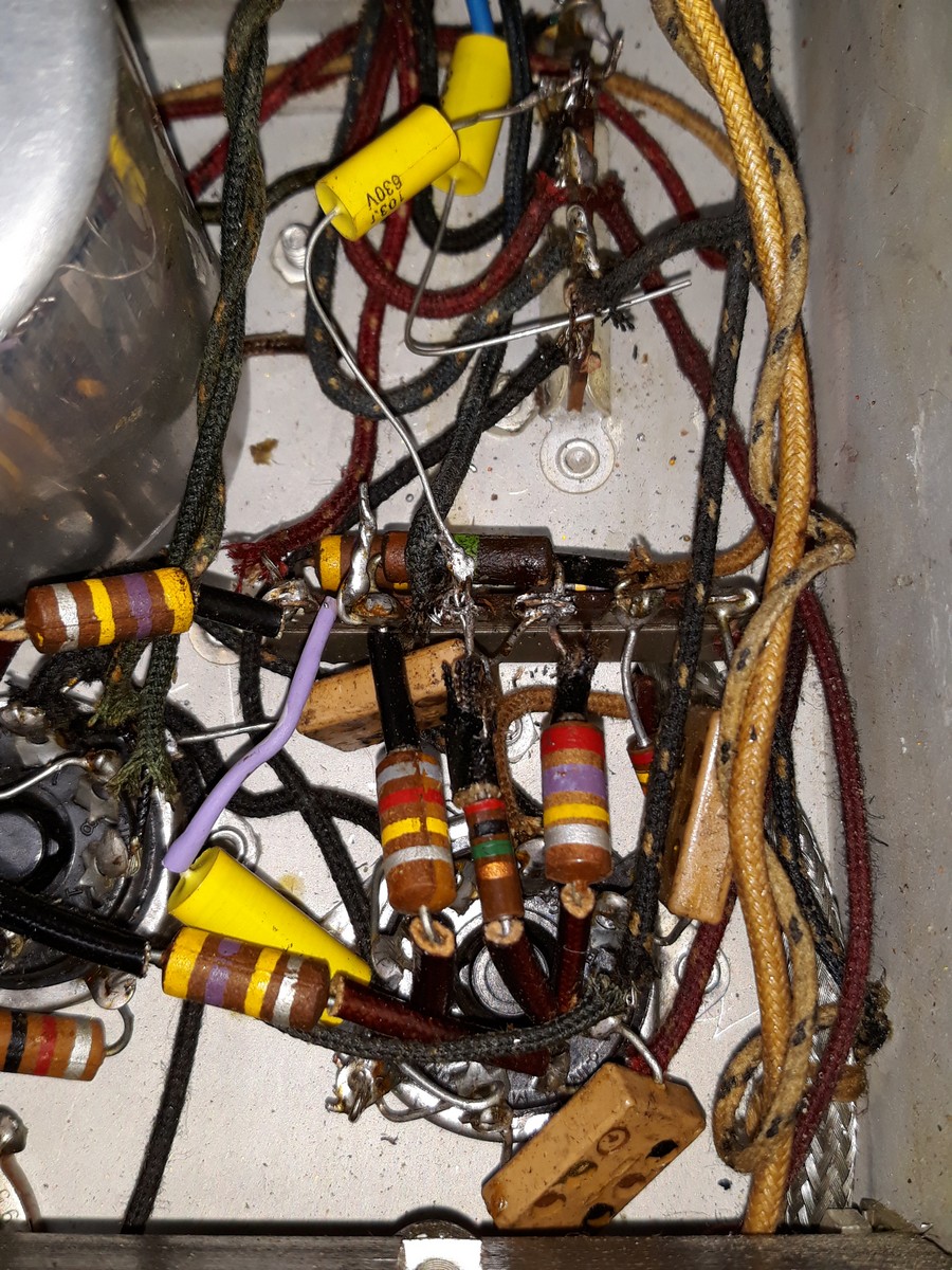

Left side of chassis, looking at the bottom: No less than seven original paper capacitors which were not replaced. I will replace them. Since the vast majority of capacitors were replaced with yellow film and the originals discarded, I will not restuff these either.

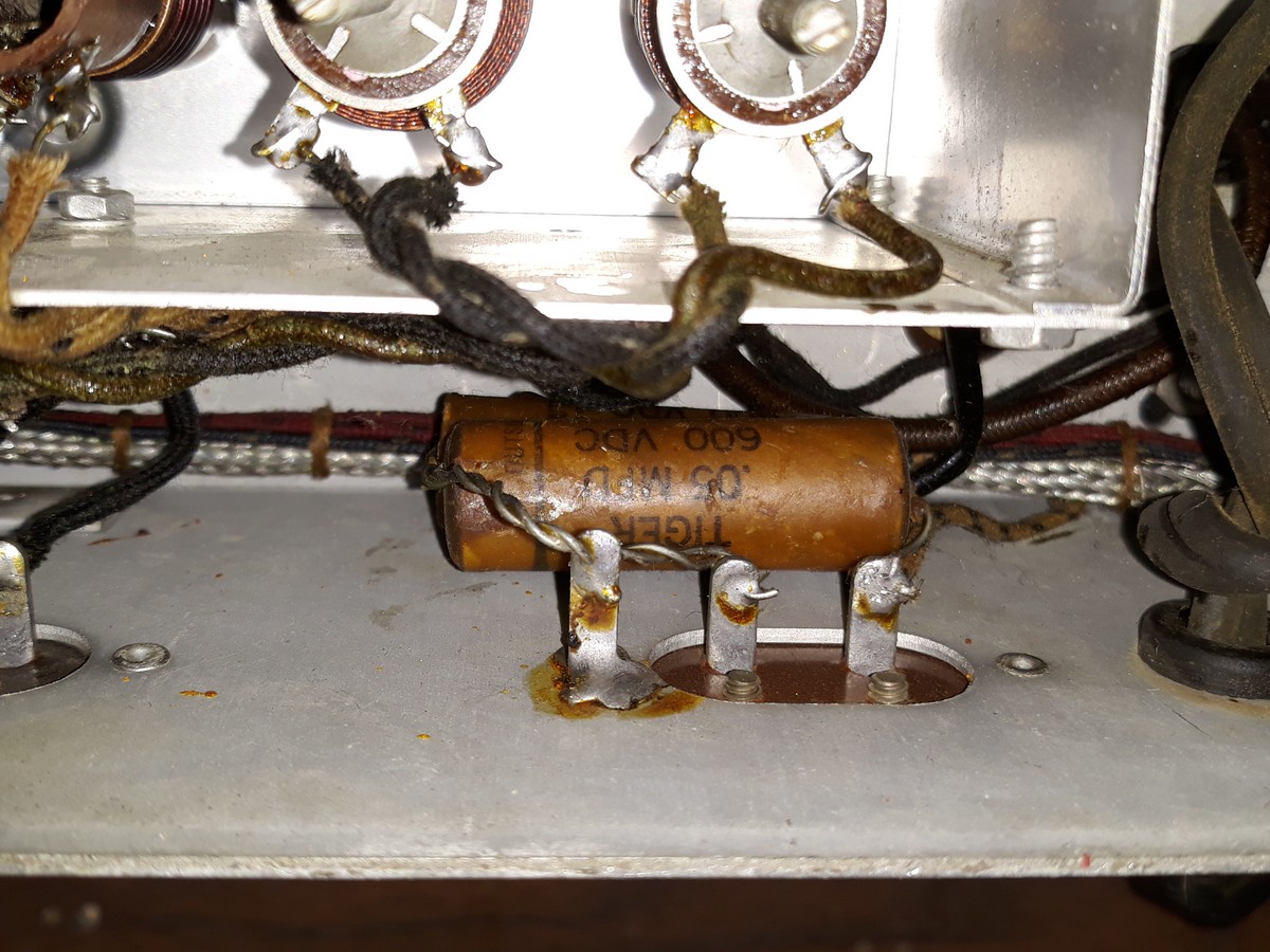

Back of chassis under speaker terminals: Two more original paper capacitors. One of those, .05 uF, is connected between one side of the line and ground!  It will be replaced with a new .01 uF X-Y safety cap. The other will be replaced with a new .047 uF yellow film capacitor.
Additionally, I noticed that R54, which is supposed to be 4K at 5 watts, was replaced with a 10K, 10W unit. That will reduce the B+ to the screen grids of the front end tubes as well as the first and second IF amplifiers. It will be replaced with a new 4K, 10 watt resistor which I just happen to have on hand.
Also, it appears to have its original rubber power cord which is cracking. It will receive a brand new black power cord.
All of the tubes are good save two: the 6K8GT which is marginal, and the 0C3 voltage regulator tube which my tester won't test. Its base is very loose so I'll just replace it anyway.

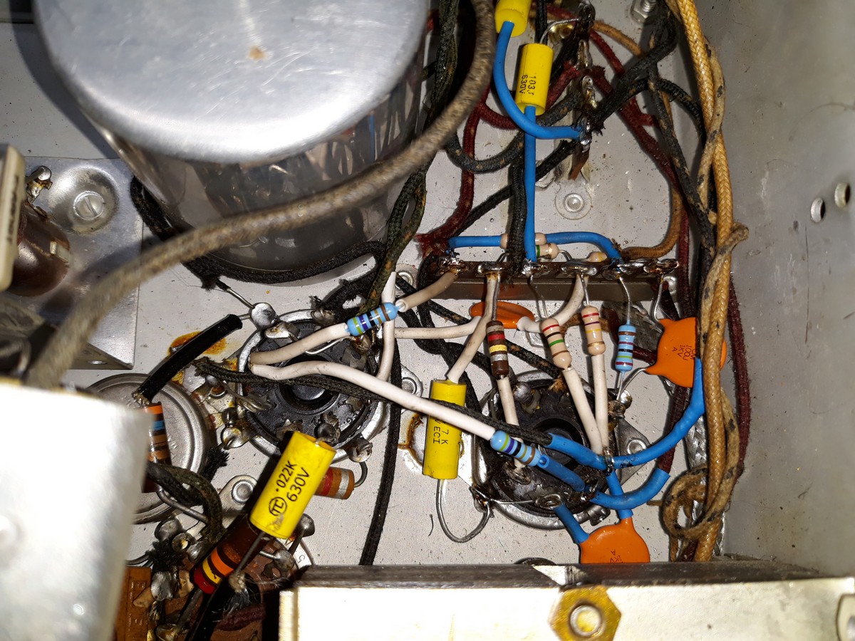

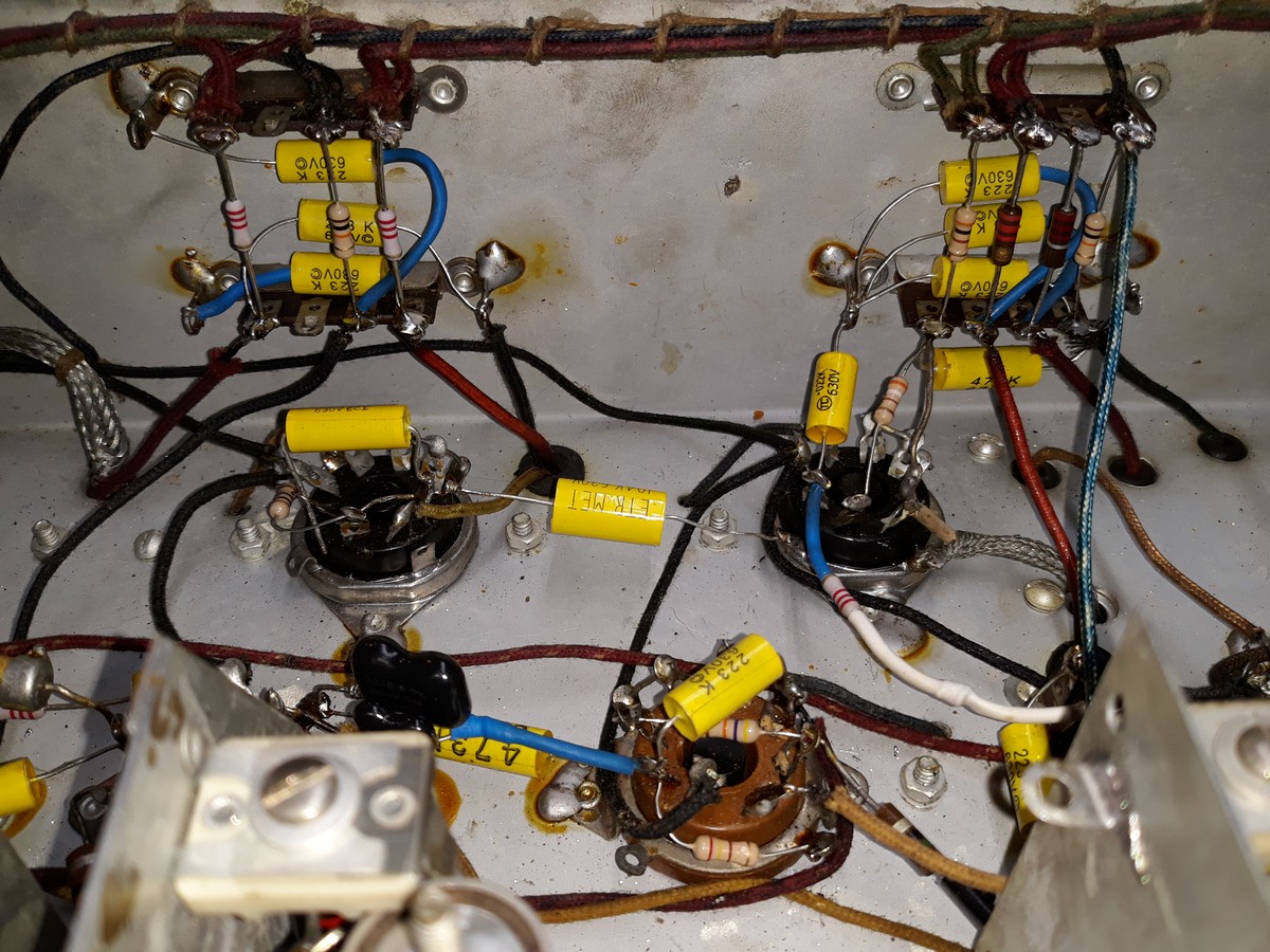

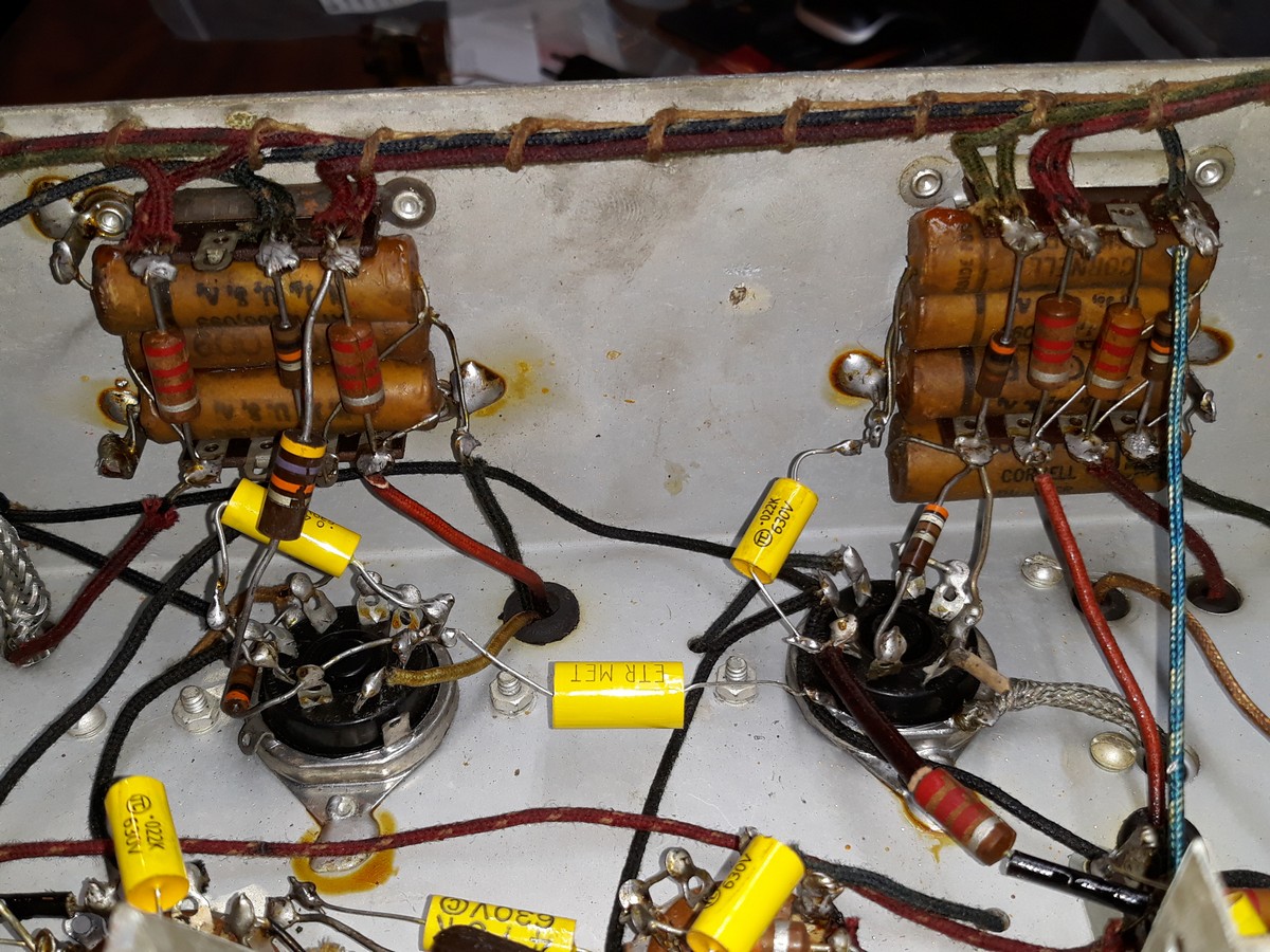

I've removed and reattached most of the yellow film caps now, and have tried to do a neater job. I have also replaced most of the resistors.
New caps replacing old:
more...

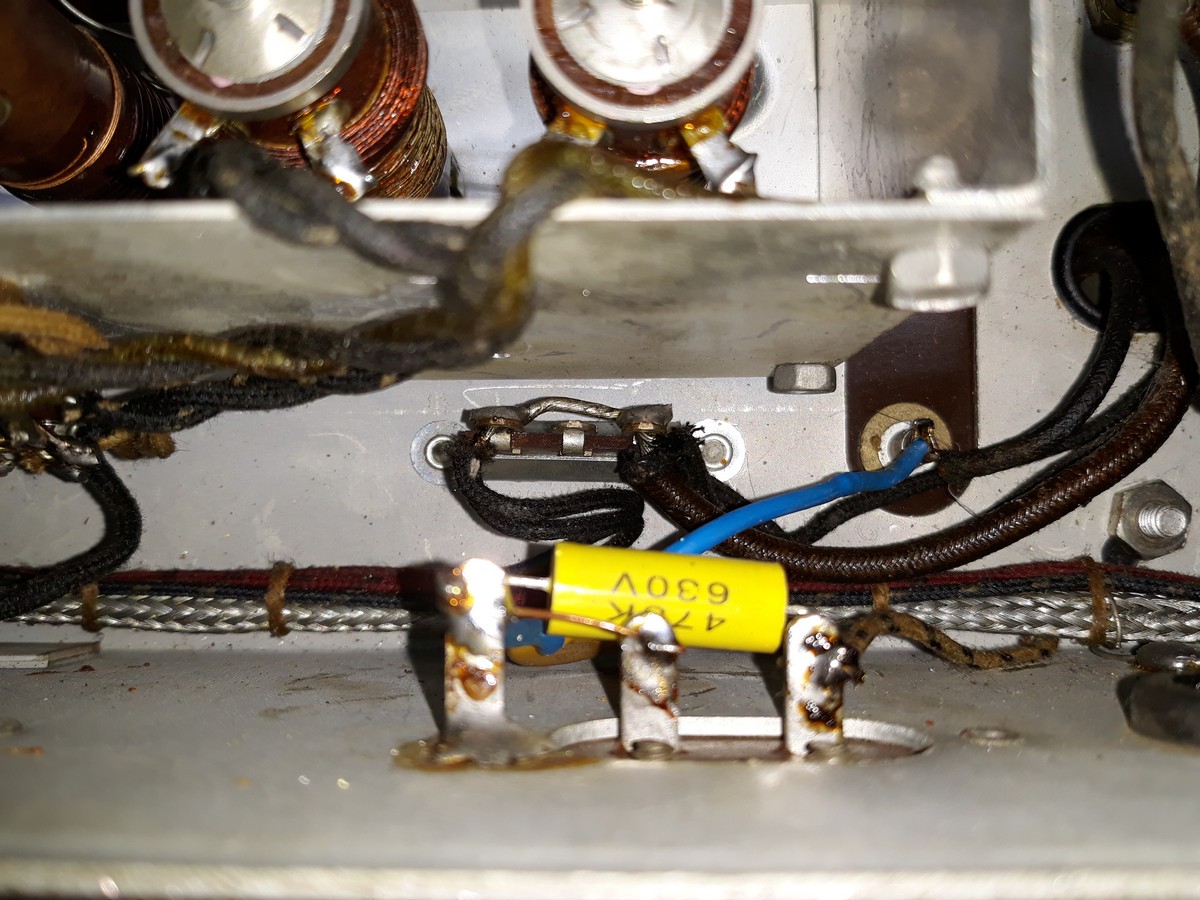

At the 6H6 (2nd detector) tube socket.
Before:
After (by the way, the ceramic discs are 100 pF, NP0):
New volume control with power switch, 250K, audio taper:

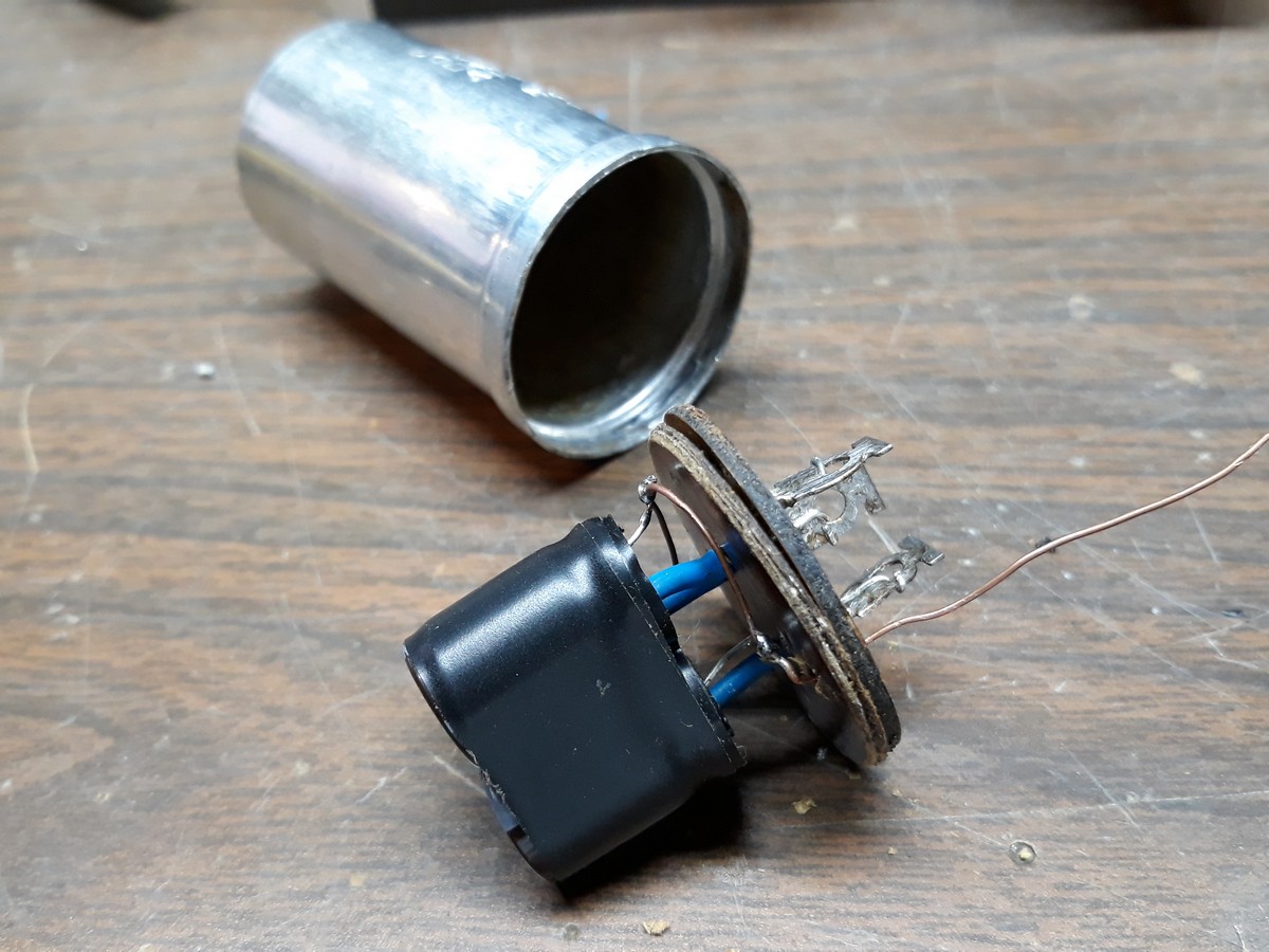

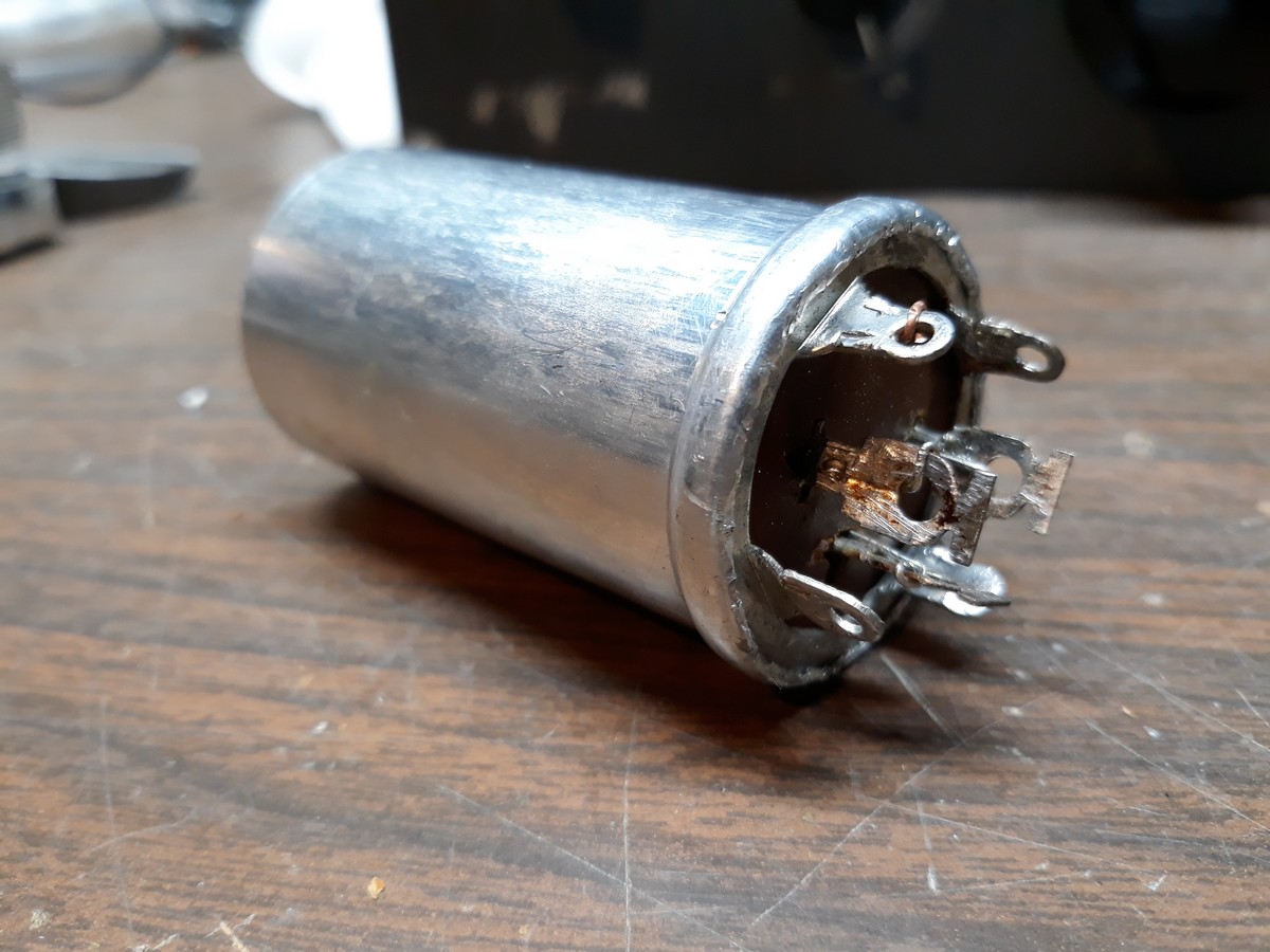

Thursday evening, I returned to the workbench and decided to prepare an old twist-lock capacitor I had found in the junkbox.
I cut off the aluminum at the bottom end and carefully disassembled the unit.
Then I installed three new Nichicon 10 uF, 500V electrolytics I had bought just for this purpose.
Soon, I had it all together again:
All restuffed, reassembled and ready to go where the original electrolytic once was mounted. The original was a four section unit, also containing a 20 uF, 25V electrolytic. Since the twist-lock electrolytic can I found only has three terminals, I will install a new 20 uF electrolytic direct between the output tube cathode and ground.
