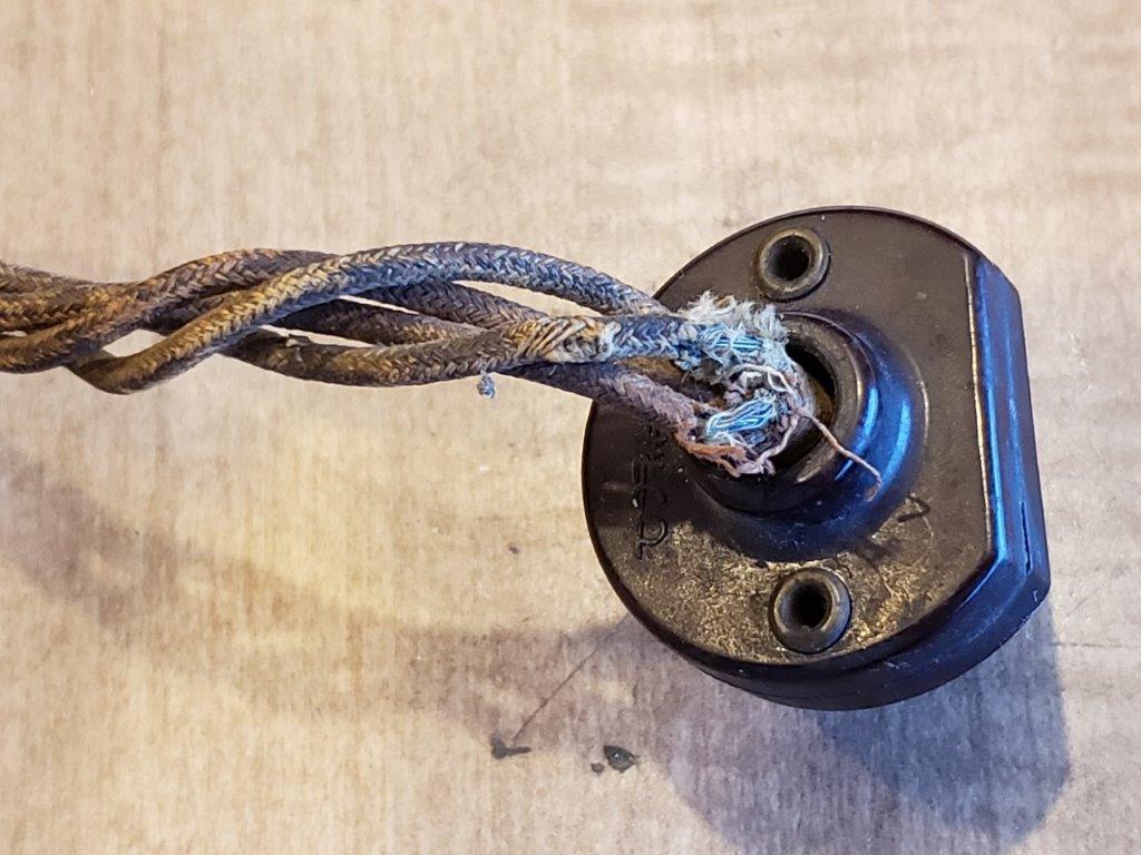

Well, the potentiometer checks out- I disconnected ground and got the variable 5K ohms, reconnected and it plays now- I don't have the 3 'compensating capacitors' adjusted correctly yet (is there a trick to that?), plus my workspace is very RF noisy and don't have a ground hooked up. I need to try driving a ground rod.
Is there a way to fix the frayed speaker wires at the plug without tearing into the plug and replacing all the wire? blob of epoxy?
Thanks,
Simon
Now having some prior experience with these, I would try to, after cleaning the frayed insulation, push the wire through the pins (while heating the pins with soldering iron). If it comes through.

Given the "crispiness" of the rubber under the cloth, it will break everytime the wire is flexed. Are you sure you don't need to replace the wire?
Which would be my recommendation also.
I usually replace the whole thing, even though the brittleness will not lead to shorts, but hearing that crispy crackling sound when disturbing wires make me want to replace it.
This said, if one is bent on preserving the original, it is possible.

Excellent, Steve; I tried to heat up and push through but wires must be kinked in there...now;
where to buy that cloth covered wire?
I fixed the fraying temporarily with electrical tape and checked for shorts, but want to do it right eventually.
EDIT: I think I will email sundialwire with my requirement and see what happens....
