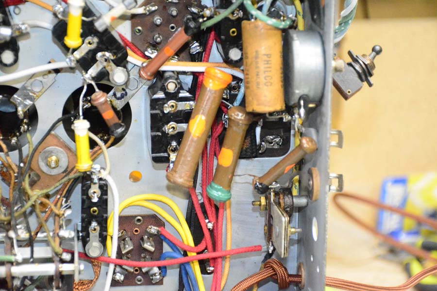

Decided to try my hand at molding resistors. They kind of look original...if you don't look to closely.
Unless one is an expert and uses a magnifying glass......great job! Looks as original as ever. (Well, Russ or Steve might notice something  but not me )
Have you used plastic or epoxy/filler mold?
Fine job, Rob. Fine job.

I made the mold in epoxy resin and the resistors are epoxy putty. I won't do it that way again. The epoxy mold makes it too difficult to get the original parts out even with a lot of mold release. I'll buy some of the silicone rubber molding compound that Russ uses and recommends. A tiny bit of flexibility would help greatly in removing parts.
Only the 3 larger ones are redone. The rest are original with a hidden, parallel resistor underneath.
(This post was last modified: 10-01-2019, 10:56 AM by rfeenstra.)
That's what I recently started doing: hide a smaller resistor to parallel the original to bring the resistance within tolerance limits.
Posts: 1,222
Threads: 50
Joined: Oct 2017
City: Allendale, MI
That works for the smaller dogbones. They all seem to go up in value. As you mentioned before, the large ones seem to go down in value. Replacement is the only reasonable way to get it into spec. I have tried to hide a series resistor but it doesn't work well as far as the installation is concerned. I did do that on my 45C. Probably won't again now that I know I can do this.
ON my recently finished 45C I did both. Yes, with the large resistors I had to use the modern types as they went down quite a bit. I could serialize of course but then serialization does not lend itself to hiding as well as paralleling does.

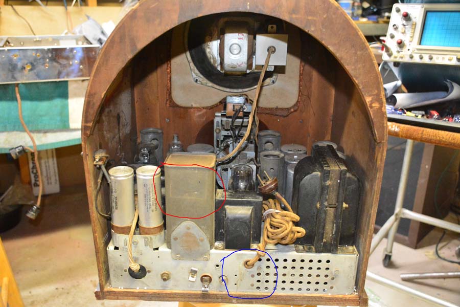

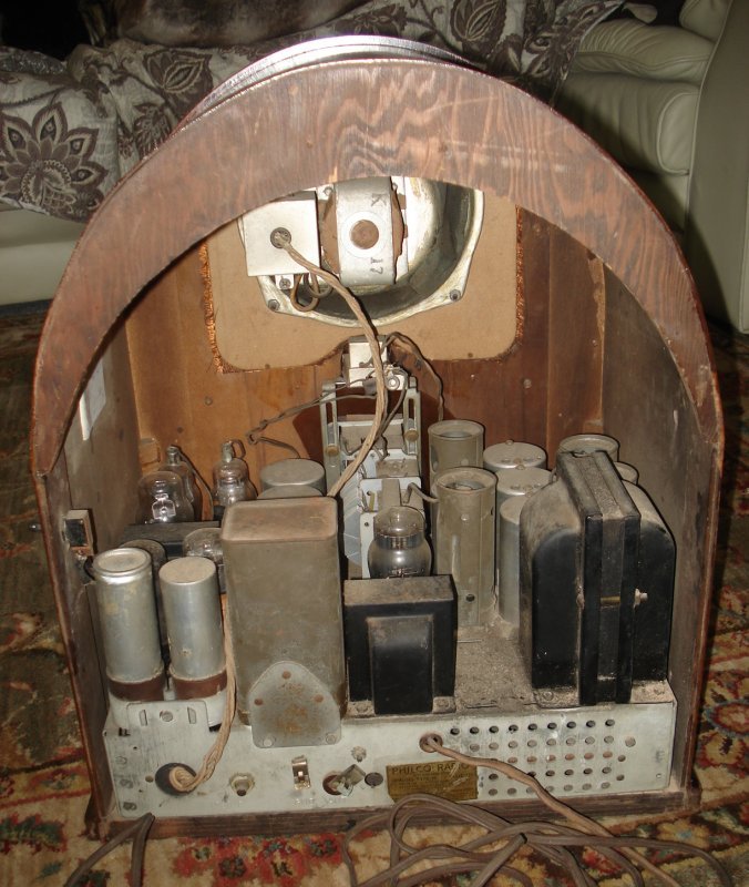

I'm looking to finish this electronic restoration up. There were 2 labels on the back of the radio that were gone when I got the radio. I presume the area circled in blue is where the gold, model label was located. What might have been on the capacitor can? Did Philco put something there, or was it, perhaps, another sticker from the repair company in maine? Also, there was something on the top of the capacitor can. It looked like it may have been another sticker. Perhaps a part number sticker? Thanks!

Posts: 178
Threads: 19
Joined: Feb 2014
City: The Motor City,Detroit MI
Mine has no sticker, maybe there is a ghost of a sticker.
(This post was last modified: 10-02-2019, 12:18 PM by Kestas.)
Posts: 1,222
Threads: 50
Joined: Oct 2017
City: Allendale, MI
Thank you. I suspect it was from the repair shop.

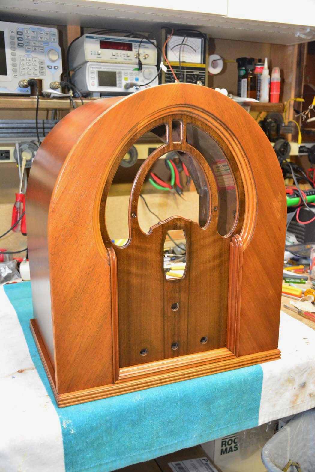

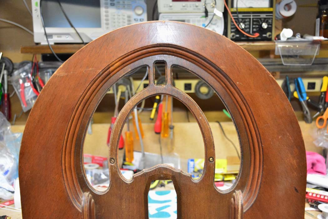

I decided to complete this radio so I started the refinishing process. I could start a thread in the finish section but it made sense to me to keep it all together.
The cabinet has been stripped and now has 2 coats of Mohawk EZ Vinyl sealer. Next will be filler, than sanding sealer and finally, semi gloss lacquer.

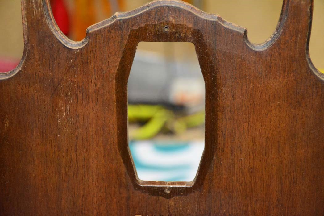

Questions on toner colors. I'll use walnut brown grain filler even though the wood is, I believe, some form of mahogany. You can see how dark the finish was under the escutcheon. What toner would you recommend for the inset?

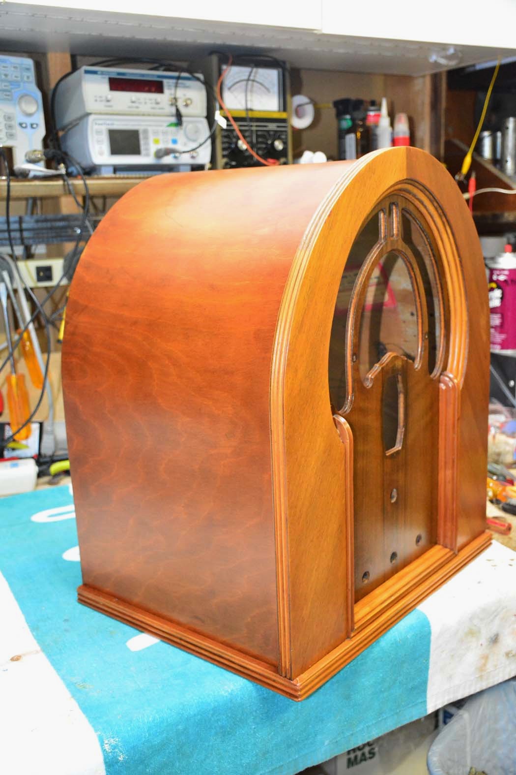

The surrounding wood was fairly red. Toner recommendation? The trim pieces were not a lot darker than the surrounding wood. I may darken it ever so slightly more than the surrounding wood to help hide the end grain at the top and the joint.

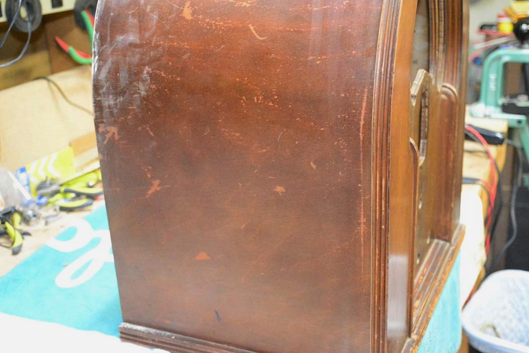

The sides were quite dark and red. A suggestion for toner?
Thank you in advance for your recommendations!
Posts: 7,323
Threads: 270
City: Roslyn Pa
I tend to stay away from the mahogany to me it too red and you loose the yellow quickly. If you like it just a little on the caramel side of things I stick w/ the walnut and sometimes I add a little yellow by using pine ( I think look @ the color chart ).
ymmv
