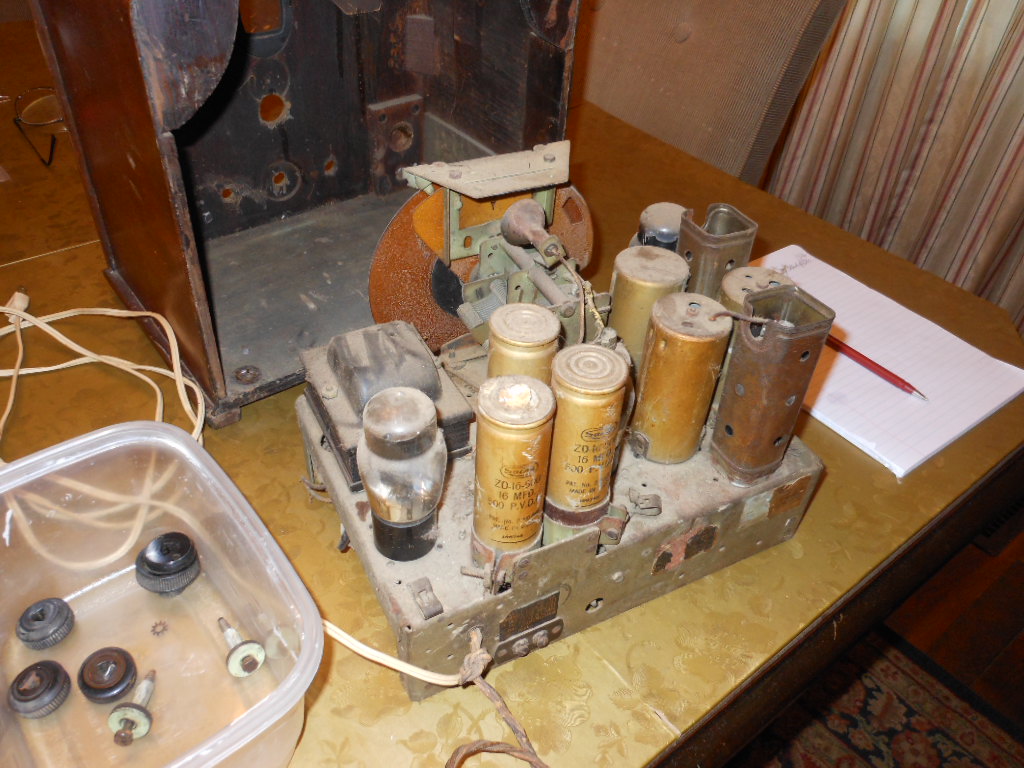

First stone wall : I 've removed the knobs and the 2 screws from the bottom ( with those sleeves and rubber washers),  but the chassis  isn't wanting to come out. It's moving slightly, but I better ask if there is something else that someone knows about, that I need to remove , before applying too much force to get it to slide out. Icon_question
The front of the chassis has some posts that fit into rubber washers on the front panel.  here are a couple photos.  I suspect the rubber has hardened and is holding the chassis in.
[Image: https://www.dropbox.com/s/jxfobgi9ofzkjq....jpg?raw=1]
[Image: https://www.dropbox.com/s/71sp0wtamzerah....jpg?raw=1]
"The front of the chassis has some posts that fit into rubber washers on the front panel."
WHOA!!!   ONE picture, . . . a thousand words!   Thank you!
Interesting that Phlico indexed the cabinet to locate the chassis, or was there some other reason?
It was to dampen vibration to the chassis. At the back of some of the chassis's they have square gum rubber mounts at the corners. Sorted floating it on rubber. If the front ones are bad the shafts and dial won't set in there proper positions.
Got it!
Icon_thumbup

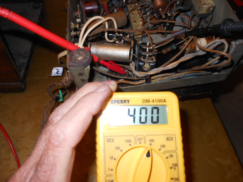

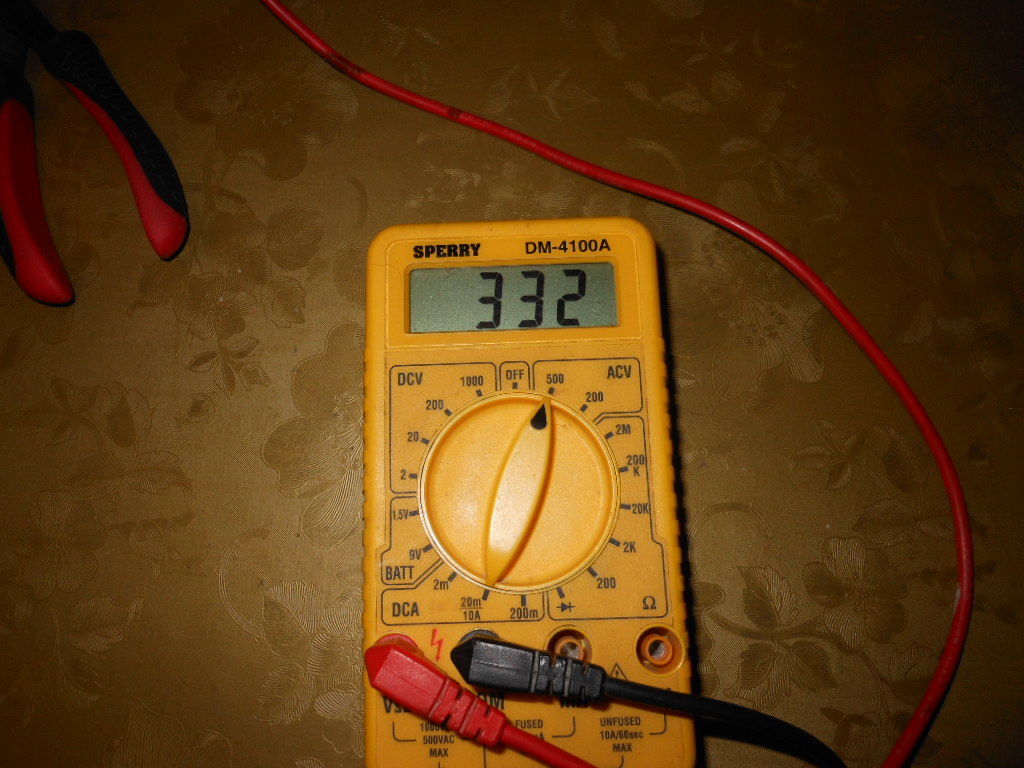

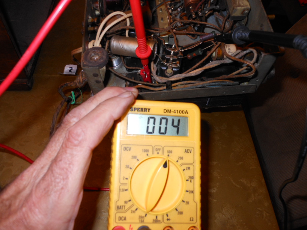

I've done some power transformer voltage measurements :
One side of the high voltage secondary measures 400 volts,
the other side seems to have the 4 in the wrong decimal place Icon_mad ,
and the rectifier filament voltage is just 332 volts. Icon_twisted
I measured  continuity of the rectifier filament and there is none, verifying the worse...a shorted power transformer.  At least now, I don't have to 2nd-guess whether I damaged it after I got it, (re-insulating the leads, like what happened with the 39-6CI.)
So, for now, back in the cabinet the chassis goes,  until I start shopping for another (2nd) power transformer (unless I decide to take on re-winding both of them).  But , at least I satisfied my Kirk-inspired curiosity. Icon_rolleyes
Hi Jake
You kinda lost me. Are you saying that without the rectifier tube in place measuring the AC voltage from the 80's socket skinny pins you got 400vac? If you measure the AC voltage across the two fat pins what do you get?
Or another way is to measure the resistance from the wire that goes to #70 to the transformer against each of the skinny pins of the 80 socket. Should show several hundred ohms and be fair close in resistance like 100 ohms or so.
GL
"You kinda lost me.. . ."
Yes Terry, . . . I had ALL the tubes removed...I looked up on the tube manual just as you said  ( about the 2 skinny pins being the HV connections), but my meter doesn't go high enough to measure the full HV amount...I thought it safer to  just measure the two halves ; from one skinny pin to the center tap, then from the other skinny pin to the center tap.  On one I get 400, on the other I get 4.  The kicker was measuring the voltage across the two fatter pins : 332 volts!  What is it supposed to be?...like 5?

"So there is no 5 volts for the filament of the rectifier..."
I know this sounds like I may have just gotten my connections mixed up, Chas, . . . but I measured 332 volts for the filament voltage.  I'd like to think the 4 volts I measured was the filament , and the 332 was the other half of the high voltage winding, . . . . but I don't think I mixed it up.  ;-(    And I did measure no continuity across the filament pins of the rectifier tube, .....surely  that 332 volts cooked it.   Icon_sad
But I'm beginning to  feel I should start all over again.
I can’t think of a transformer failure mode that  would give over 300 volts across a 5 volt winding.

"I can’t think of a transformer failure mode that  would give over 300 volts across a 5 volt winding.'
Yea,  it seems odd.
I guess I better do all my measurements over.   But the tube filament continuity measurement was pretty simple.  It's open , whether that 332 volts is correct for the filament voltage or not.
