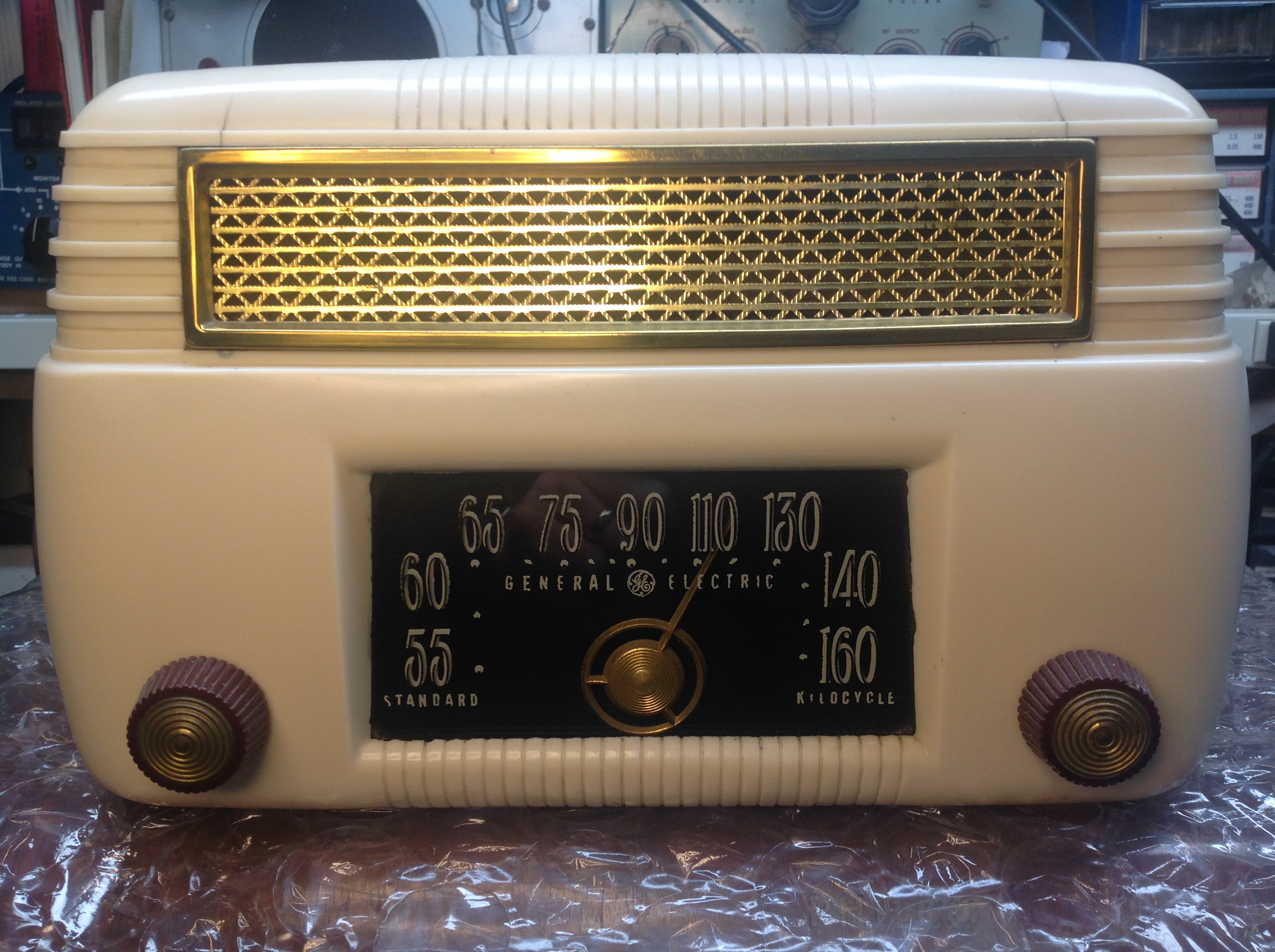

I decided to have one of my flea market finds from the summer recapped and chose the nice little General Electric model 202 bakelite I found for $20-$25 at Hartville Flea Market. Radio came out great and sounds good as well. That sixth tube does seem to make a difference in the performance as I think it is an extra RF tube like the beater Philco 42-322 I used to play with. Odd little chassis that uses a nightlight bulb as a dial light! Icon_lol

I actually pulled a dead, gold satin Christmas tree bulb from the 60's out of this GE when I found it. I currently have a 4 watt C7 bulb in it as that was all I could find locally. Figure it will burn cooler. Sadly, someone wiped most of the black shadowing off the front of the dial glass sometime in the past. The white numbers are fully intact though. I pondered an LED bulb, but wondered about interference with the radio. It has enough to deal with in the house!
Since I don't think I ever posted it here, a quick picture I just took of the radio while listening to it right now:
