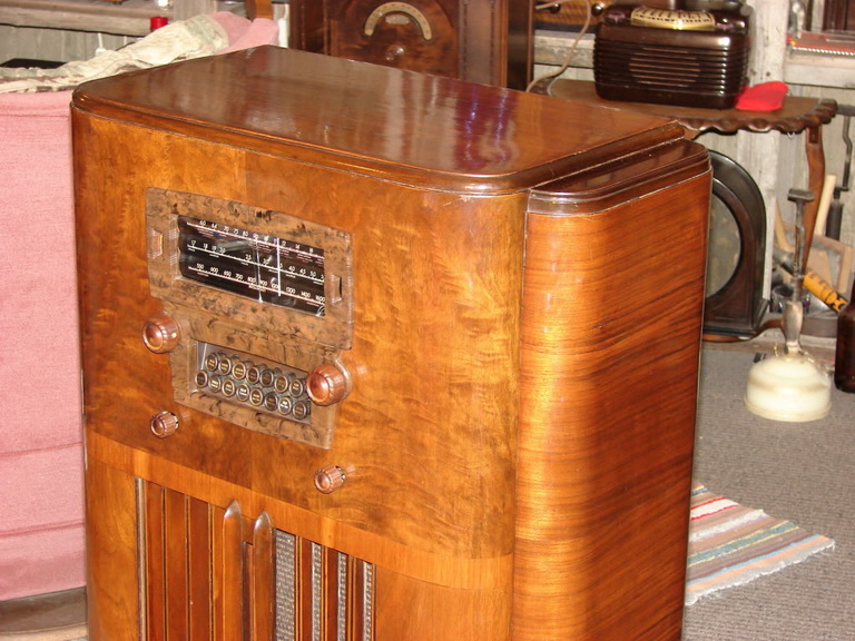

Hello fella's,
Wondering if anyone can tell me how the manual/electric tuning control is supposed to work on this radio?
It is the R184 chassis, and it has a large brass outer portion which is pushed in for electric and pulled out for manual tuning.
But when you pull it out it ends up completely covering the inner 1/4 inch shaft that has the flat on it.
Hoping someone here has one and can fill me in on the operation of this control.
Looks like quite an elaborate mechanism.
