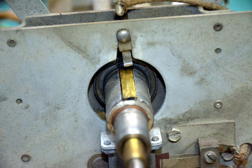

As I mentioned in another thread, there is a piece of the auto tune that is missing.  The contact that kills the audio when the auto tune is engaged is missing.  I guess I'll have to try and make one.

Now to tackle the AutoTune assembly.  I need to repair or replace both shadow masks.  The dial is ok but I have a new one coming in case I break the original.  It is very brittle.  As I did with my 37-116, I may play with the AutoTune lighting of the station tabs.  On my 37-116, it was very dim even though 4 lamps attempt to light it.  The 38-116 has only 2.  Plus, the polished reflector ring is broken and I don't know if I can repair it.
The radio has been playing all day. No problems as yet.  I've finished most of the autotune system except for the audio killing switch.  I'll need to "borrow" that from my 38-2.   Next I'll do a realignment. The cabinet is ready to rub out for its final finish, then I can install the radio and be done.  It seems to be an excellent performer. as is its older sibling, the 37-116.
