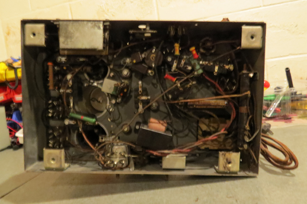

The chassis:
Now, here is the basement:

Today I somewhat cleaned the top to the extent I aleays do: removal of the grime and applying naval jelly to a few rust spots. I don't paint chassis though I admire those who do.
Then I started on restuffing the backelite caps.
I found out both chassis have an extra block not shown in any bottom diagram, so I went by Ray Bintliff's book. I figured the cap is the one across the filter choke, and Ray's book does not list this cap: it lists same number in about 40 varieties but mine is without letters at the end. Anyhow, all of them are 0.09uF which is what I put in.
The blocks have a kind of tar in them that leaks easily and smears the bottom which I then have to wipe.
